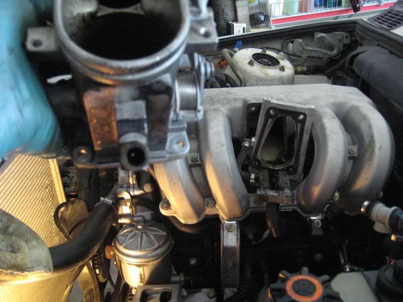

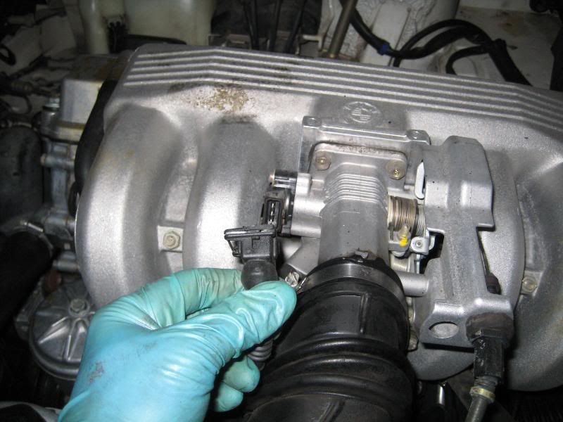

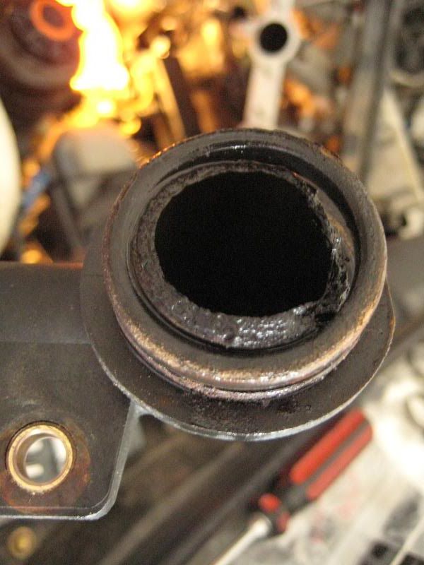

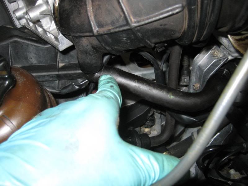

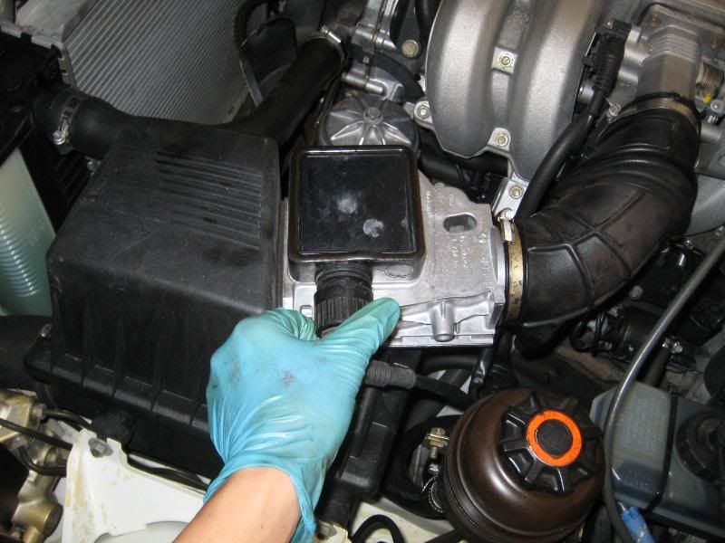

Unplug, undo clamps that hold airbox to throttle housing
Air hose that attaches to bottom of rubber boot
Just taking note of where all the hoses go

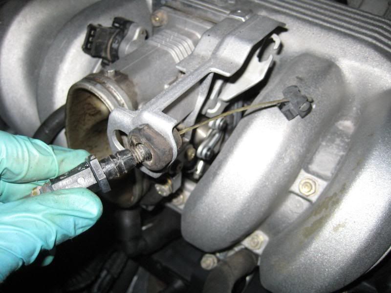

Take off the throttle cable.  You need to be careful since the rubber is hard and brittle.
Air hose

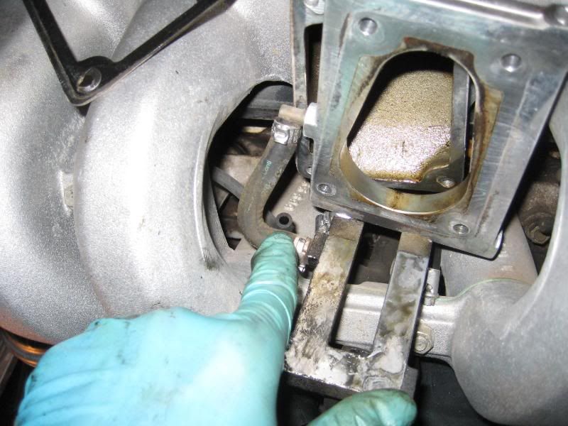

Theres a C shaped bracket under the opening of the throttle assembly that needs to be unbolted to access the 4 nuts that attach the throttle assembly to the intake manifold
Undo the 4 nuts that hold the throttle body housing to the intake manifold.  you need a 10 mm long socket.
Need to replace the 2 throttle body gaskets
air hose goes
here

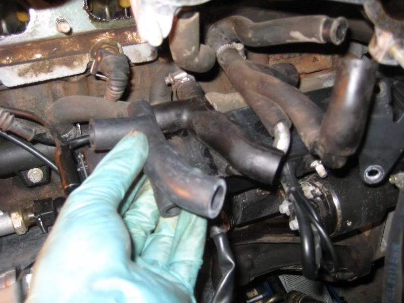

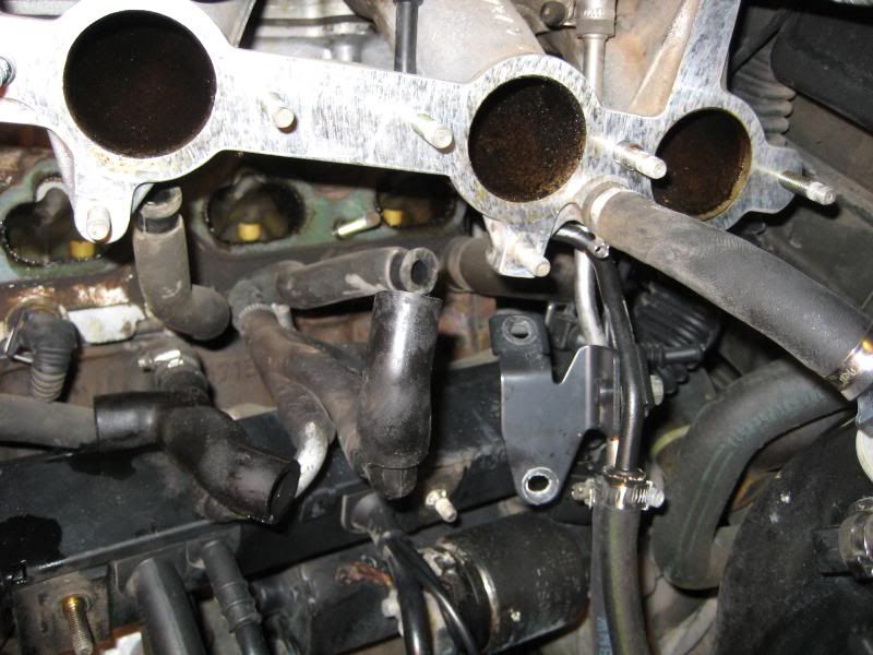

Once you undo the coolant hoses on throttle warmer?  Get ready for more coolant flow from the drain plug

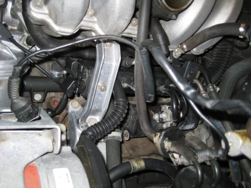

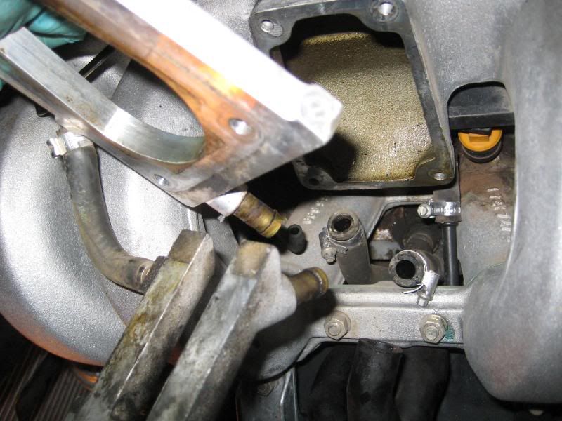

Now remove the intake manifold.  They are held in place by 11mm nuts!  So you need a long 11mm socket.  Also there is a bracket on each end of the intake manifold that holds it inplace.  Sorry no pics
Also this bracket

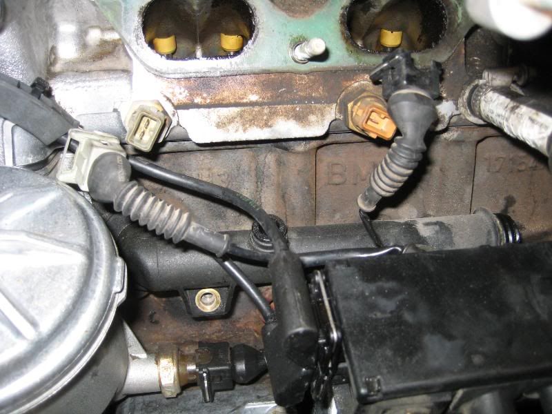

After the intake manifold is out, you need to take out the lower portion of the manifold.  there are 5 nuts.  Here I already loosened it and moved it out of the way.
Now the coast is clear to reach all the cooling pipes

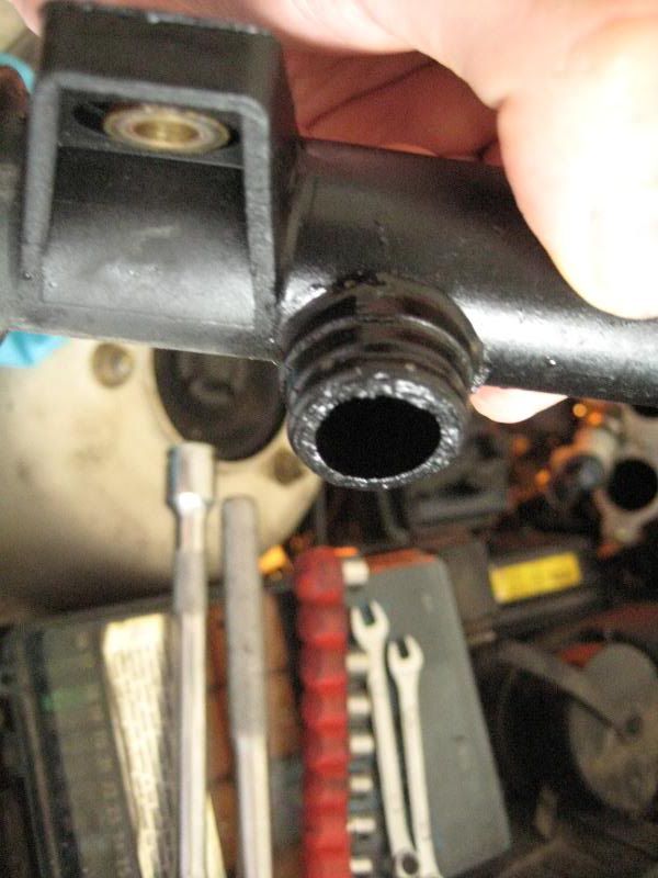

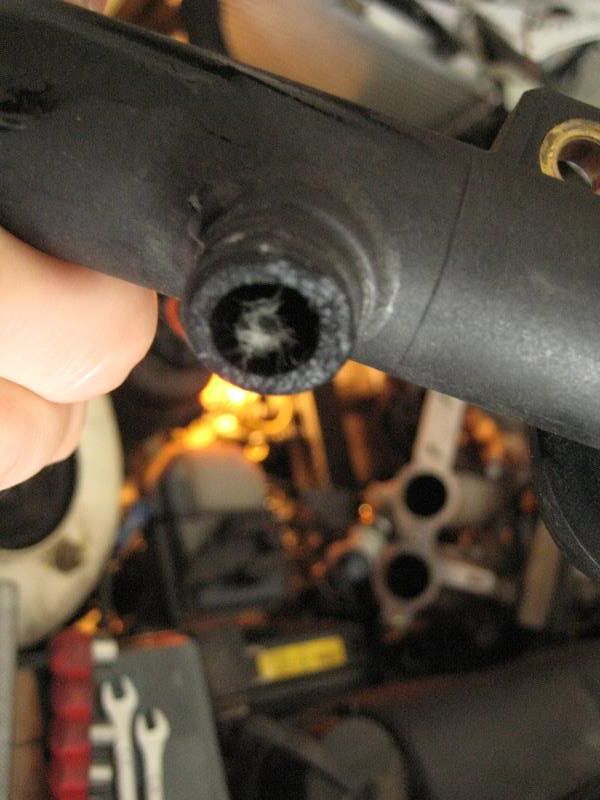

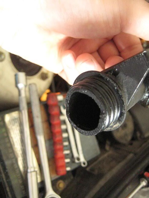

just found out today that the cooling pipe attached the engine block is fucked.
all the connection were brittle and cracked.  I did not order this part so its gonna set me back a couple days.

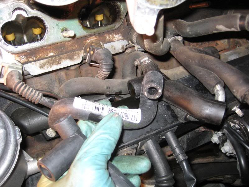

Ok so got some new parts today!
water pipe
Idle control valve hose
weird air hose
water pipe installed

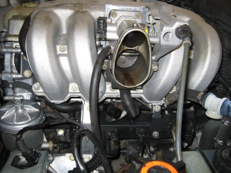

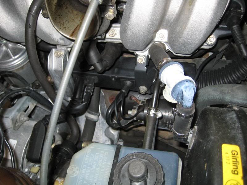

Nice pictorial writeup... what is that white/blue L connector you have on your vacuum line?  That line goes to the booster???

I made the same mistake. Pulled the plastic coolant junction out and most of the plastic stayed inside my old coolant hoses. Great pics!!
This is sticky material

Quote from: AcSchnitzer318is;54747
Nice pictorial writeup... what is that white/blue L connector you have on your vacuum line?  Does that line goes to the booster???
ahem, *cough*  ;)

« Reply #6 on: August 13, 2008, 10:47:24 AM »
You mean this one?  I don't know.  The clamps look original so I don't think its ever been messed with.

Quote from: ///m42 sport;54799
Mine has something similar. its not colored blue.. its black plastic on my car..

^It's clearish plastic on mine... It's blue/white on a different m42 e30 I looked at the other day so I was wondering.  I'm trying to look at everything possible to find the cause of my start idle problems.

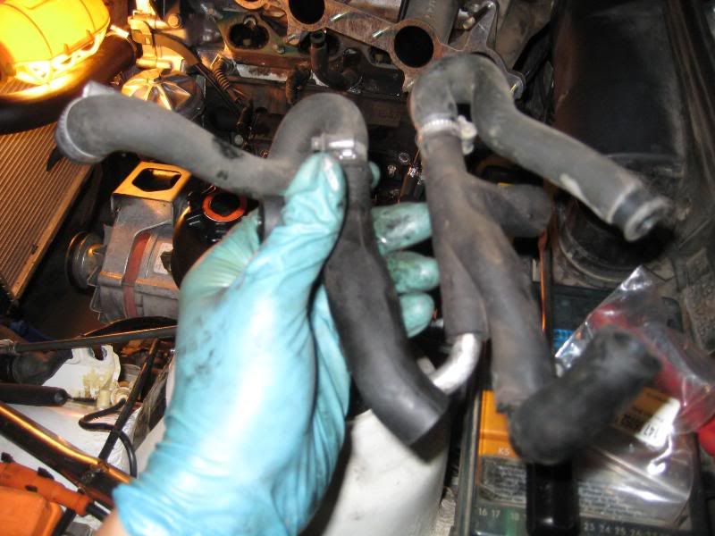

Finished it hoses up today.

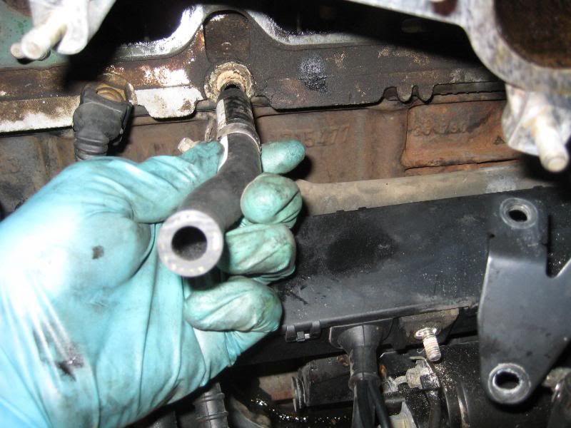

hooked up one end.  I'm pointing to the same hose here.
Hooked up one end of that u pipe with the 50 hose fittings!
Sorry didn't take a pic of the middle attachment of the waterpipe.  It goes to the radiator around the drain plug.
new lower intake gasket

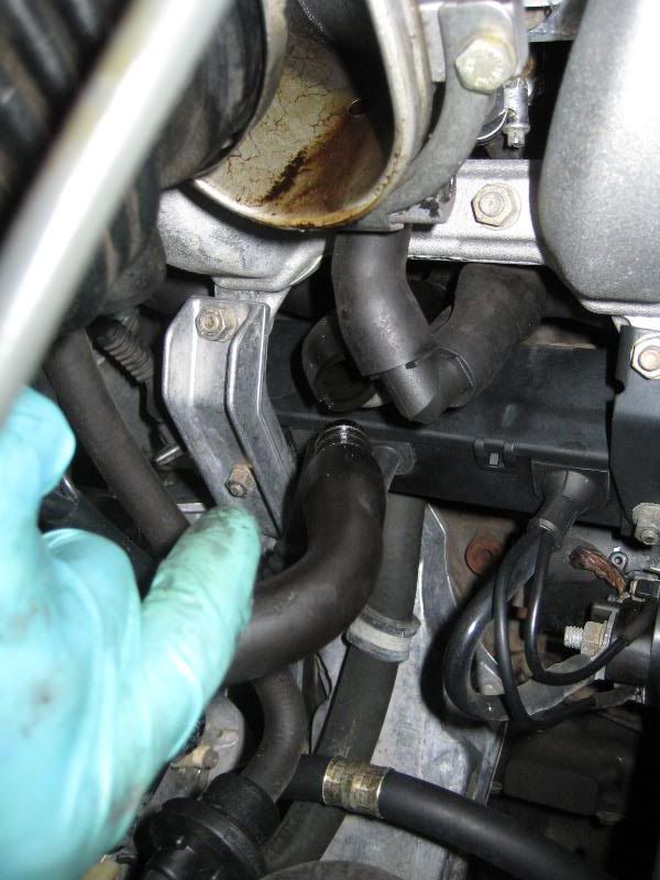

Connected this hose from the edge of the engine block to the bottom pipe on the firewall
Already showed you where this hose comes from.
Now mount your lower intake manifold.
pull these two pipes out the opening.
just showing where the hell this hose is coming from
this is what the mess of hoses should look like

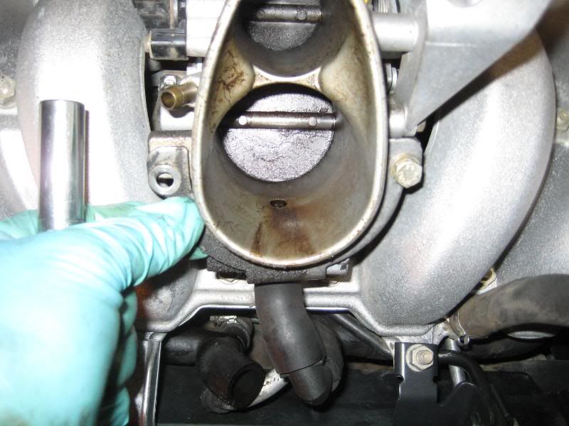

Mount your throttle assembly.  Sorry no pics.  Dont forget to reconnect the water hoses to the throttle warmer (?) or whatever that part is called.
remember that C shaped bracket on the lower half of the throttle assembly?  well its there to hold the lower half of the throttle warmer to the throttle assembly.
then reconnect this bitch of a air hose.
Then the throttle cable.  I might have missed a connection or two in the reassembly...refer to my dissassembly pics.  BTW anyone know the part # for these two parts?  Both were crusty and brittle and are falling apart.  Thanks.
Its a one way valve to maintain vacuum in the brake booster in case the engine shuts down.
Maybe this is a good time to clean out your throttle body.

Quote from: ///m42 sport;54828
If you're referring to the grommet where the cable passes through the bracket..
Grommet
Part number: 35 41 1 152 744
The clip where the cable attaches to the TB actuator arm (?), I'm still searching for..  I needed both pieces, myself ;)
