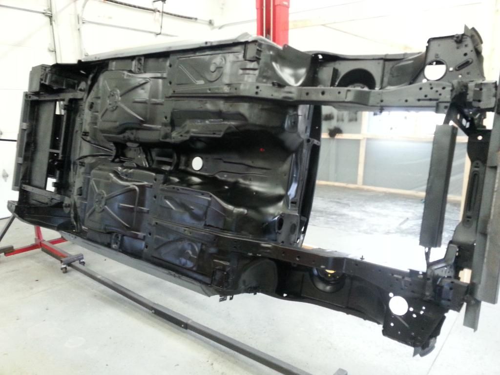

I forgot to mention the plans on the roof. The old sunroof was a total loss as well as the cause of lots of the rust issues the chasis had. So I junked it and will be riveting on a sheet of aluminum with sealant then filler to blend. This will save a massive amount of top weight too!

Chasis, trunk and engine compartment sprayed with 2k epoxy with ceramic resin. Stuff is rock solid and super thick.

The body work is very impressive!

Thanks! Not going to lie though..starting to get a bit anxious to start wrenching again. 8) Knowing my luck I will chip the coating banging tools/parts against it! Going to wait a few days for the epoxy coating to get a good cure before I start bolting the suspension back on. So, in the meantime I need to take inventory of what I have and don't have so I don't get any surprises later!

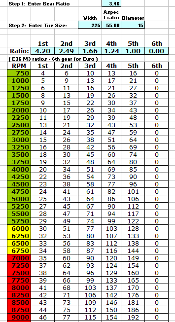

Suspension is finally on! Dang its been a long time since this car actually sat on wheels! Next on the list is clean up the brakes, prep the z3 steering rack, then choose a diff. Not 100% sure on diff ratio yet. I have 2.93 medium case and a 3.64 small case. Not sure I want to use either of them. The zf 310z I will be using behind the m42 has a 1:1 final drive. So with that in mind I may look for a 3.25 LSD.

Nick what diff ratio do you have behind your zf? If I recall its pretty short like 3.73 or is it a 4.10?

« Reply #146 on: December 29, 2014, 10:40:38 PM »
Yes, I am running a 3.73 which is really short. Its great for an atmospheric car, but it will be way too steep for a turbo car.
Here is a little chart I made to help determine what rear ratios will work best for different situations:
As mentioned above, a 3.25 would probably do pretty good in a turbo car.

Nice chart. I was running my numbers based on an old diffsonline spreadsheetand your numbers are spot on with what I am getting with the spreadsheet.
I run a lot down the interstate as I live a mile off one. So, I don't want anything too steep but want to retain some good torque for strip/track. The 3.25LSD looks to be the best of both worlds. 3.46lsd is VERY tempting puts me at ~3600rpm @ 75mph.

Well, I decided on and purchased a 3.46 LSD. Price was right so that helped make the decision easier.

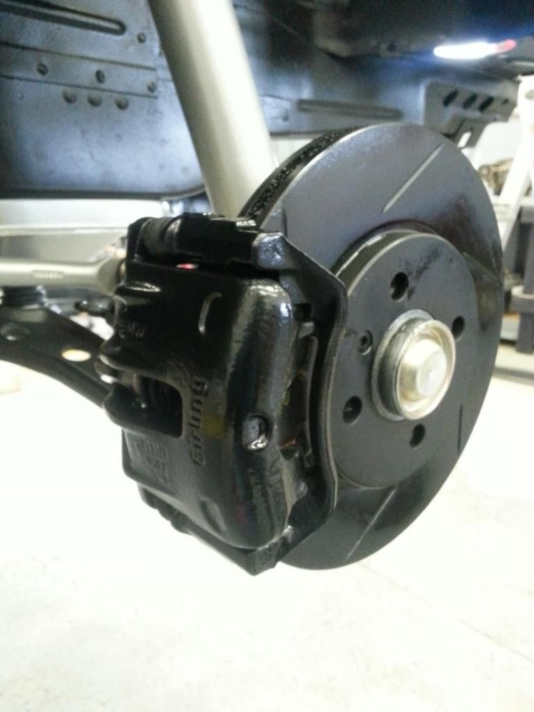

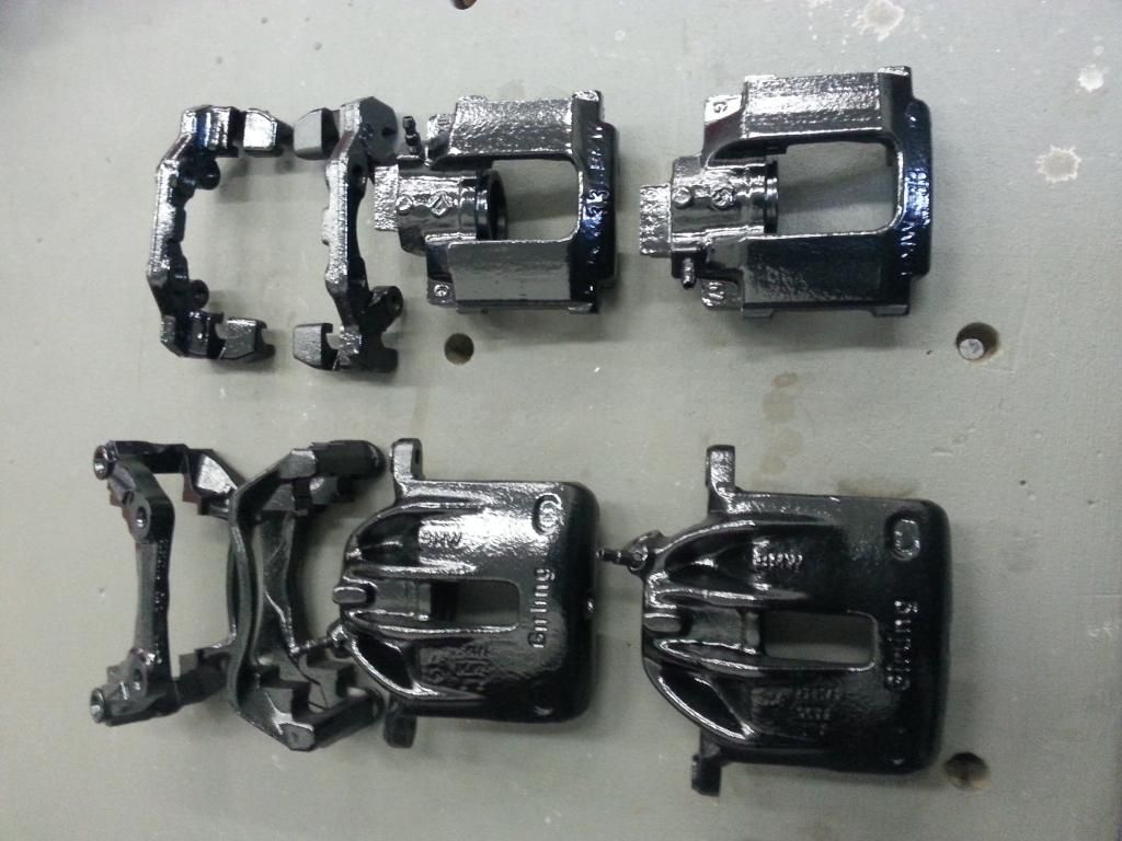

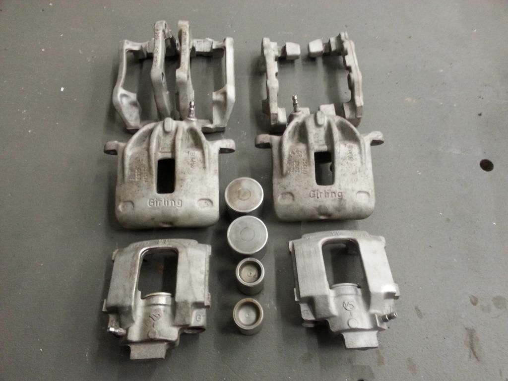

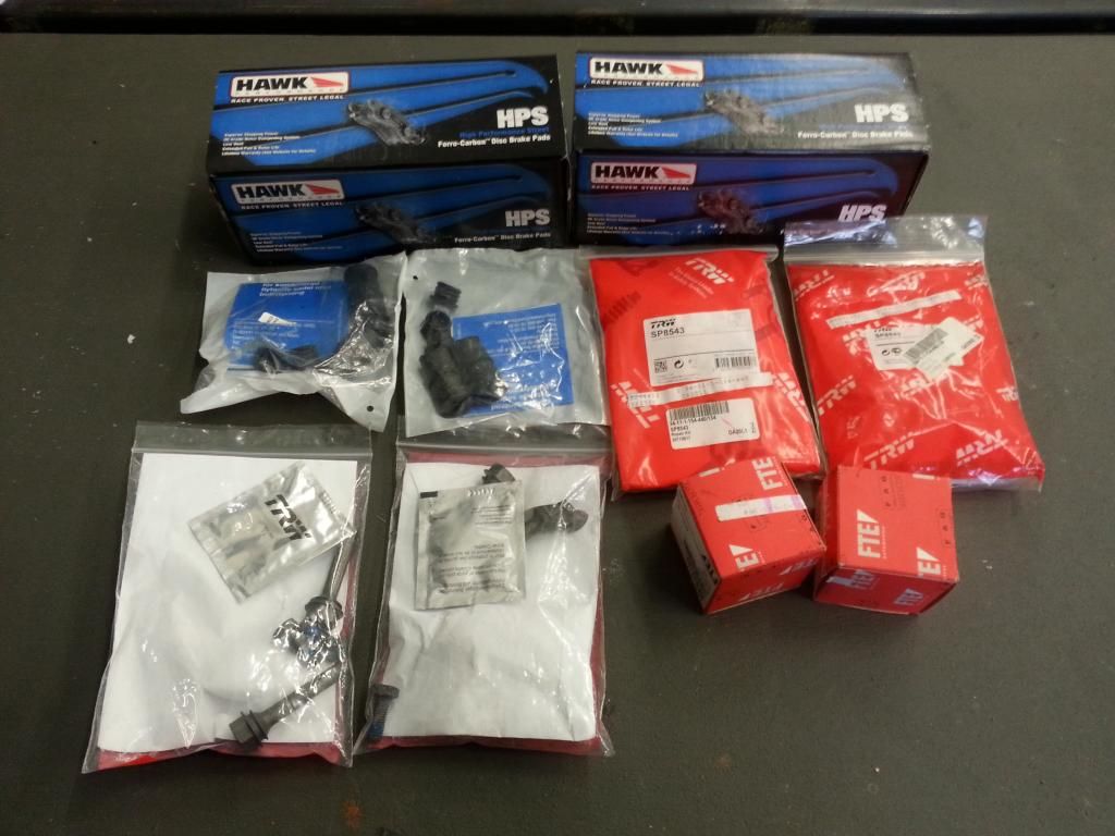

Just finished a complete rebuild on 4 brakes. OEM rebuild kits and Hawk HPS pads.

Did you paint your rotors?
