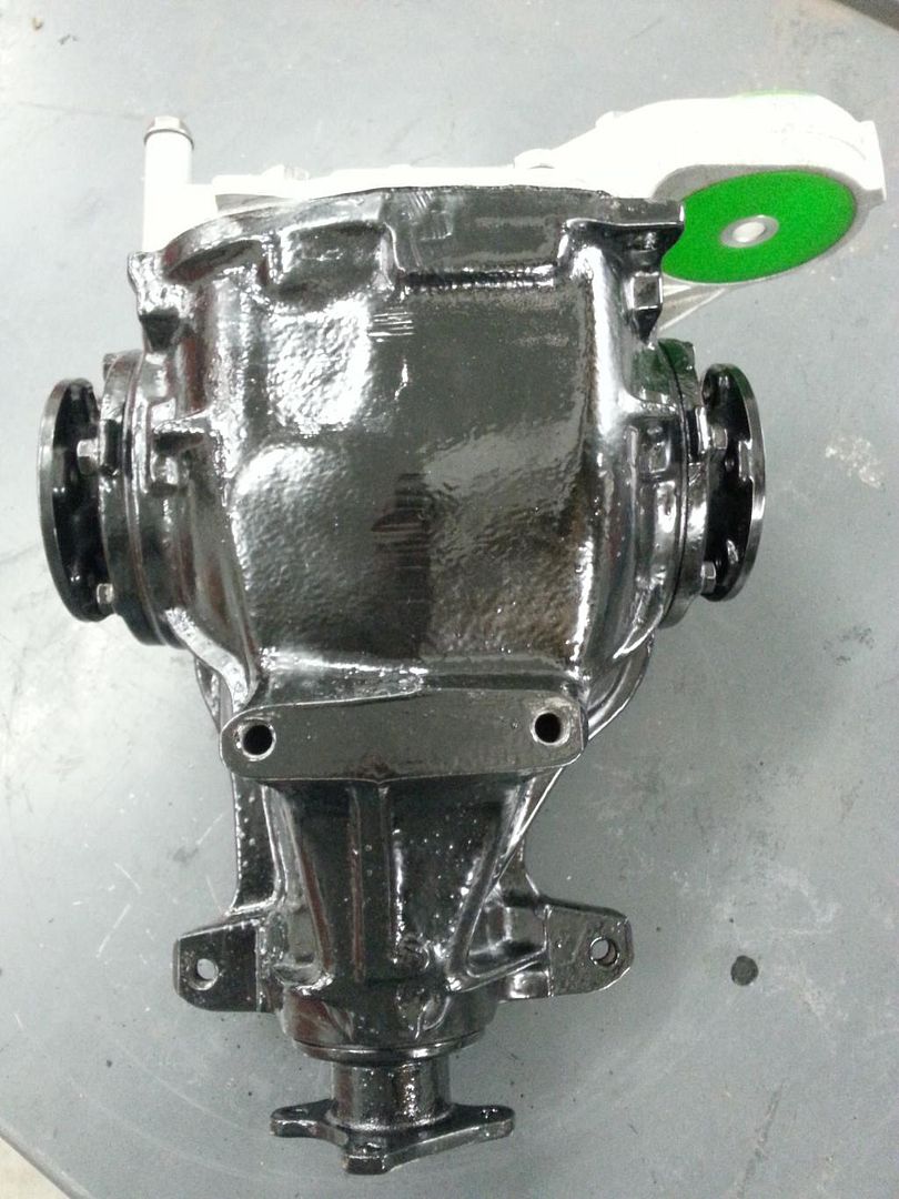

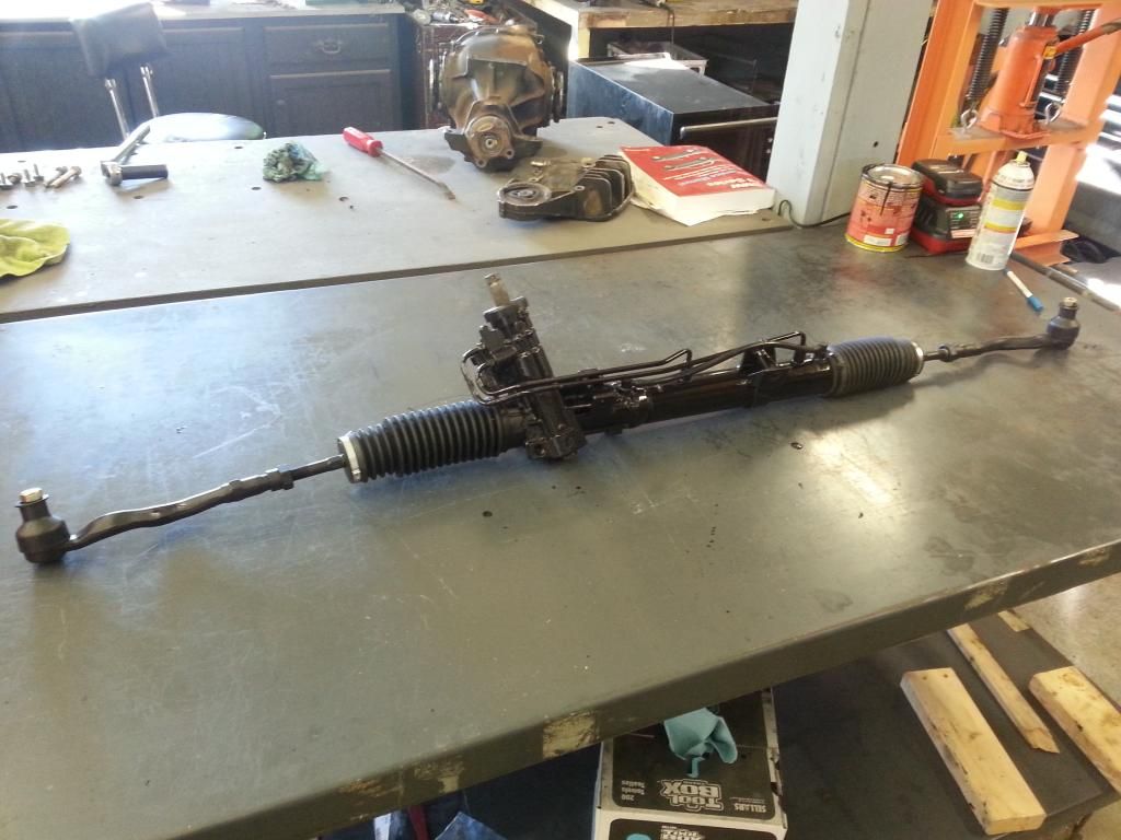

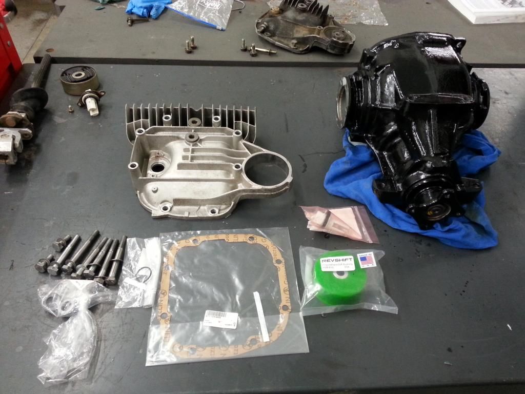

Z3 2.8turn steering rack all cleaned up and installed. Unfortunately that's all I will be accomplishing this weekend as my day was cut short as I cracked the differential cover attempting to press out the "frozen" bushing. Any leads on a new cover would be great!
Jaker
  • Posts: 15
  • Freshly Registered!
« Reply #152 on: January 18, 2015, 02:06:16 PM »
Lost track. Is you diff a small or medium case? I have a spare small case rear cover for sale if it's correct.
jrw21
  • -Receive: 6
  • Posts: 220
« Reply #153 on: January 18, 2015, 04:09:22 PM »
I am using the large case. Don't have one of those laying around by any chance?

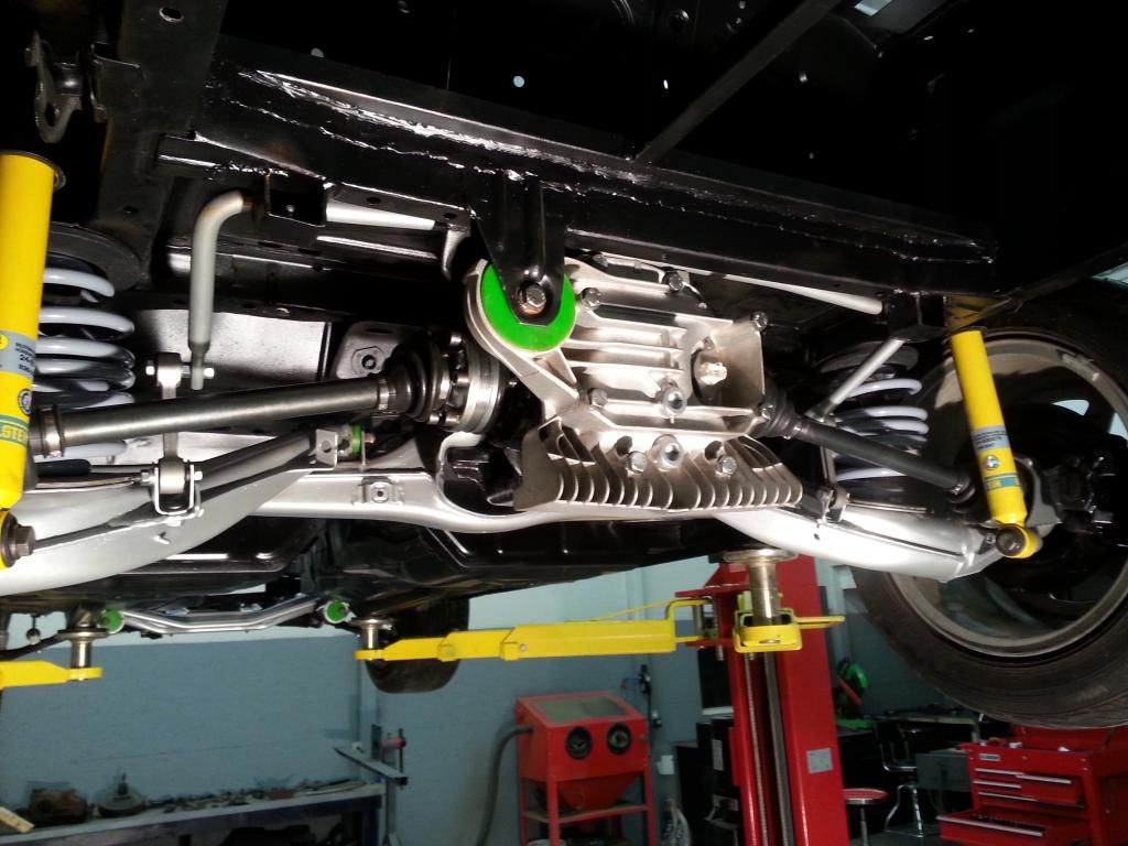

So, spent some time searching for a replacement cover and gave up. Ended up finding a finned cover and pulled the trigger so here we have my final drive! 3.46lsd:

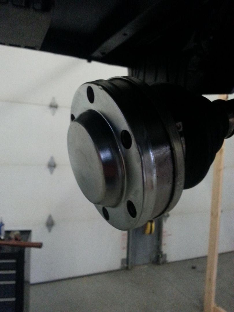

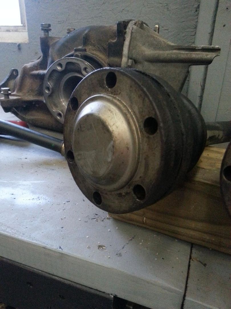

Ok, not sure why I didn't notice this sooner but... My new axles have a different variety of dust shield which is not allowing a good seat on the diff output flange. So, trying to decided if I should:
1: Torque the bolts down and see if the thin aluminum dust shield will "crush" into place.
2: Buy 2 new axle boot kits (Since the dust shield doesn't appear to be sold individually)
Original dust shield axle:
New axle dust shield:
as you can see the only difference is the crown ledge. Diameter is identical.
jrw21
  • -Receive: 6
  • Posts: 220
« Reply #158 on: February 11, 2015, 08:51:58 PM »
Option 1 worked like a charm. Torqued the bolts down in a criss cross  pattern and crushed the aluminum shield perfectly.

The finned diff cover fits with some longer bolts. I believe they came on the Z3Ms.
jrw21
  • -Receive: 6
  • Posts: 220
« Reply #164 on: February 14, 2015, 10:34:20 AM »
Yep, this cover was from a z3m and does require longer bolts for the added .5L capacity.
