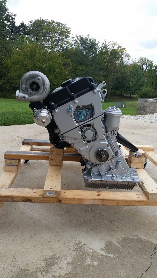

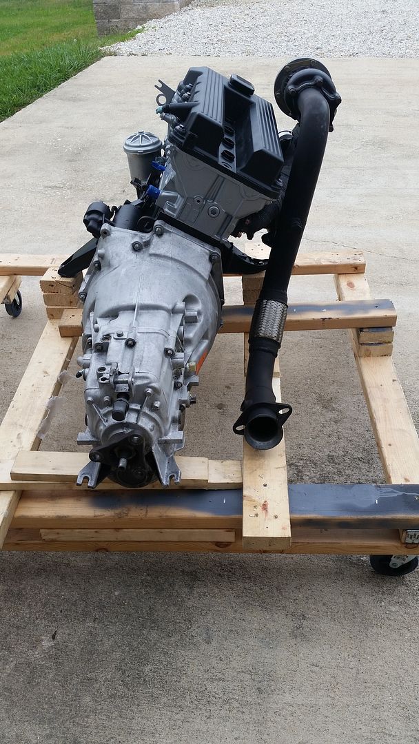

« Reply #172 on: September 26, 2015, 10:20:43 PM »
Got the kit installed and transmission mated. This kit is really nice fits together with the zf310 and m42 like it was oem. The extra grabbing power of the 240mm clutch will be perfect! 8)
had to make a tool to get the crank bolt torqued to 244ft/lbs spec:
New pilot bearing installed:
« Last Edit: September 26, 2015, 10:23:05 PM by jrw21 »

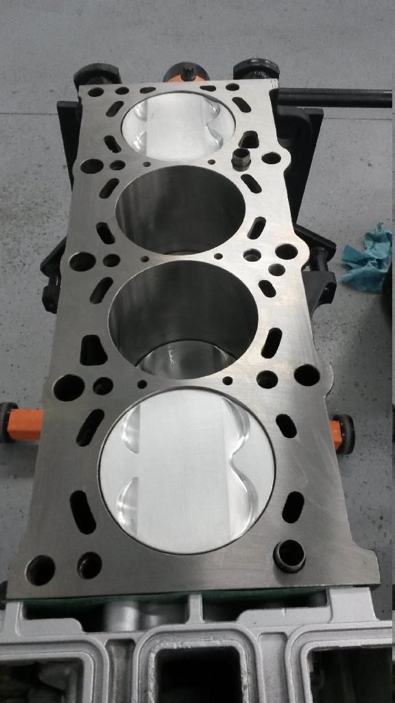

A little scared about the 86.5 bore, how much wall left between pistons? usually that bore is used on high revving N/A, but if correctly tuned and built it will not be a problem.
« Last Edit: October 01, 2015, 10:34:57 AM by nuvolarossa »
jrw21
  • -Receive: 6
  • Posts: 220
« Reply #176 on: October 03, 2015, 10:32:25 AM »
Thanks. Yeah, the turbo is old school. The tubine housing and wheel have been upgraded to flow a bit more. Down the road after I get this thing dialed in I will look into getting a decent matched turbo with ball bearings etc. I'm hoping The .63 turbine housing with the 84 trim wheel will start building decent boost around that same rpm. What was your max boost and respective rpm?
Compressor:
46mm Inducer
60mm Exducer
Trim 60
Turbine:
56mm Inducer
61mm Exducer
Tim 84
To me it looks like there is enough meet between the walls to be ok.

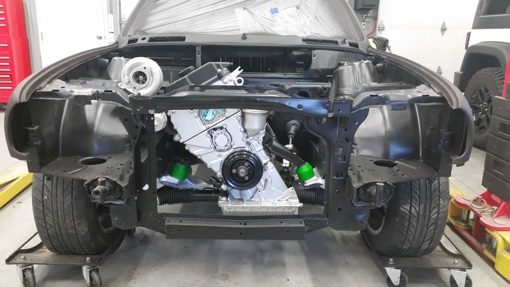

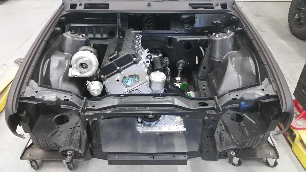

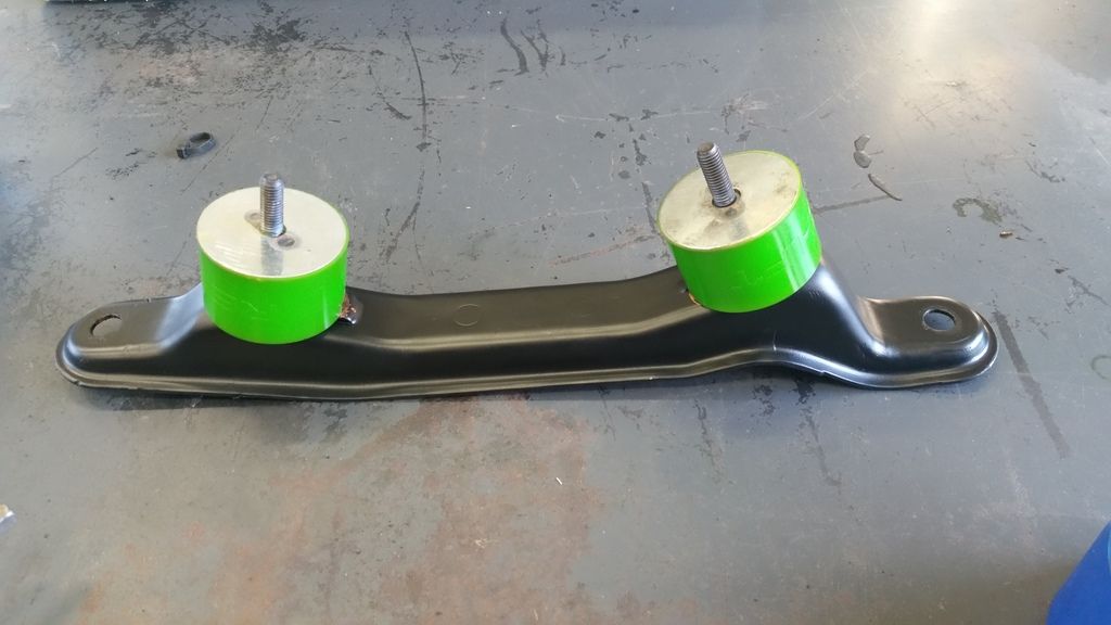

« Reply #178 on: October 10, 2015, 10:30:20 PM »

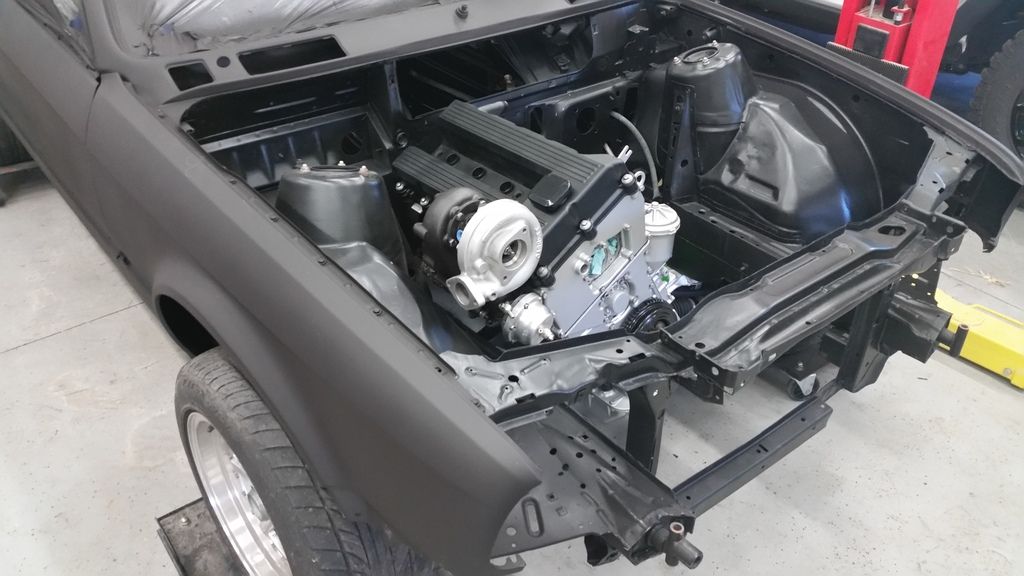

Engine is back in its home! The shocker was the oem m42 transmission brace was a direct fit. I was certain I would have needed to fab up a special bracket. I made a new oil drain for the turbo, much better routing and location. It was a very tight fit to squeeze behind the crank sensor.
Darky
  • -Receive: 23
  • Posts: 630
« Reply #179 on: October 11, 2015, 01:33:35 AM »
Neat, where is your oil pickup going for turbo?
That will vibrate a lot though with those mounts.
