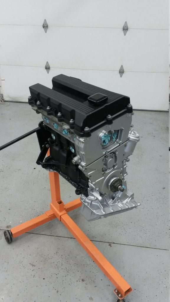

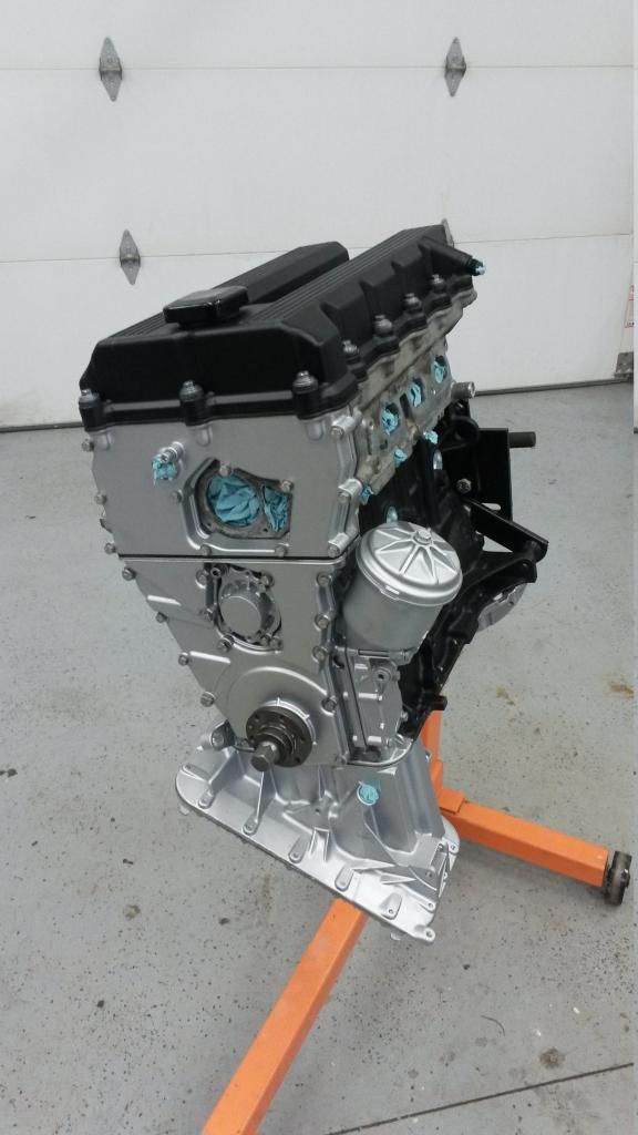

Made a bit more progress tonight. This is about as far as I am going to go with the engine for awhile as I will be directing more time to the withering chasis that is rusting away as I type this.
this is how it will be sitting for awhile, such a shame as I would like to fire it up!!

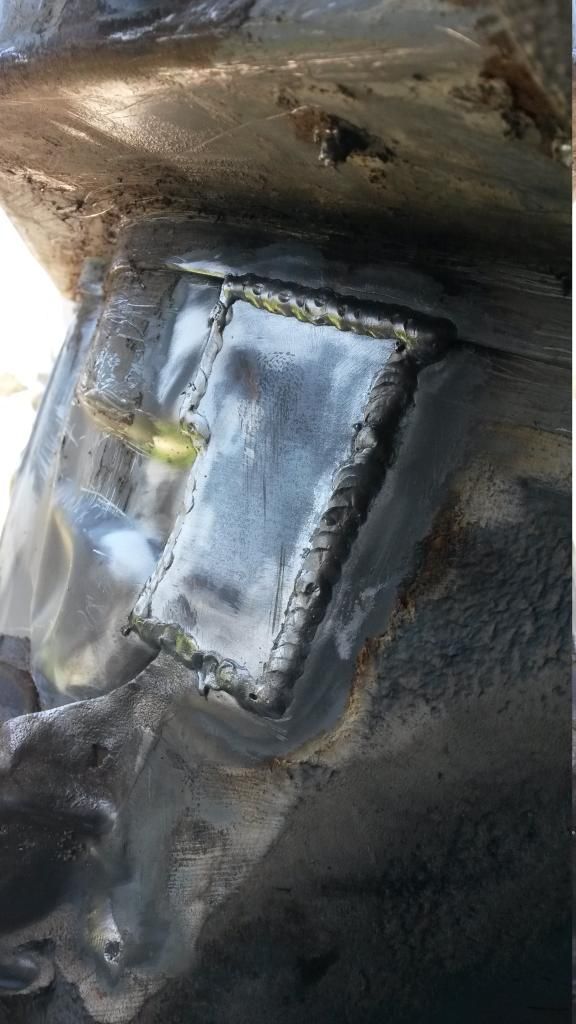

« Reply #124 on: May 03, 2014, 08:09:31 PM »

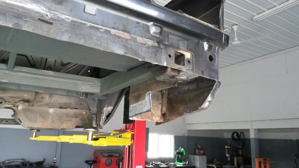

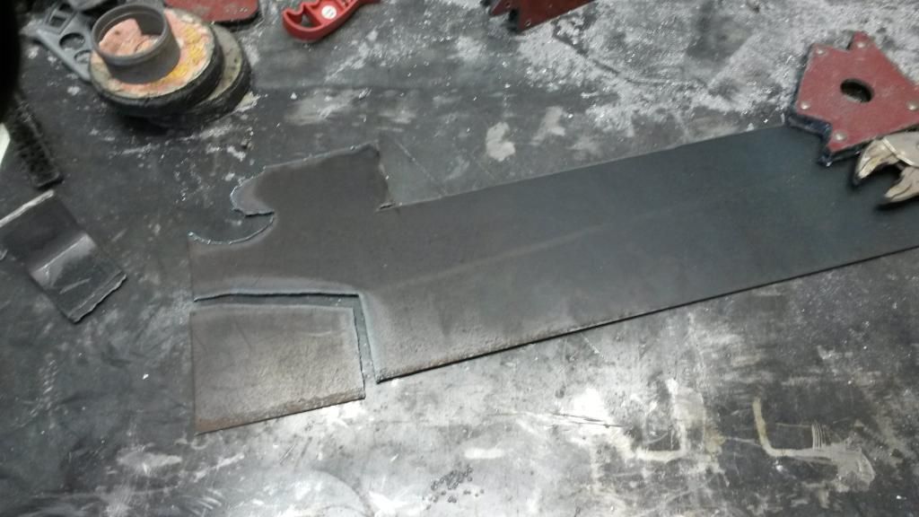

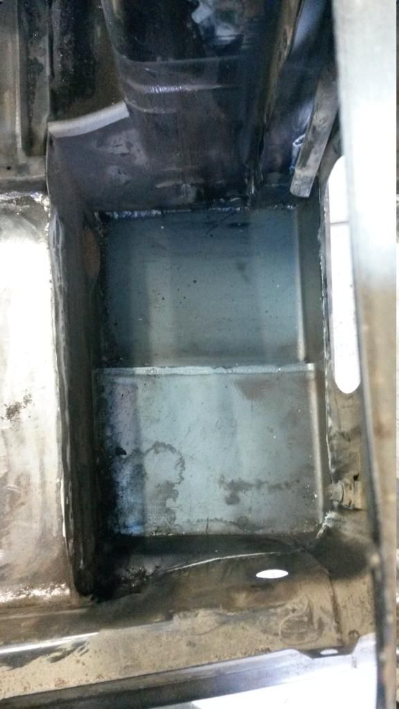

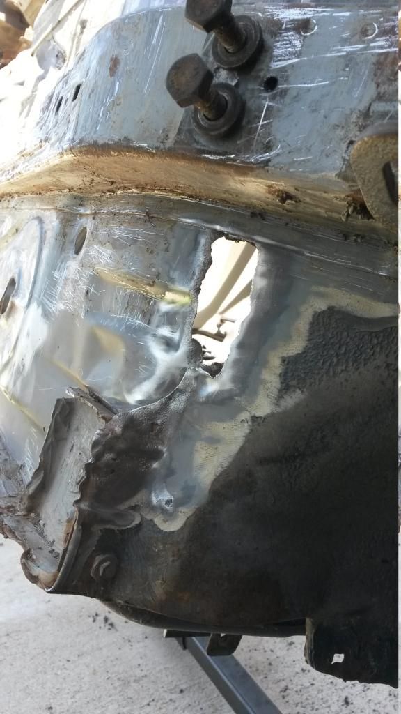

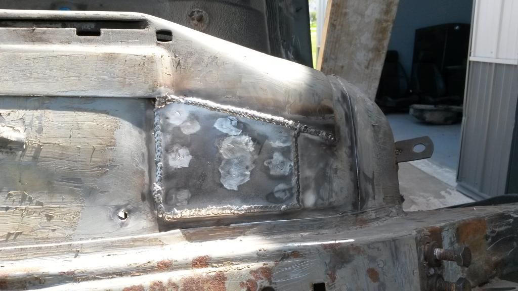

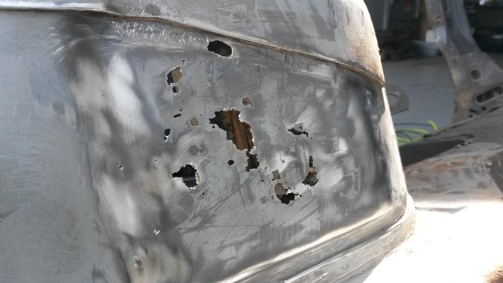

Back to the chasis: I spent the day cutting out rust spots and welding in new sheet metal. The area directly under the accelerator pedal was almost missing. You can see where the pedal mounts to the floor in the first pic.

« Reply #125 on: May 05, 2014, 09:44:20 AM »
Nice weld's! Now i'm scared to look at my chassis... Would expect this from an older bmw or even an e30 but to see this level of rust/degradation on a pretty clean e36 :-X

« Reply #126 on: May 05, 2014, 03:52:11 PM »
The under coating is good and bad.. If water gets trapped underneath of the coating it has nowhere to go so it just sits that are rots away the metal. Some of the areas I removed undercoating from looked like brand new primer and metal...others not so much! Whenever I finish repairing the rust and fabbing new brackets etc. I will have the chasis soda blasted and painted with POR-15.

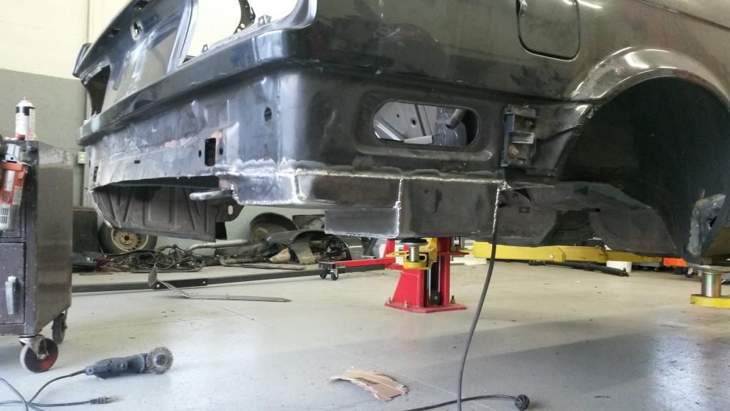

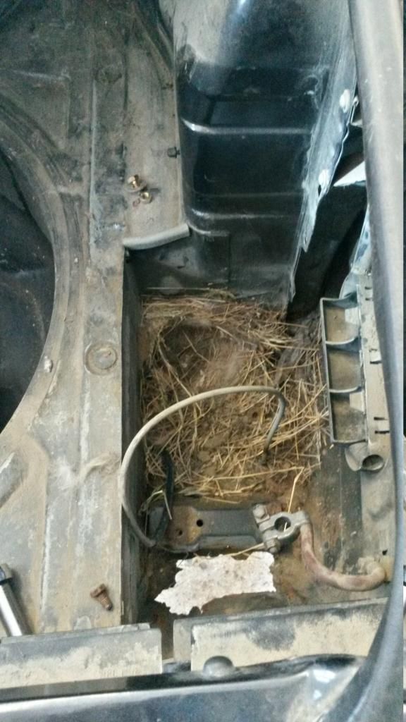

I really like the look of the stock e30 front and rear bumper. But unfortunately I am forced to go a different route due to a birds nest that was under my battery:
It looks terrible but somehow I managed to make it look better than the birds nest battery box. It will all be hidden by an mtech II bumper so no worries.

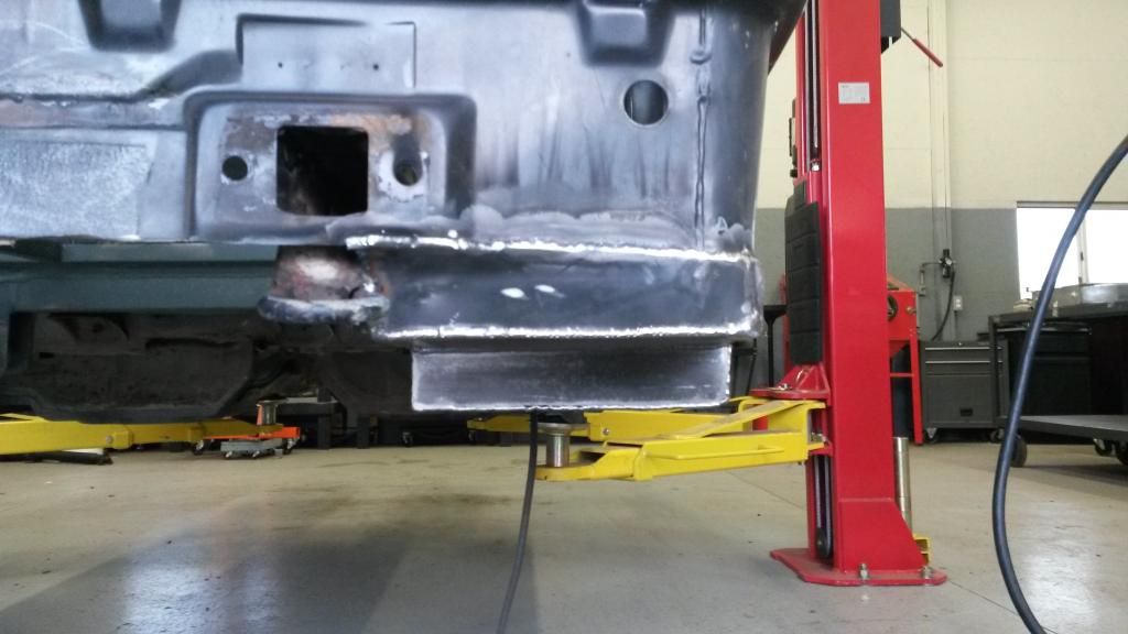

« Reply #128 on: May 08, 2014, 08:24:56 PM »
Small update: Made some rear sway bar reinforcement plates

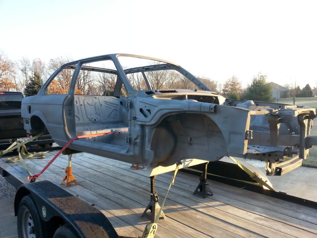

Back at it after a nice long summer and non existent fall.  Dropped it off this evening at a sandblasting shop. They are going to clean it up with corn husks and fine grain sand.  Won't start til next week so hoping to have it back for the long weekend after thanksgiving.
Here is the chasis all loaded up.

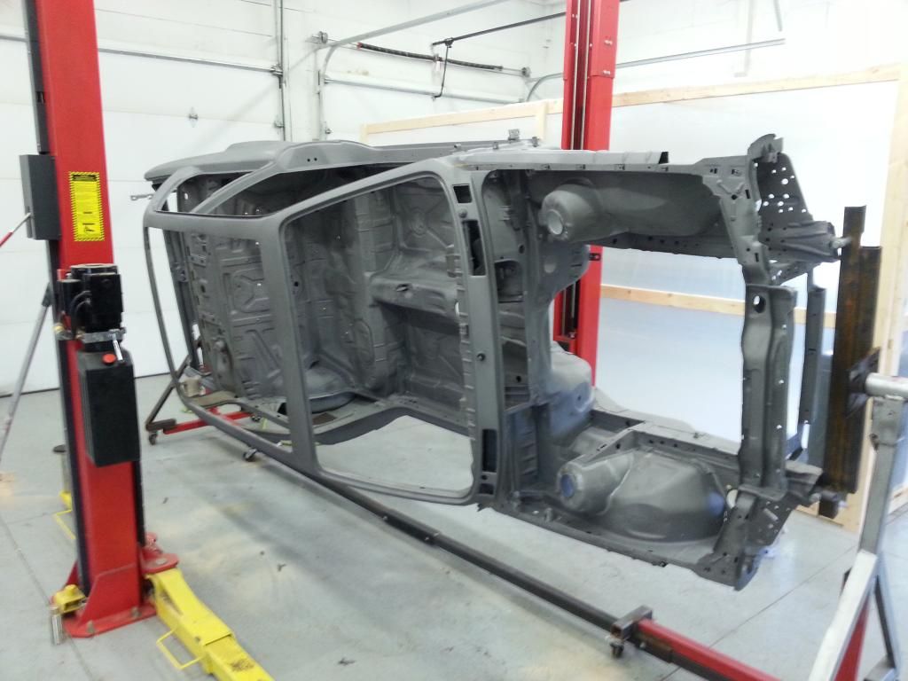

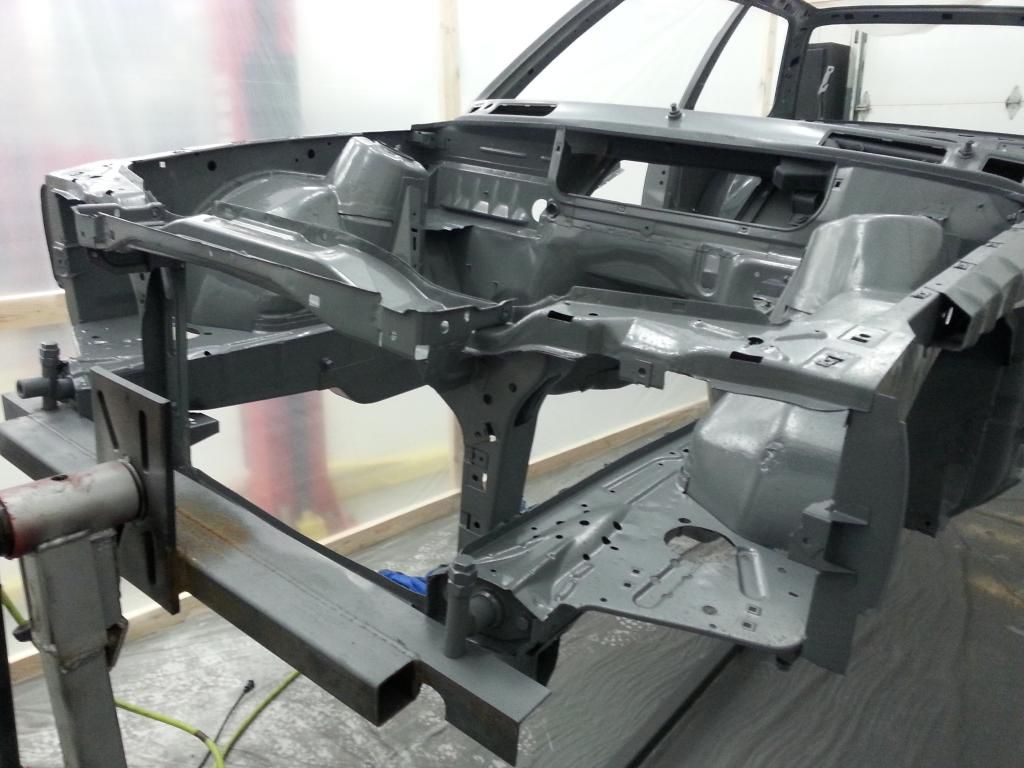

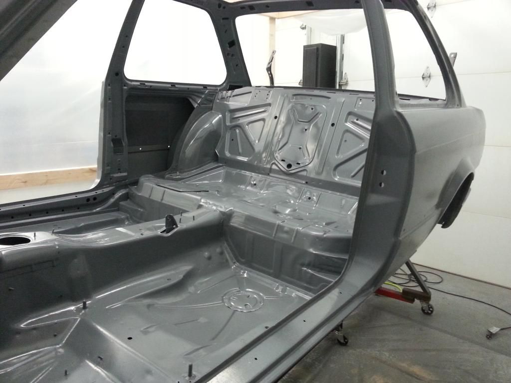

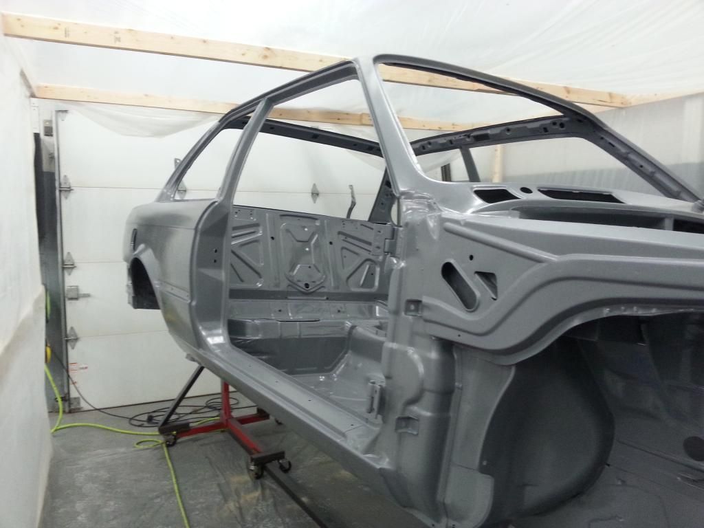

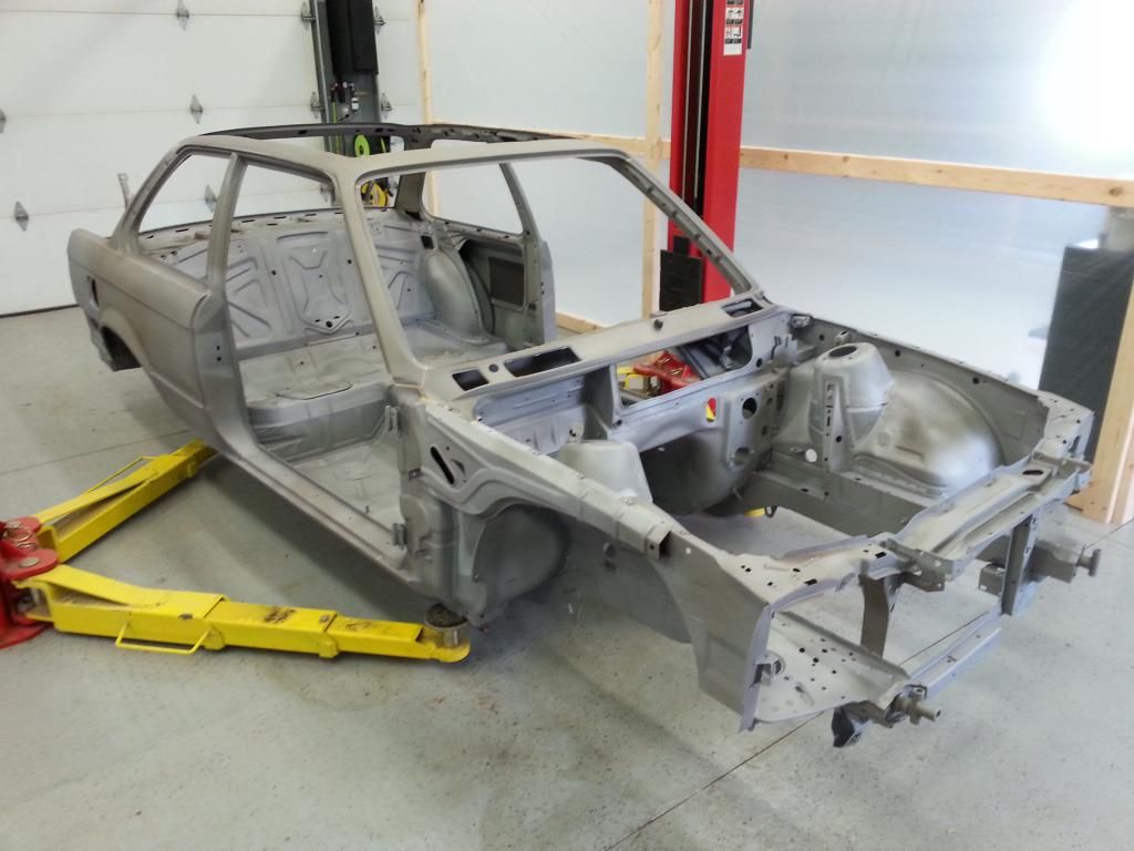

« Reply #130 on: December 02, 2014, 05:30:02 PM »
« Last Edit: December 02, 2014, 05:41:44 PM by jrw21 »

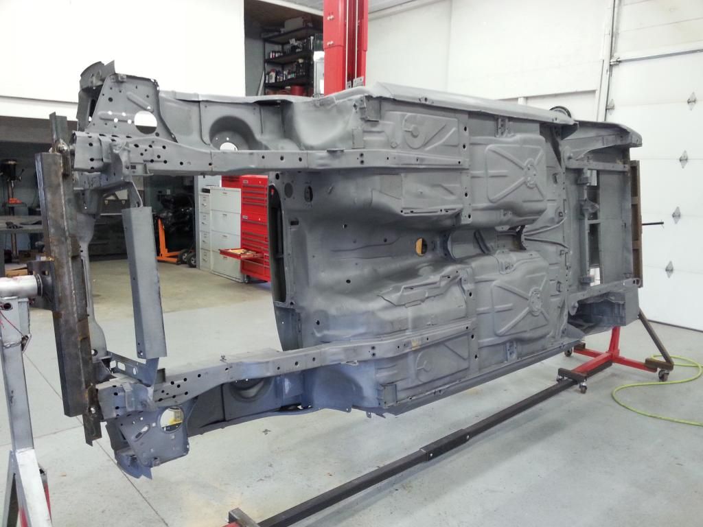

« Reply #131 on: December 02, 2014, 05:47:11 PM »

« Reply #132 on: December 03, 2014, 10:26:11 PM »
So envious of your clean shell!! Turned out great!

« Reply #134 on: December 04, 2014, 06:02:29 PM »
I may have missed where you talked about the roof, but what happened to it? Did you cut out everything to go "slick"?
