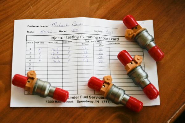

I've got the stock AFM cleaned and reconditioned by Gregs///M.  I'm not sure if he's here but he is on R3V.  Injectors were serviced and flow tested by Linder Tech in Indianapolis.
I'm not sure how the 50 MLS converts, any idea?   At any rate I agree they will be too small.  My guestimates of 165 crank hp show 24lb/hr to be about right.  Of course I'm guessing at two major variables  - HP & brake specific fuel consumption (BSFC) so like I said - guestimate.

Mabeer, I would ask Linder what the flow was on your inj's. It's just a phone call to get the details and then you know where you stand.

Linder flows like I thought 50 MILS (or cc's) in 15 seconds so 50 X4 = 200cc/min.

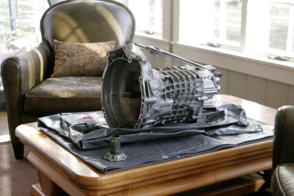

Too cold to work in the garage today so what could be better than a transmission in your office?
That sure looks better than dried flowers or those stupid woven wicker balls. :)
You should make a matching side table/wine rack. http://www.chromjuwelen.com/en/network/320-hooniversecom/150455-project-et-02-bmw-engine-block-table.html
So true. I have a nice M50b25 piston with a bit of conrod attached I retrieved from a failed race motor on my desk!
