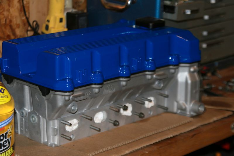

Got the head back from Korman :)  I gotta say up front although it took way longer than I thought it should but Ray Korman was great.  Couple of issues they ran into that I thought I'd pass along if anyone else goes with a Schrick cam. I went with a 256/256 schrick cam, their literature doesn't mandate changing lifters and springs but we experienced coil bind using oem springs.  It was slight so maybe some heads would be okay but mine wasn't.     Anyway ended up with schrick springs, lifters & cam as well as new OEM exhaust valves.  Intake was gasket matched and some mild porting was done.

Finally an update.  As mentioned head is back from Korman.  Valve cover is powder coated Air Force Blue cause that's where Bryce will be going (fingers crossed).  He received letter's of assurance from West Point and Naval Academy. Air Force will let him know in January.  The terribly sad thing after all this work is he can't take his car out until his junior year  :) ... I mean  :'(

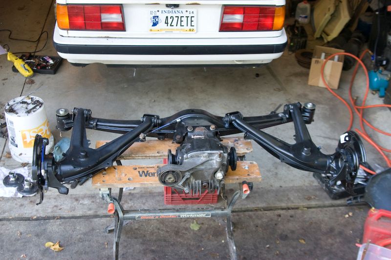

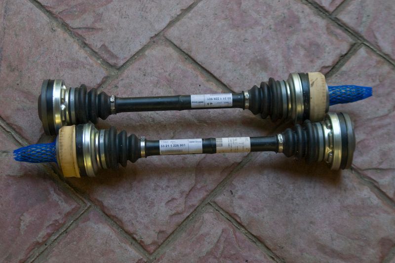

Finally go the rear subframe back in today.  Here it is before it went in.  Looks a lot better than when it came out that's for sure, but more importantly all new rubber bushings.  Rear end is a 4.27 lsd out of a vert.  I replaced the seals and o-rings.  I know the rust on the back end is abhorent.  Body work will be done once Bryce is in school.  I don't htink he'd let me take it off the road again until he's gone.
Remanned from BMW, salty but I've had issues with some other remanned units so we'll see how they do

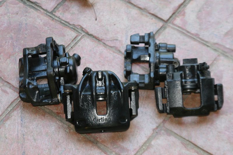

And finally I rebuilt the calipers.  It was obvious the right rear was not retracting as it should.  Removed the rust using a storage tub, rebar, a battery charger and borax solution.  That was really cool to watch and did a great job.  They were so bad going in I really didn't think they were salvageable, but they turned out alright and pistons move freely now.

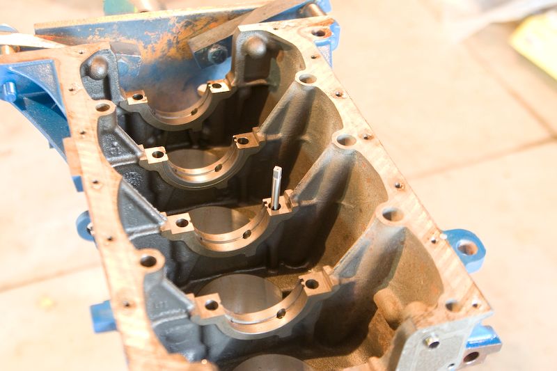

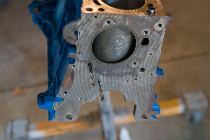

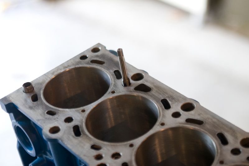

Exciting weekend ahead.  I started getting the block prepped for assembly.  This evening I chased all the bolt holes.  You need 3 sizes to do the block.  M10 X1.5 for the head bolts.
M10X1.5 for the mains and M6X1.0 for the oilpan holes.
The lower timing cover uses three sizes, M10X1.5, M8X1.25 and M6X1.0
I still need to do the rear but I need to take it off the engine stand and I was getting lazy.  I'll do that tomorrow then give it a good soapy wash and brush all oil passages.  I'm going to mic the bearing clearances just to see how I do but I will take it to the machine shop on Monday to double check my measurments.  I think it was in Wazzu70's build where he suggested .001 per inch of journal. Does that sound about right?

.001" for 1" of diameter of journal is correct.

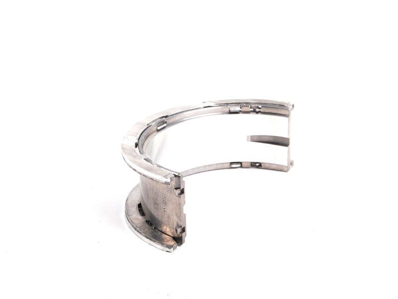

Have you ever seen a thrust bearing like this?  This is what came with the M47 crank.  It is a genuine BMW part.  Just seems kind off janky, but then I'm not an engineer.  The side rails have tabs that clip into the bearing and they rails move. Any idea why it is designed like this and any reason not to use it?

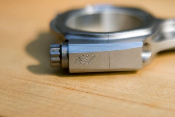

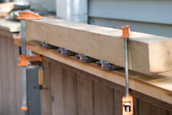

Anyone ever seen an Amish connecting rod vice?
I didn't know there where upper and lower specific bearing halves.  Fortunately I noticed they had different finishes and did some digging.  #425 is top and it had a dull grey finish, #426 was bottom and was shinier for lack of a better turn.  Again these bearings came with the M47 crank so no clue if it relates to M42 stuff.
I just thought this was cool.
I gave up trying to mic things myself.  The old connecting bolts do not fit the new rods.  The new ARP bolts are stretch bolts so I'm not sure how to proceed.  I'll leave it to the machine shop tomorrow.

On the thrust bearing, that looks like a really cheap way to add a thrust surface to a bearing shell. I havent seen them like that though from the factory! My shells were one piece and did not look like that. If the diesel crank has the same main journal sizes, I would just use standard M42 petrol bearings.
