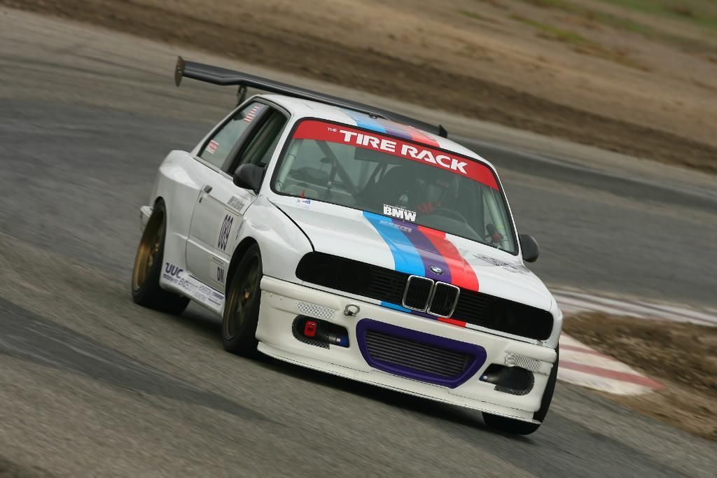

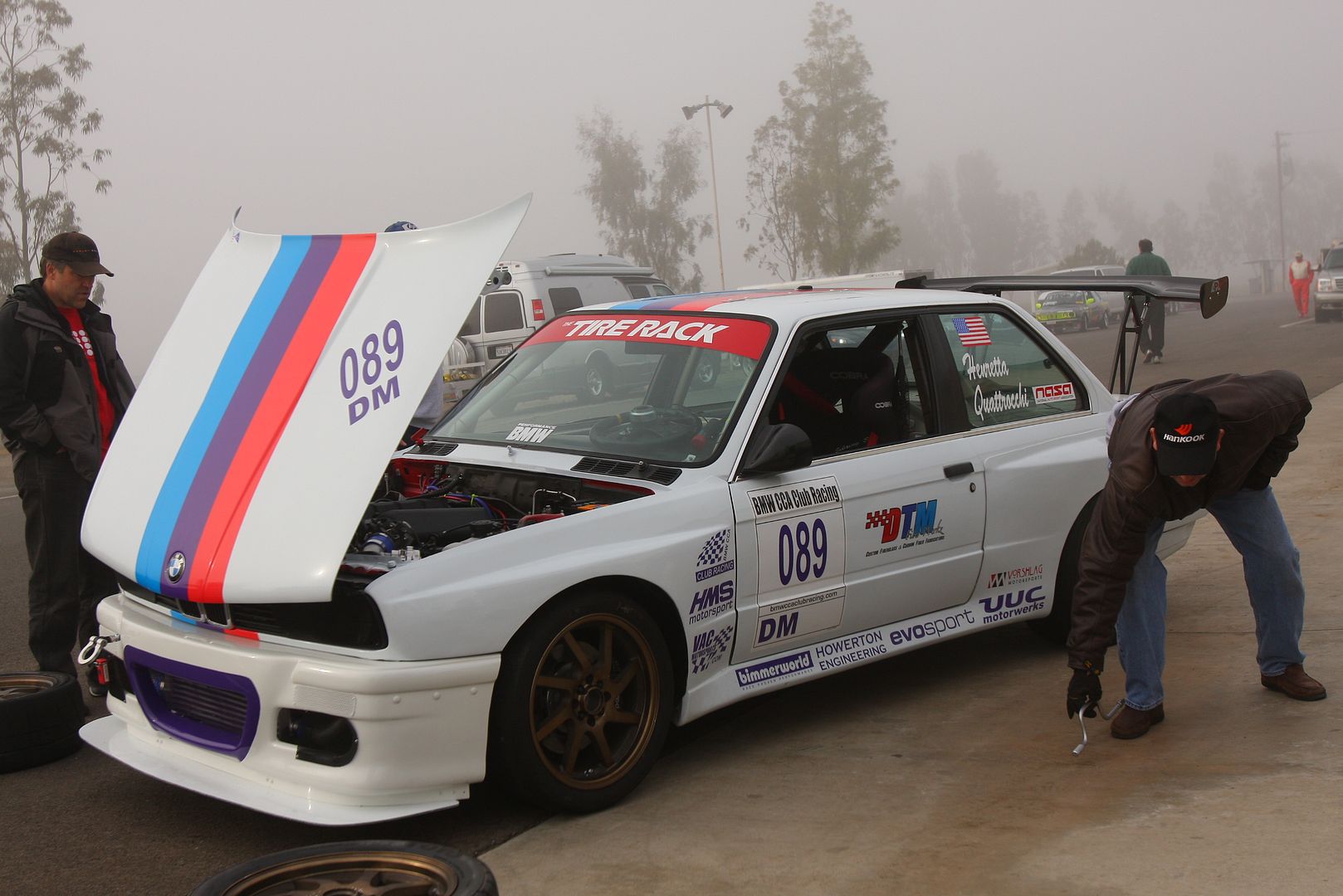

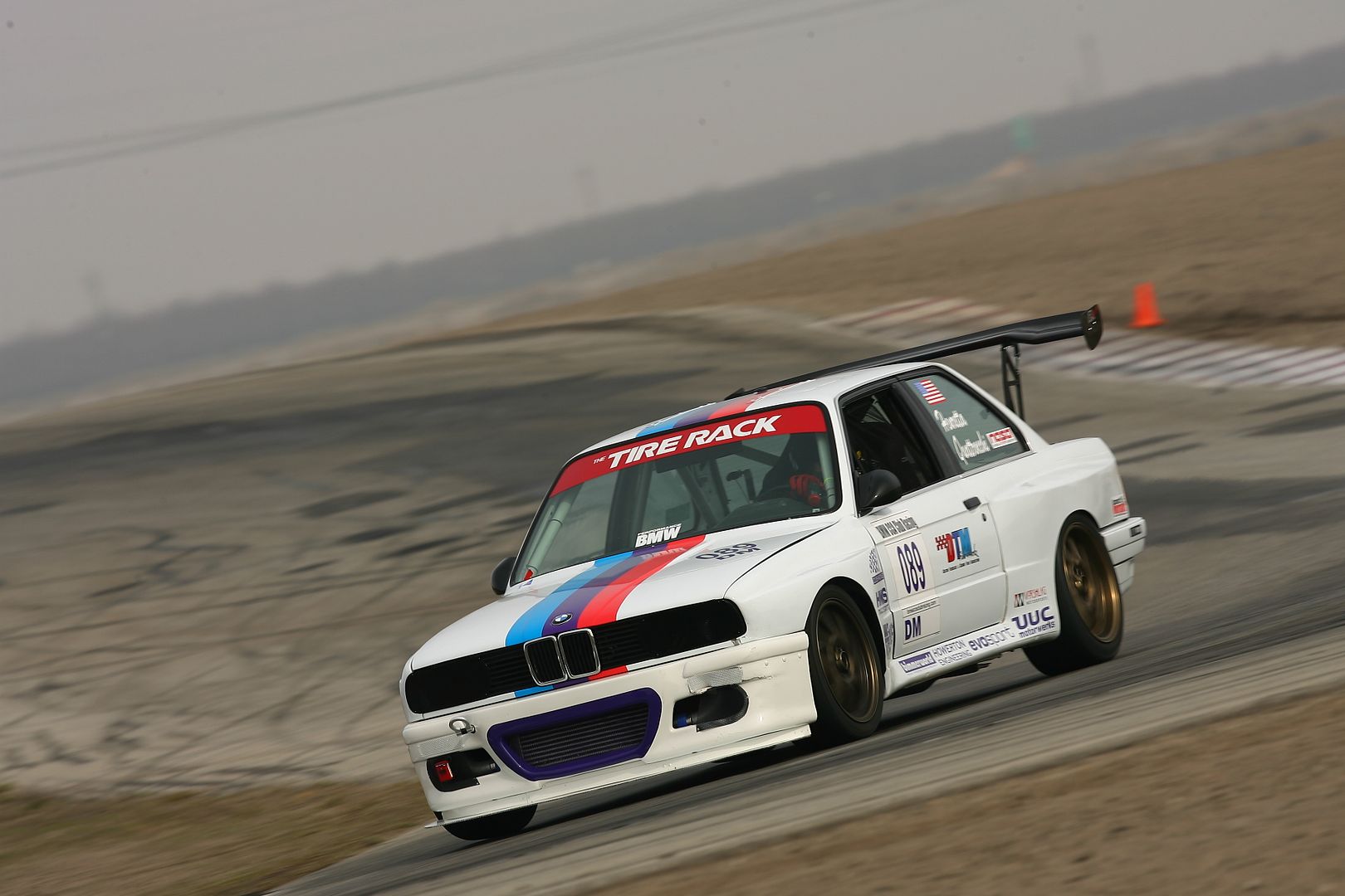

We tested the car last Monday at Buttonwillow.
All of the changes we made to version 2.0 seem to have have paid off with positive test results.  The car handled great and ran really well.
Here are a few shots of the car in action.

What fenders are you running? They are obviously way wider than the M fenders. Did you weld them, fiberglass,...?

Those are DTM Fiberwerks fenders (EuroStop).  Call Ary he can set you up with that kit.  It's fiberglass and it is a little wider than the E30 M3.  The fronts are bolted on the rears are riveted and molded in.  We left the seam in the rear since its a race car but for a street car you could mold the entire fender in.
Not sure if you saw Ary's car (the guy who runs DTM Fiberwerks and sells these kits).  His show car uses this kit and has it fully molded in.   It looks awesome.
