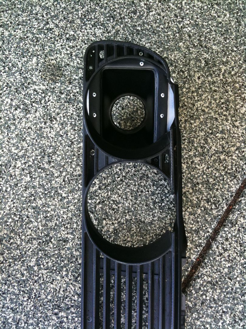

We decided to add some brake cooling to the car.
Here are some photos of the our brake ducts installed in the headlight frame.
Before paint and stainless steel screening.

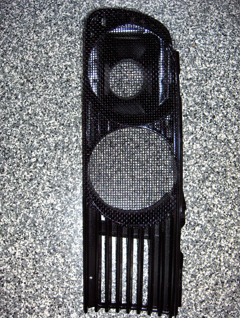

After

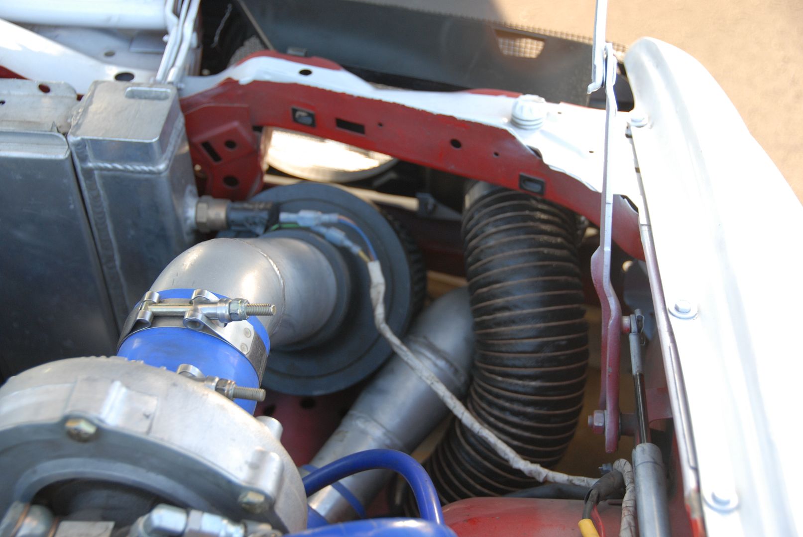

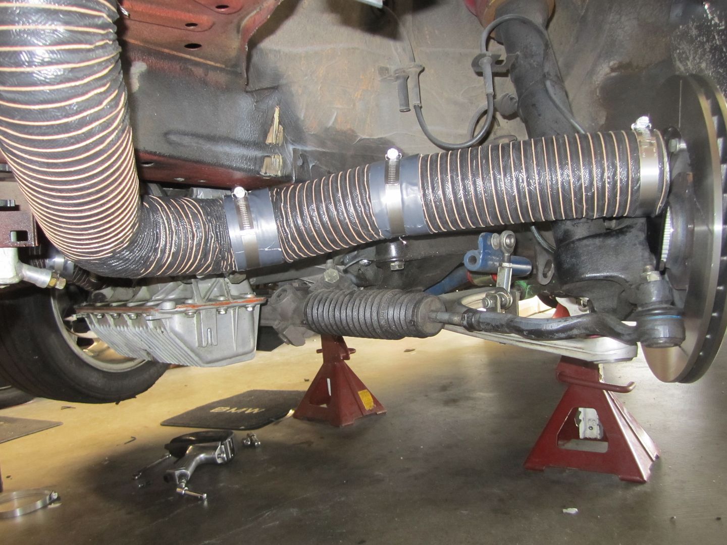

Here are some photos of the final install of the brake ducts.  The headlight brake duct install is a compromise.  We would have liked a direct shot from the lower spot on the front bumper.  The challenge for us is that we need to be able to pull our front bumper to be able to load the car on the trailer.  It would be too much work to also have to hookup the brake ducts every time we needed to either pull or install the front bumper cover.
The left front on jack stands and with the steering wheel turned full left.
This is looking up toward where the duct comes from the headlight.
This is a photo of the right side brake duct showing its path down toward the wheel.
