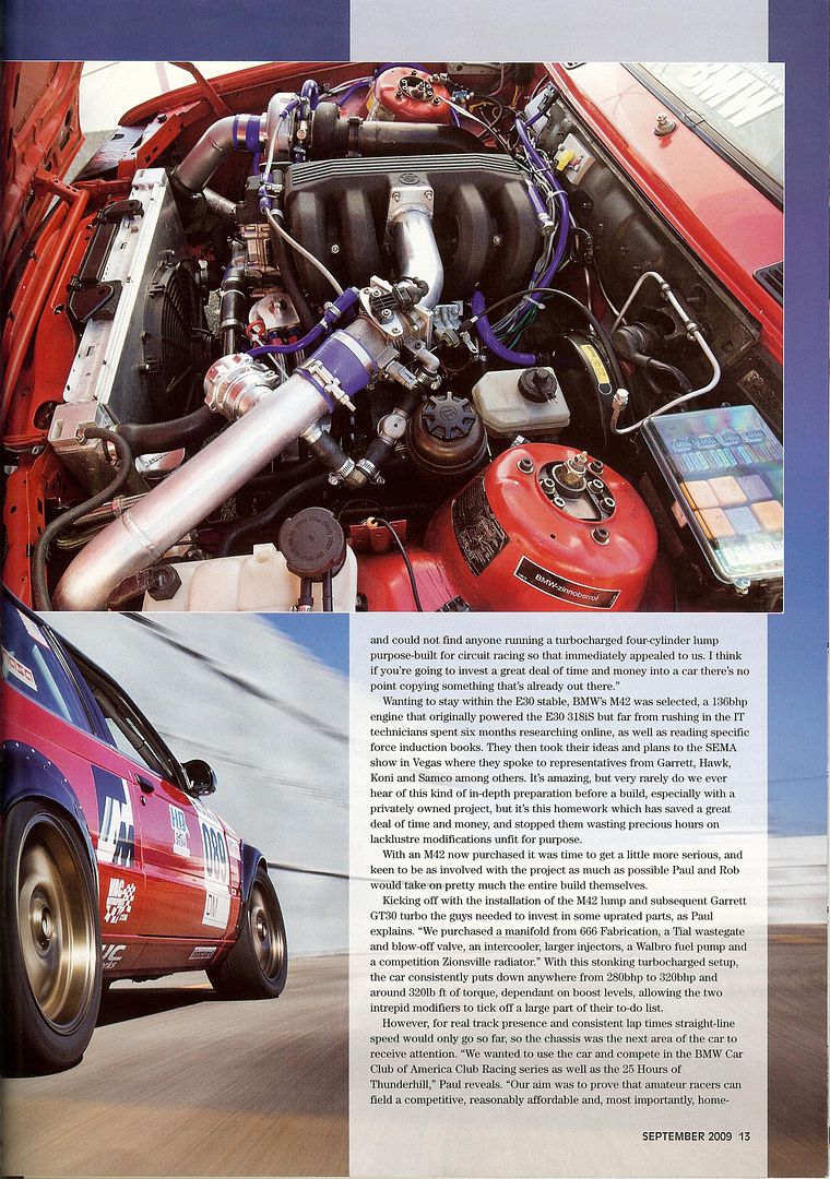

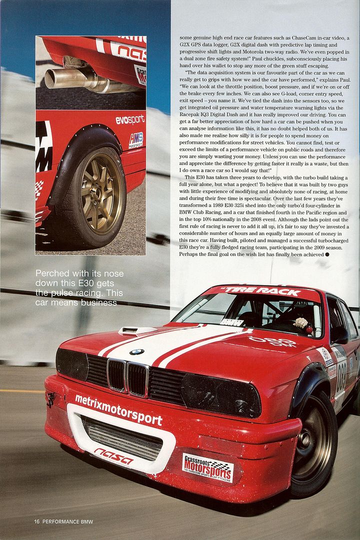

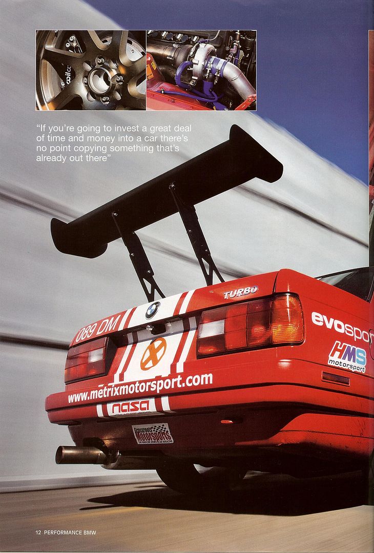

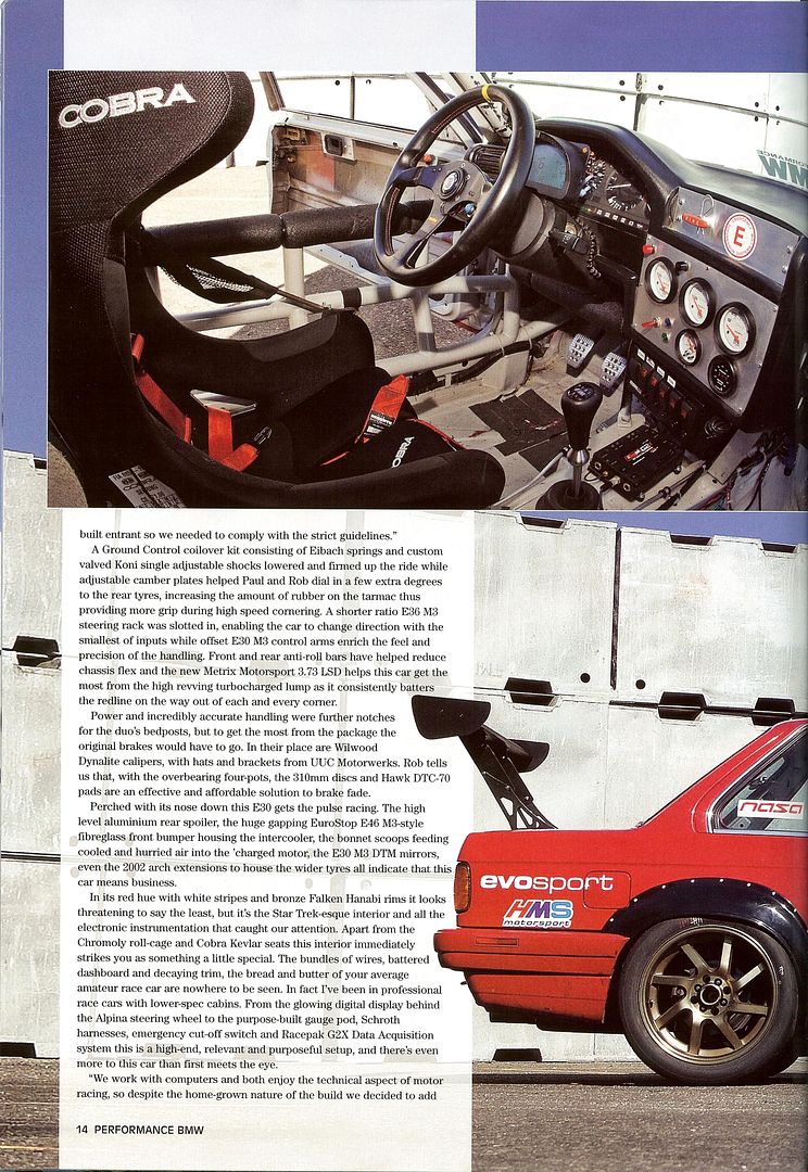

Here is the Performance BMW article article and some shots of version 2.0
Version 2.0 at Buttonwillow last weekend
We still need to add a few more sponsor stickers but the look is about 95% complete.

it says 310mm brakes in the article.  Is that right, or are they the 300mm massive kit??

The brake kit is the Willwood kit that UUC sells.
