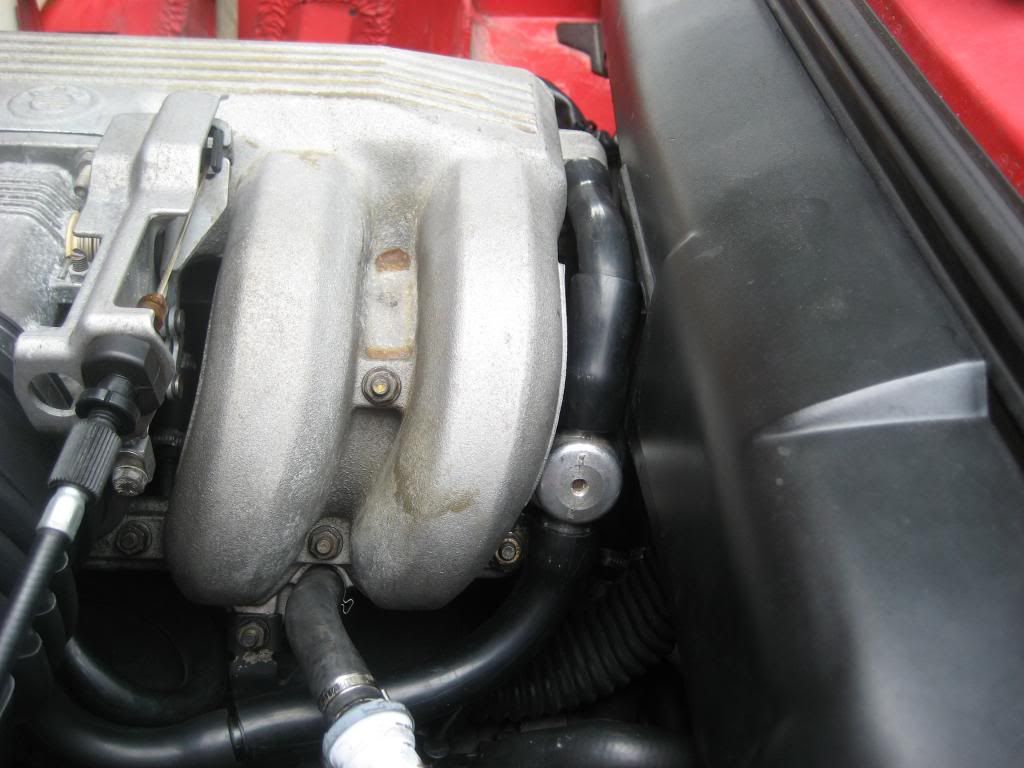

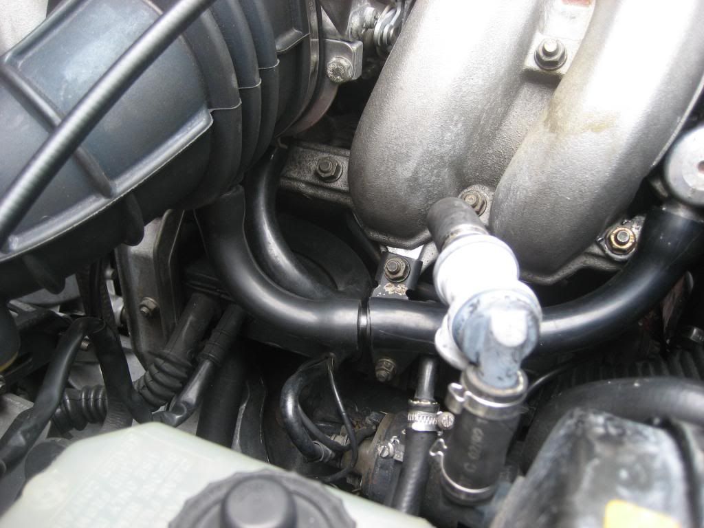

Many thanks to everyone who posted in this thread.  I finally did this project a few weeks ago after thinking about it for a year.  The car runs great (when you have the ICV pointed the right direction  :P)
This picture from page 22 made the process very straight forward so you don't even really need to think about it.  I opted for the loop of hose between the head and the pipe, rather than closing them off, I shoved some 1/2 heater hoe into the 5/8 hose to get a nice fit.

Ha, those are my pictures unless you refer to the diagrams and not pictures. I have since move the ICV to elbow hose to the bottom whole closer to the AFM, away from the throttle body as per bmwman91's stating it in another thread. Didnt really change anything in the running characteristics.

« Reply #357 on: July 25, 2013, 02:53:11 PM »
I was actually referring to this diagram, but your pictures are pretty good too.  I left the ICV where it originally was, I had 2 of the 90 degree connectors (pn 13411721971) one on either side and then reused a plastic connector to go right to the elbow with 5/8" hose.
