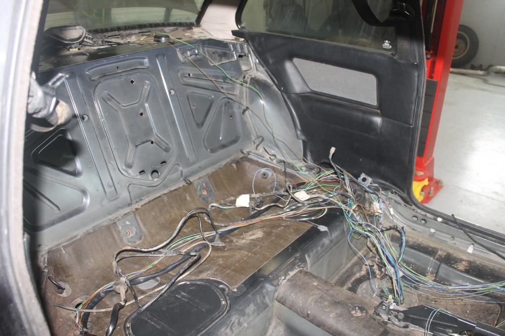

Here is how I started todays work:
This was a HUGE pita to get this far to be able to start pulling all of these wires through.
TRASH all of this is getting JUNKED. Basically these are luxury items. The only luxury item I am keeping are power windows. I couldn't begin to tell you how long it took to chase all of these wires down from start to end to verify what they were...
This is the final slim down wirings loom. Will get it cleaned up and rewrapped one of these days.
Engine bay wire free!

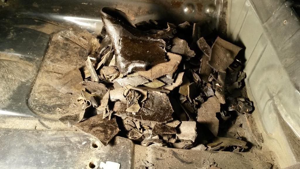

Removed the inner goo:
Ok, if anyone attempts this in the future I found an easy way to do this. Unfortunately I was about 90% done when this happened. I was using a 400watt lamp to light up the area I was working in then took a small break and left the lamp on which heated up the area enough to "melt" the glue which in turn....peeled right off.
wazzu70
  • Nasty Nick
  • -Receive: 18
  • Posts: 671
« Reply #73 on: February 17, 2014, 12:07:44 PM »
You can also use dry ice. Leave it on the LASD (liquid applied sound deadning) and let it freeze. It comes off nicely after that in big chunks!
I removed mine bit by bit with a chisel and a wire wheel for cleanup.
-Nick
