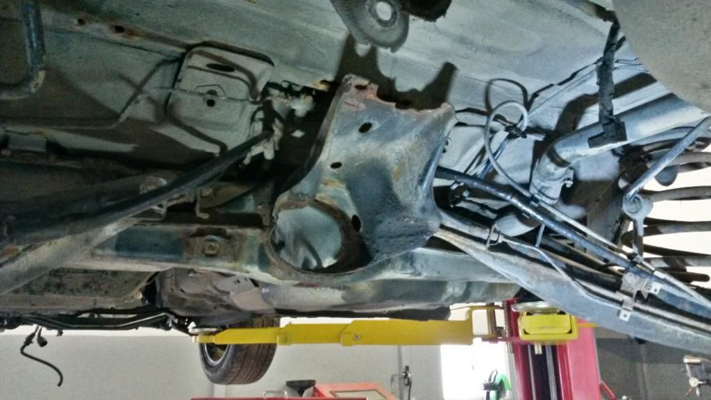

Still waiting on parts to come in for the m42. I didn't get much done this weekend. Decided to completely tear down the car after finding a lot more rust and decay that I remembered. This project is going to take a lot longer than I thought now. Found a surprise when I pulled the diff:
I knew it had been "clunking" quite a bit more than usual right before I retired it last spring.
