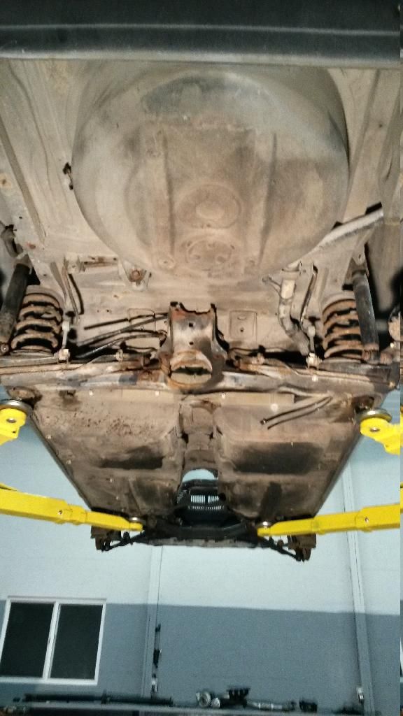

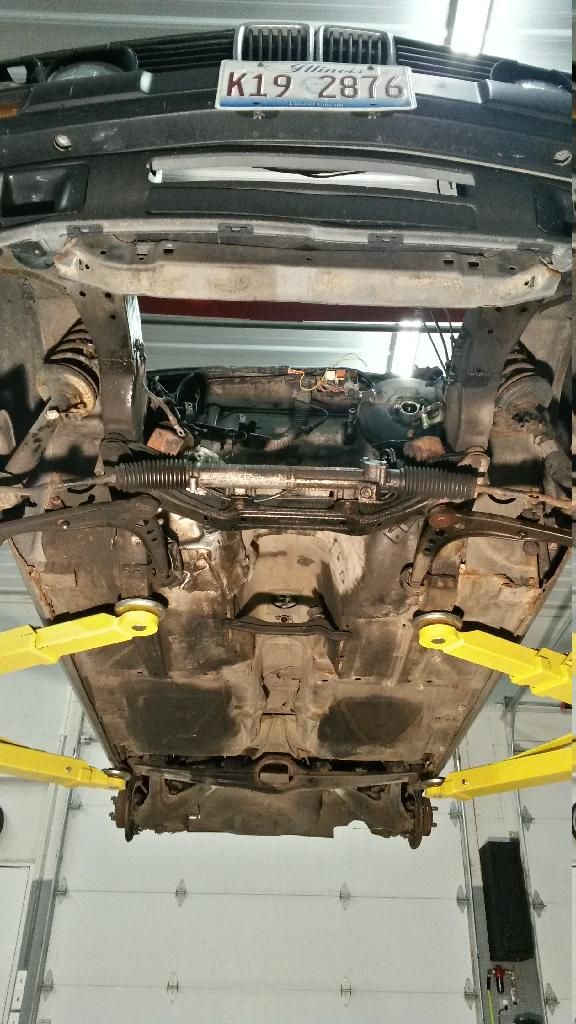

« Reply #47 on: January 23, 2014, 08:34:43 PM »
Started tearing out the rest of the underside tonight.

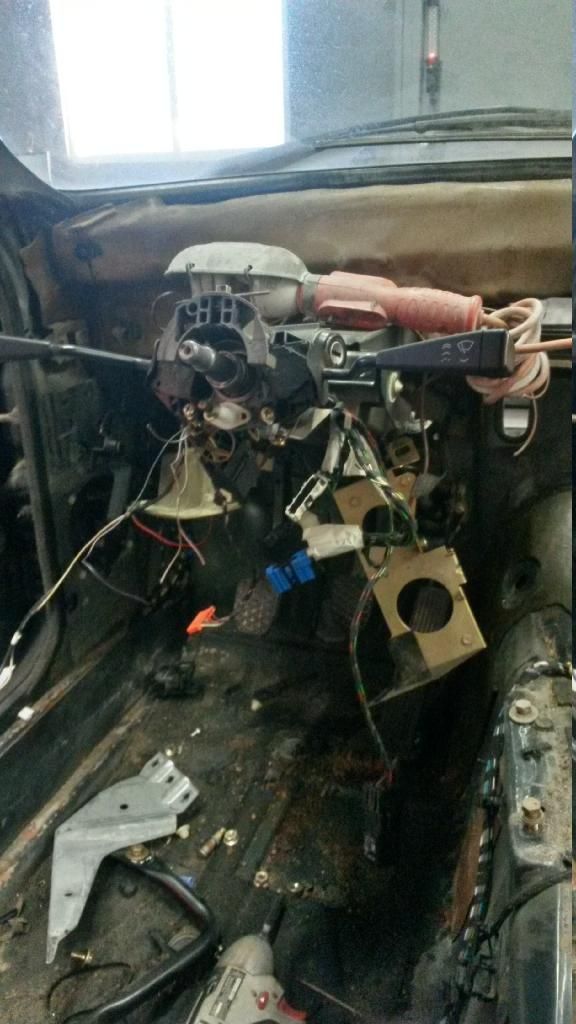

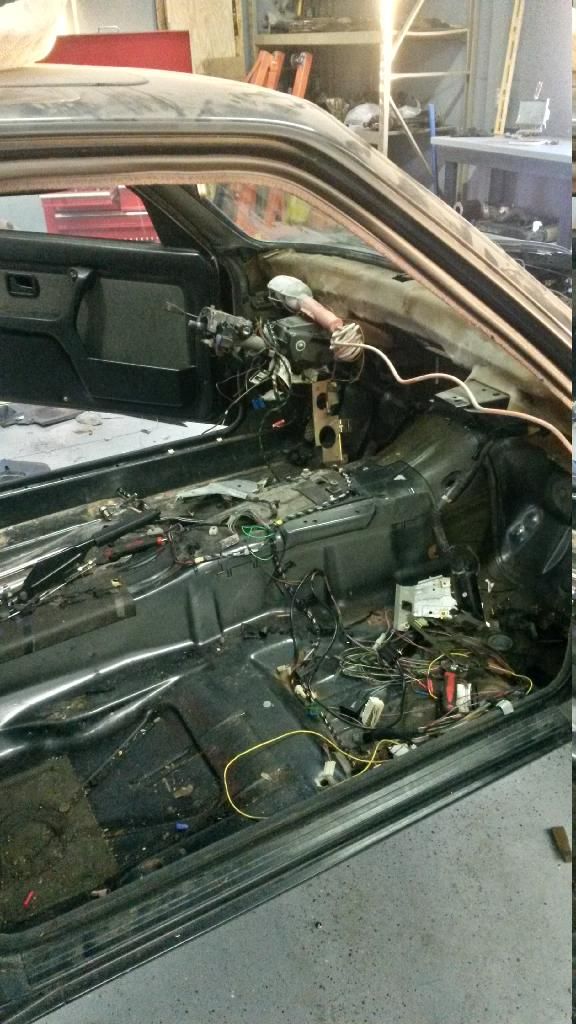

« Reply #56 on: January 25, 2014, 11:48:38 PM »
Looks like the inside of my car not too long ago! It was a relief when it all went back together.

« Reply #57 on: January 26, 2014, 08:46:30 AM »
Yeah, its a mess right now! Today I am going to sort the wires.  I dumped that huge HVAC unit and associated pieces, speakers, radio, ABS, SRS, and any other meaningless pieces. So, that should make putting things back together a bit easier.
I need to find new carpet as mine is TRASH!
Also, it appears my heater core was leaking into the drivers side floor pan as the carpet was a bit wet by the pedals. The car has been in storage for about 5 or 6 months so no rain water... Oh, and no I wasn't going to smell it to find out if it was radiator fluid 23 years of nastiness on that carpet.

« Reply #58 on: January 27, 2014, 10:48:45 AM »
Funny, I did the same thing. I put the HVAC back in though, but removed the heater core so its just a fan now. My heater core was also leaking from the valve into the drivers floor :(
Its amazing how much room there is without all the extra modules. I removed all the excess wiring too!
-Nick
