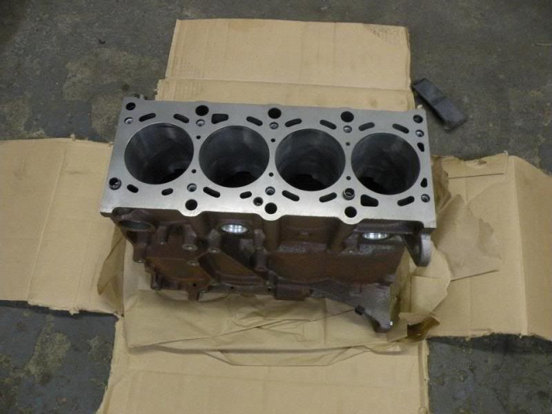

« Reply #7 on: May 06, 2014, 06:56:51 PM »

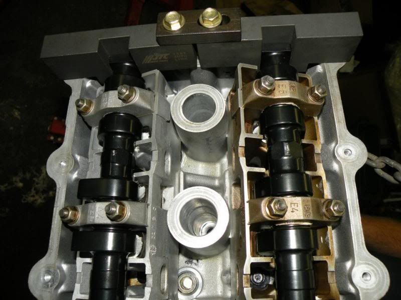

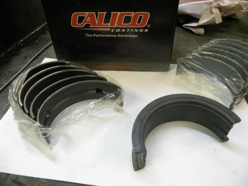

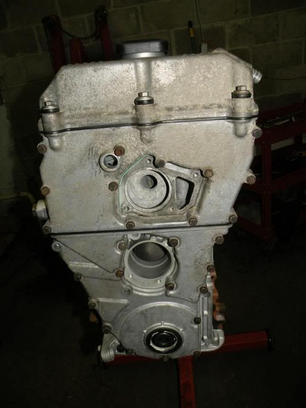

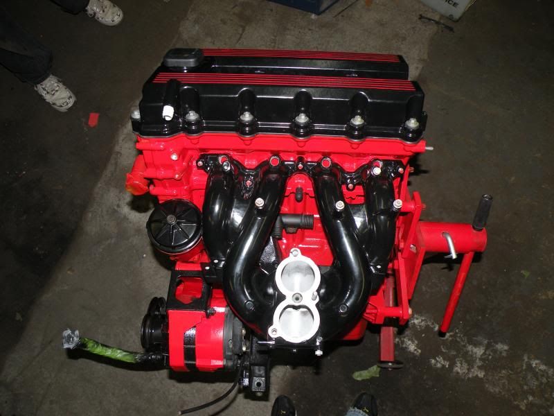

Here are the pics:

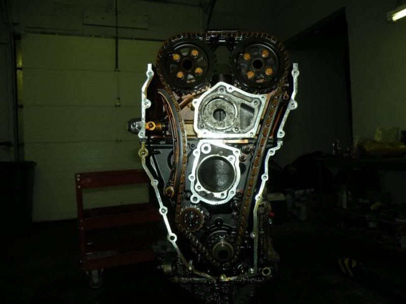

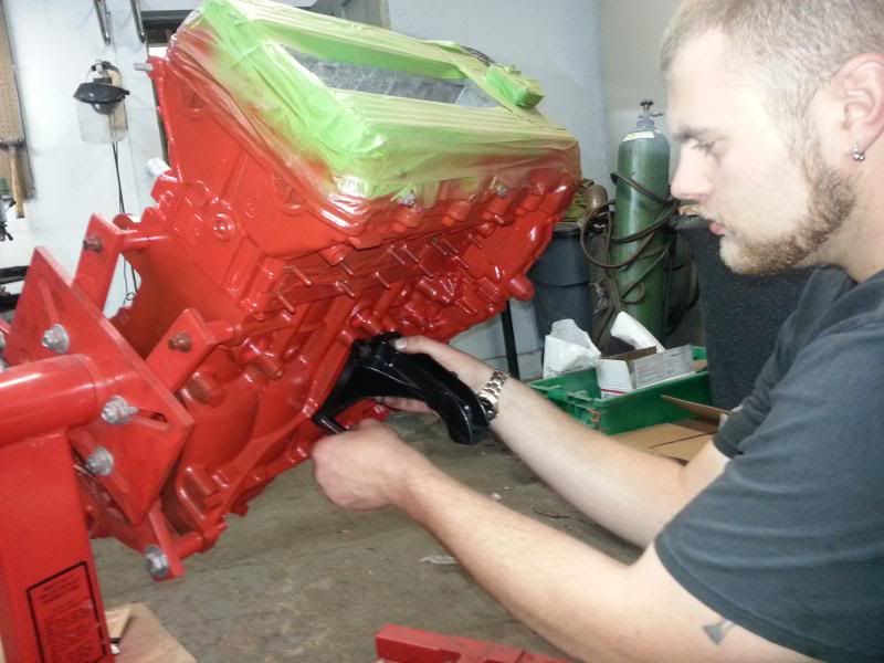

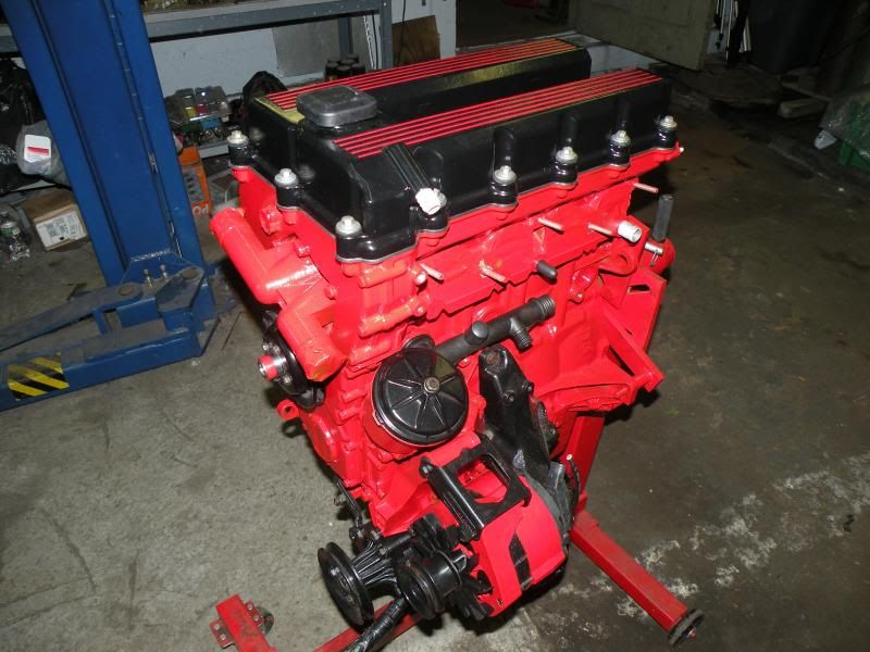

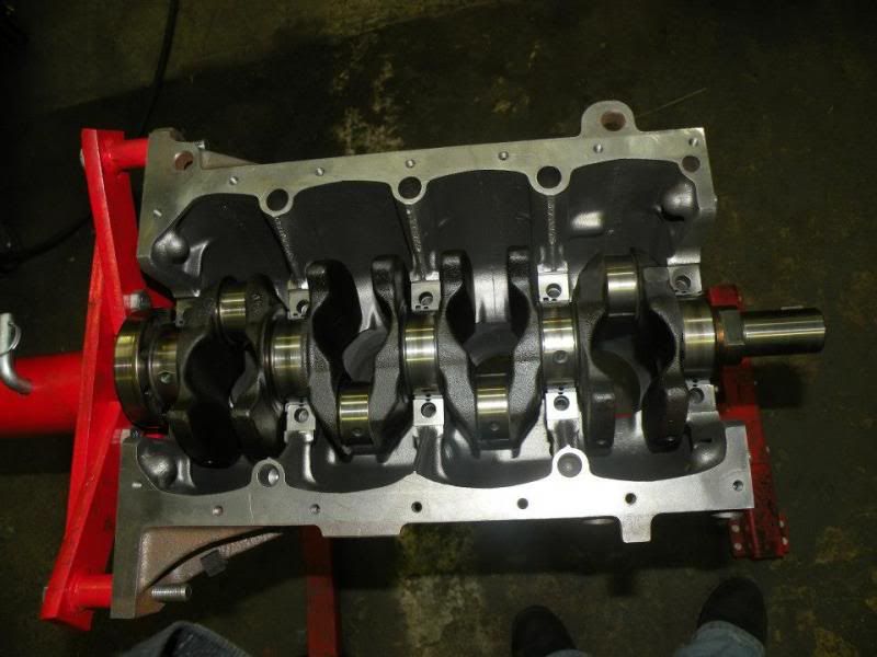

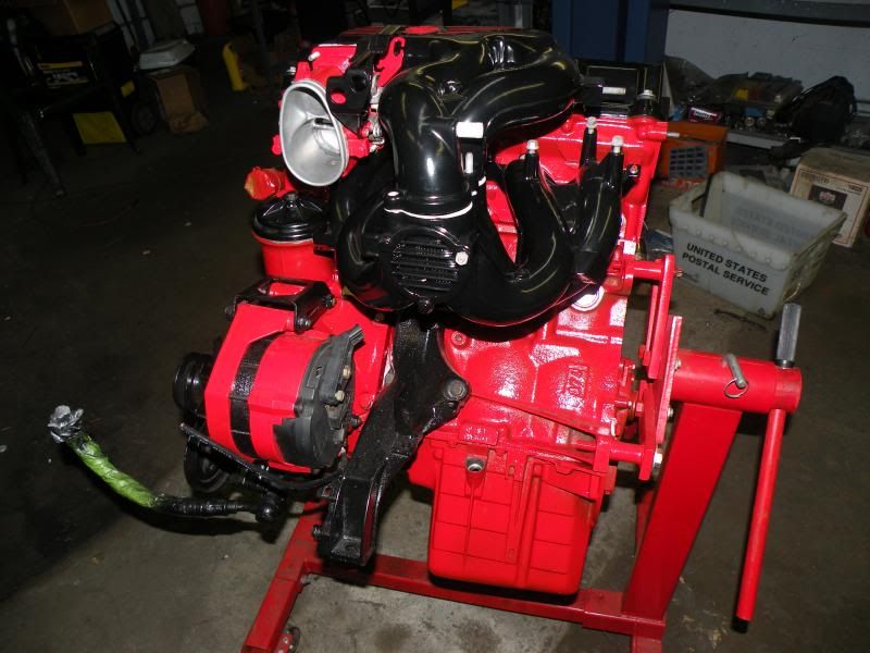

« Reply #8 on: May 06, 2014, 07:27:26 PM »

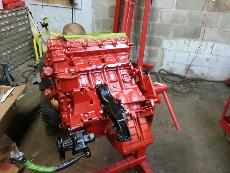

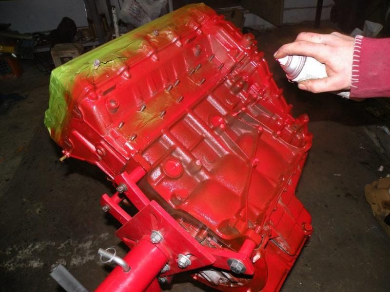

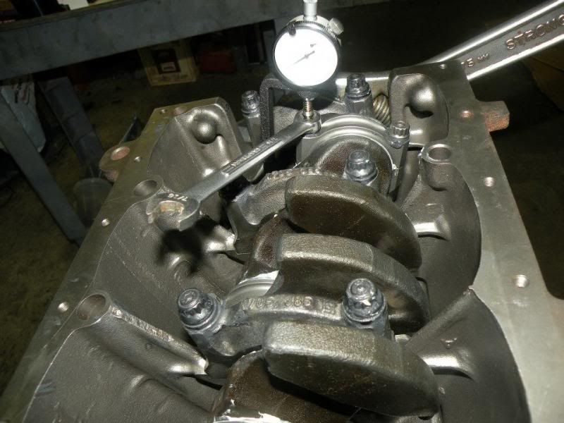

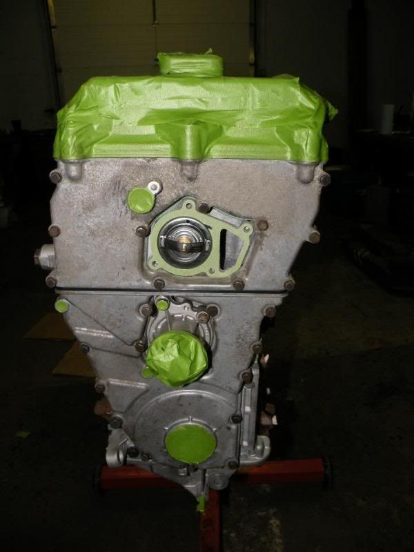

Finishing off the motor.

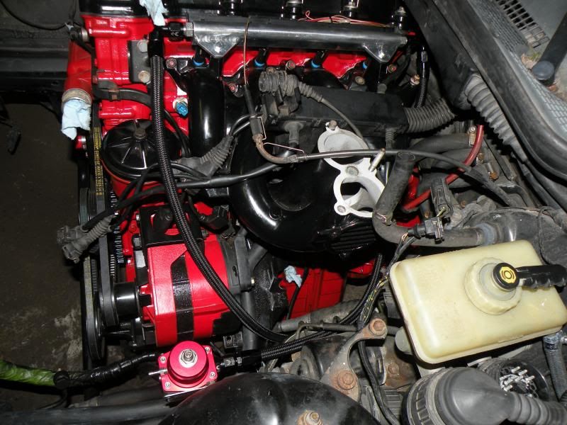

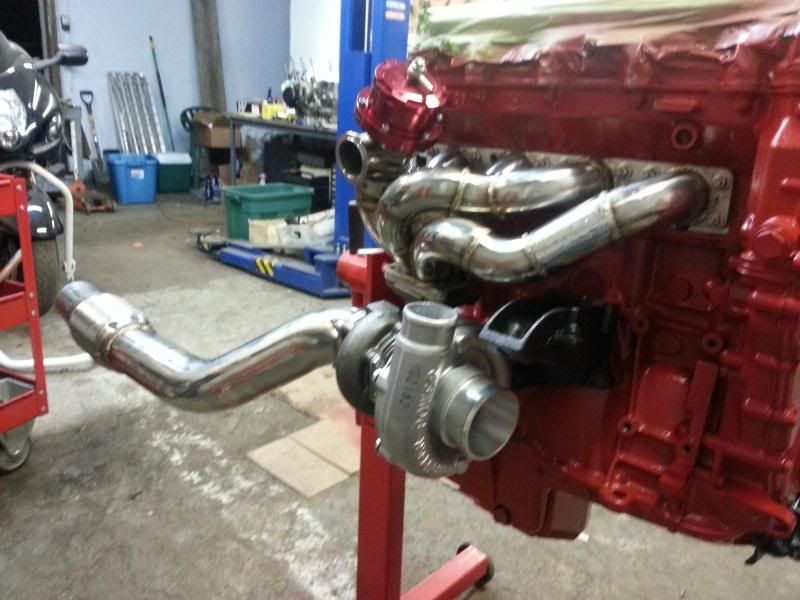

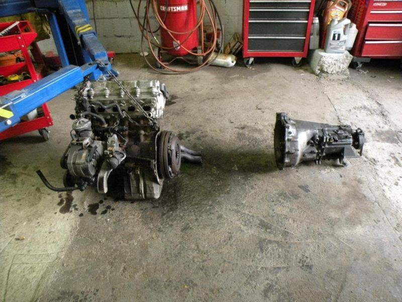

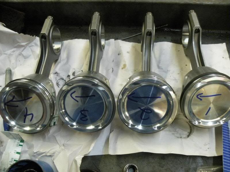

Darky
  • -Receive: 23
  • Posts: 630
Re: BMW E36 Turbo M42 Build
« Reply #9 on: May 07, 2014, 01:45:36 AM »

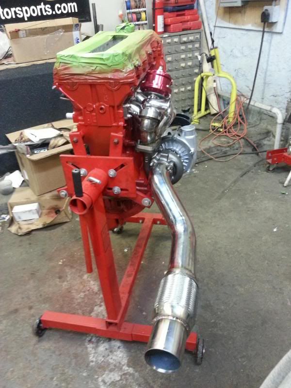

Nice work!
What size pistons did you use? Did you change the crank?

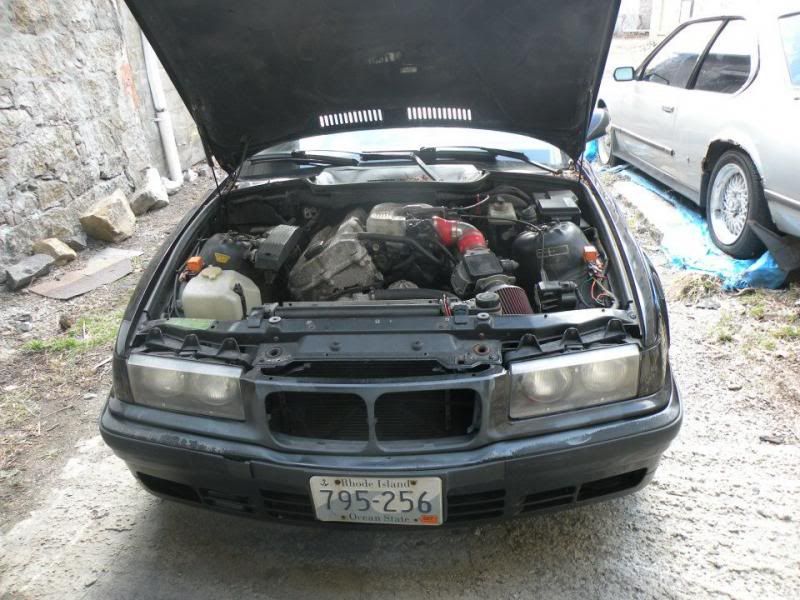

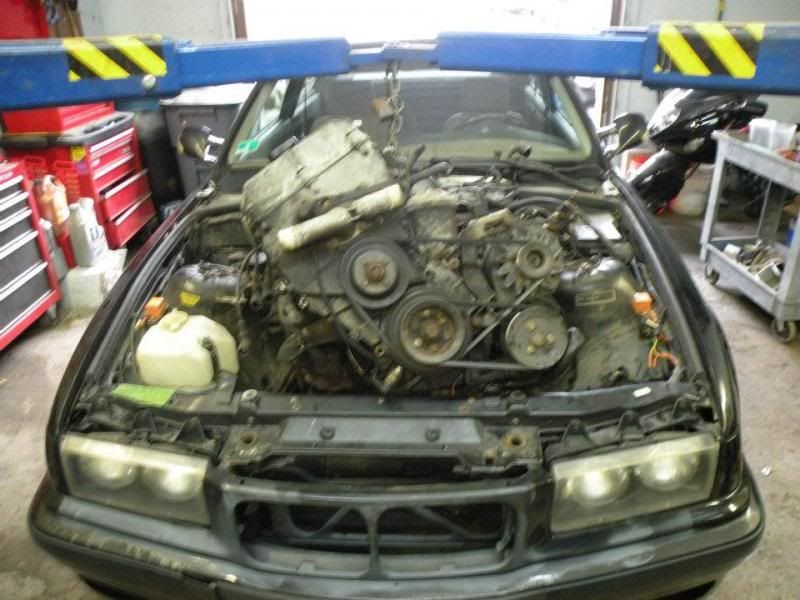

Massive turbo manifold!
Must be early e36, no serpentine v belt. I thought all e36 m42 had the v belt. That looks like one out of an e30?
Cheers
RuthlessPerformance
  • Posts: 21
    • Ruthless Performance Motorsports
« Reply #10 on: May 07, 2014, 08:28:55 PM »

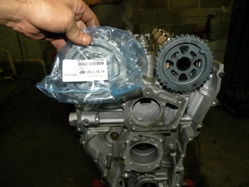

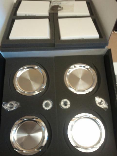

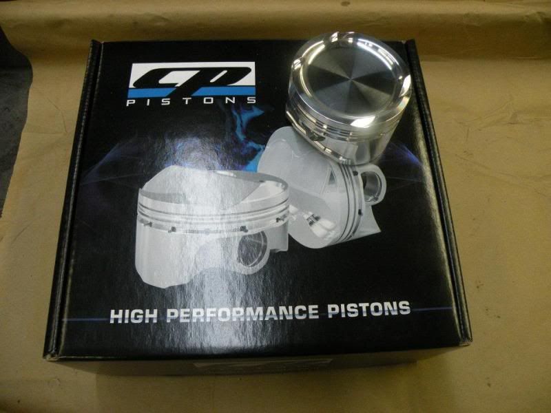

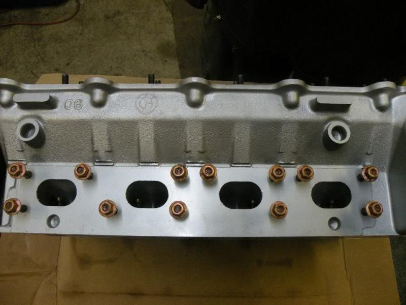

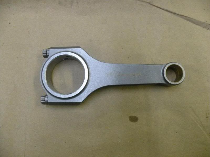

Thank you Darky!!!  They are 84.5 MM pistons.  I'll post some more pics.

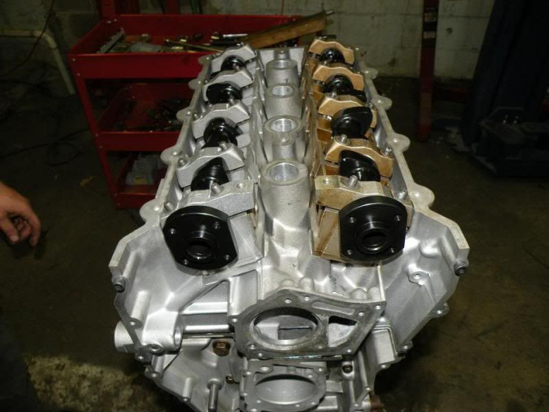

RuthlessPerformance
  • Posts: 21

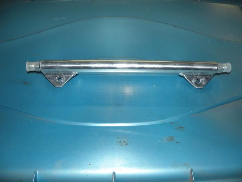

« Reply #11 on: May 07, 2014, 08:54:46 PM »
Joey
http://www.ruthlessperformancemotorsports.com/
"GOT BOOST?!?!?!?!?!?!"
RuthlessPerformance
  • Posts: 21

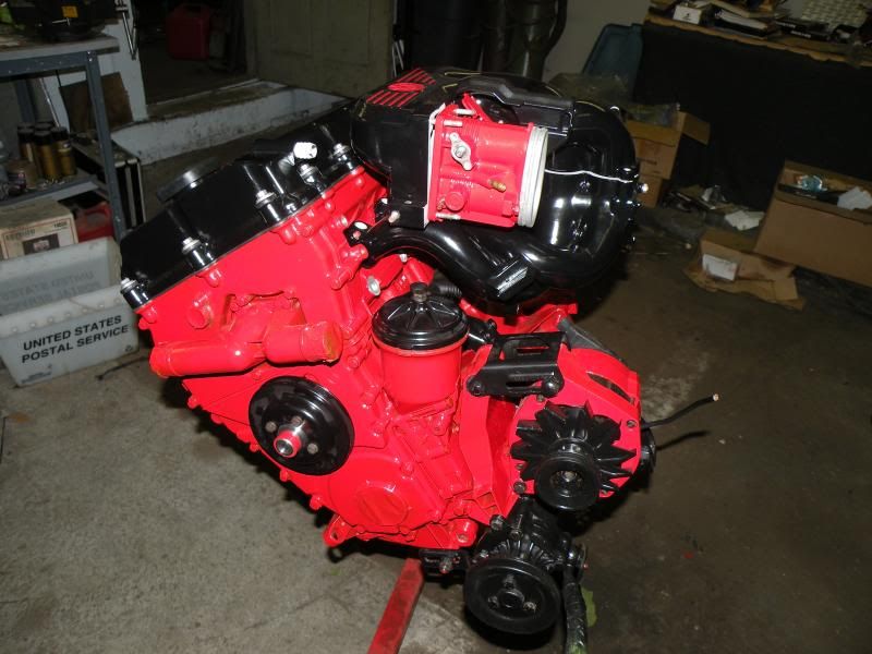

« Reply #12 on: May 07, 2014, 08:55:49 PM »

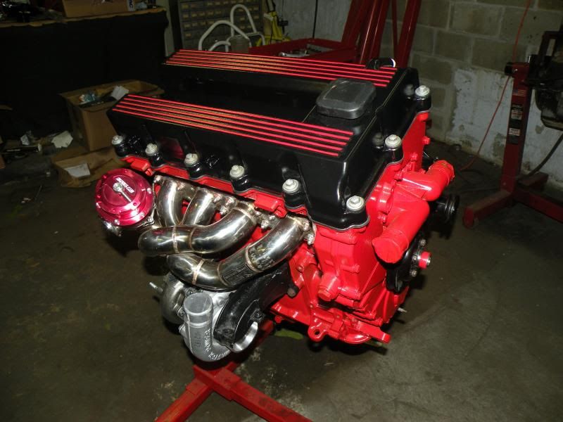

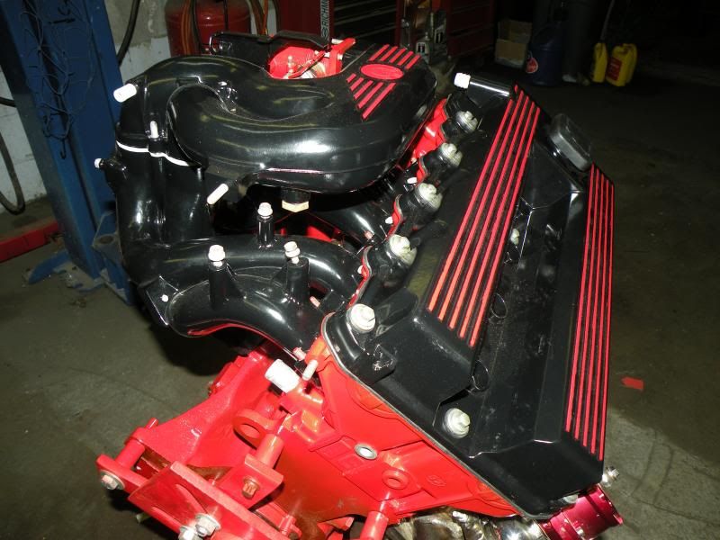

Powder Coating came out nice I think.  ;D

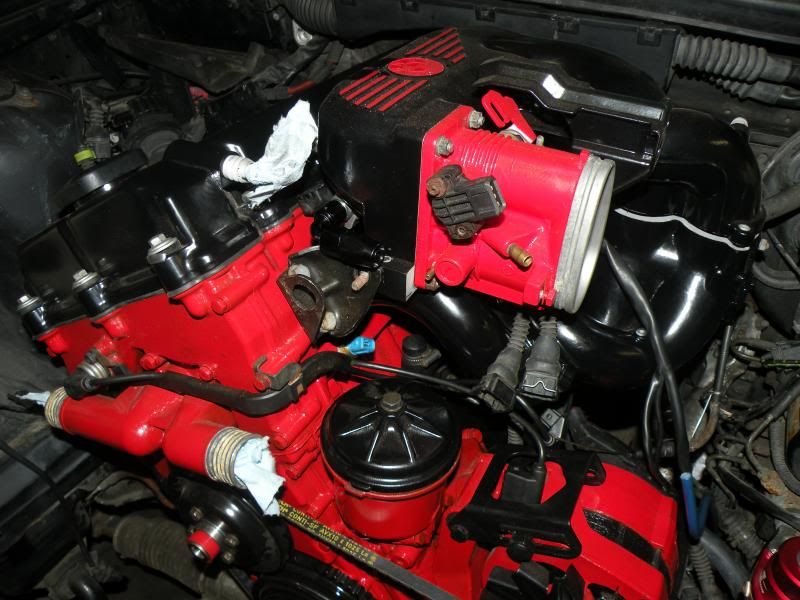

RuthlessPerformance
  • Posts: 21

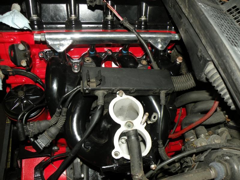

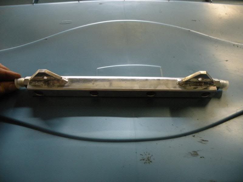

« Reply #13 on: May 07, 2014, 09:09:35 PM »

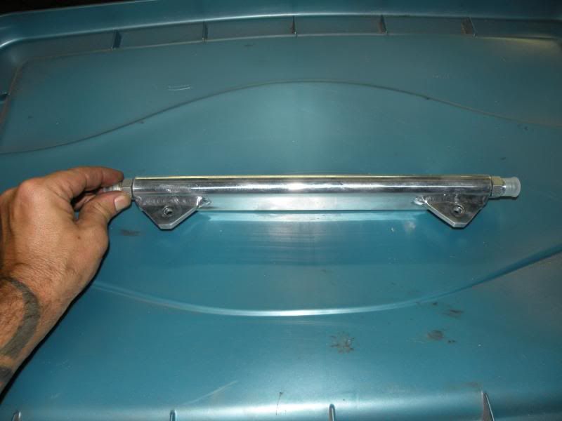

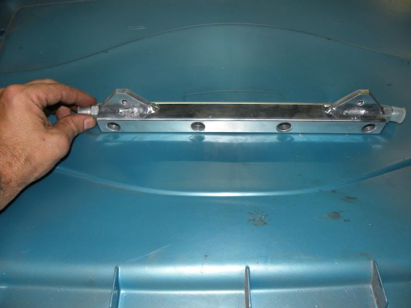

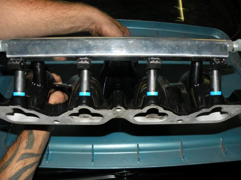

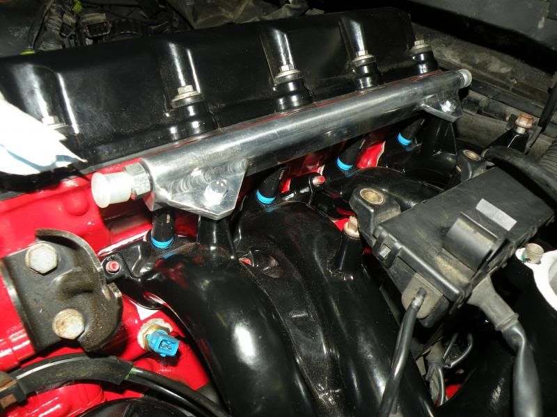

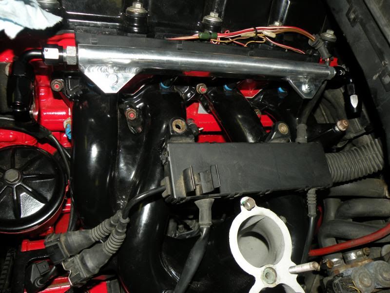

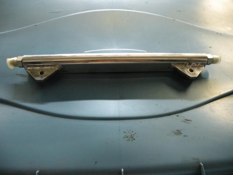

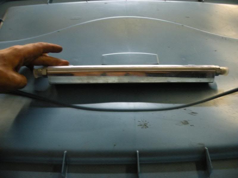

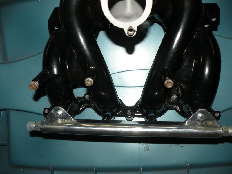

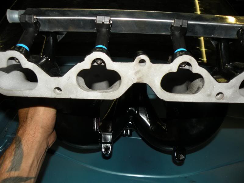

I choose to retain the stock intake, as it will flow easily in excess of 500HP, but the longer runner design will kepp the torque numbers nice for city driving. But I came to a problem, as no one makes a billet fuel rail for the stock M42 intake manifold. So we had to build a gig and make a fuel rail ourselves. We actually made 5 just in case other people needed them. The Billet Fuel Rail looks and works great, nice fit. Not sure, but we are considering powder coating it black, not sure, but I think it should be black, made even anodized?  Well here it is:

« Reply #14 on: May 08, 2014, 08:36:22 AM »
The Motor did come out of an E30 donor car.
