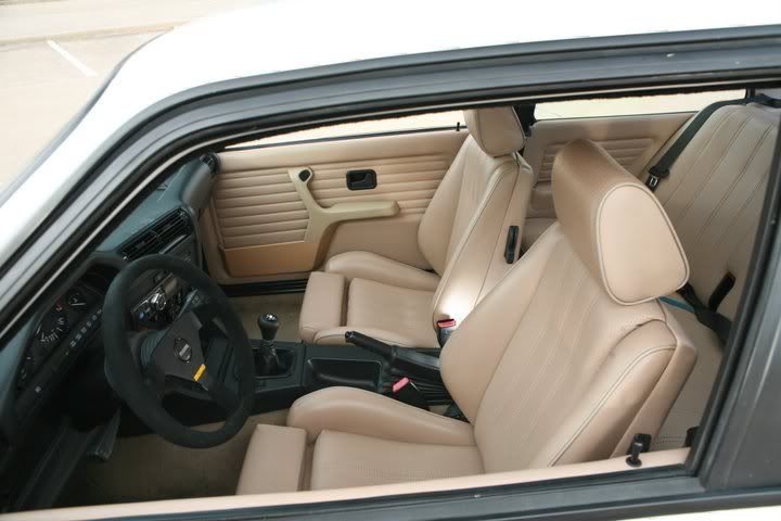

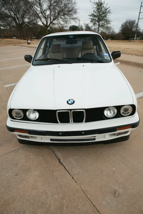

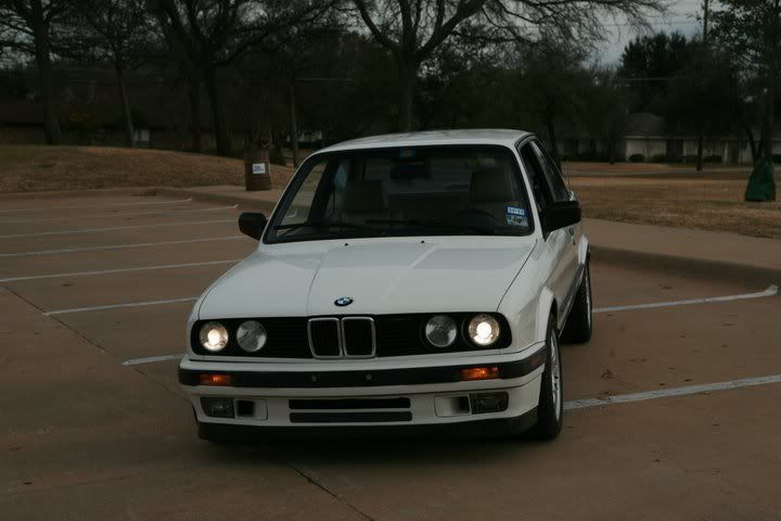

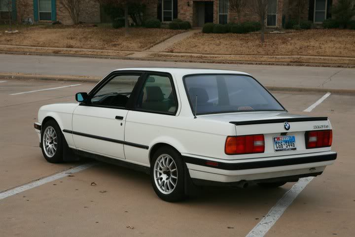

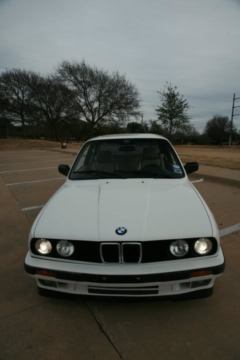

updated pictures of the car/paint now that everything is clean...
