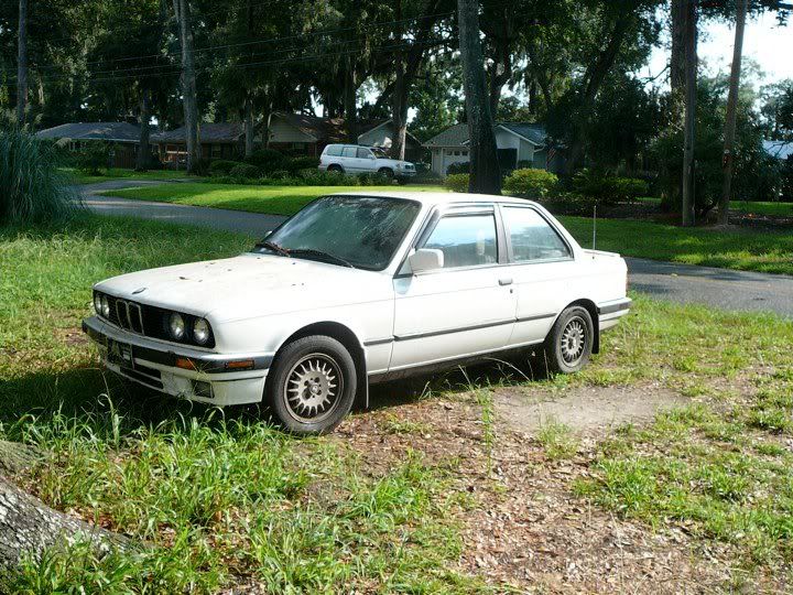

got a 318is with 120k miles on it for 460$$$, yup.... less than 500 bucks!!!
why did it cost so little? the motor was over heating, and the previous owner did not want to spend any money on the car, they just wanted to get rid of it and recover what money they could....

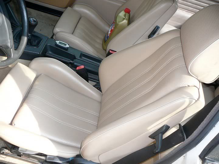

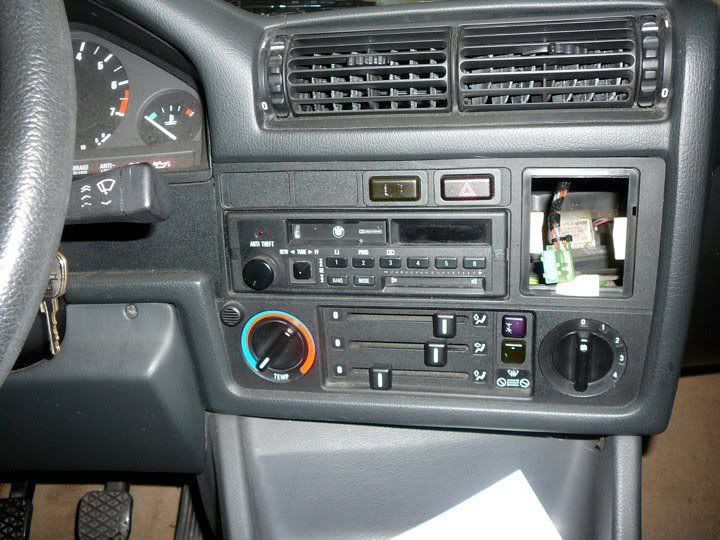

and the interior, as it was when the car was picked up
i would NEVER have imagined that the interior of this car would look like THAT....
but not all the interior is perfect... :(
the dash has 3 large cracks in it... already have a new one on the way... and have a few auctions on ebay I'm watching for the switches and the OBC....

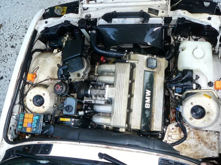

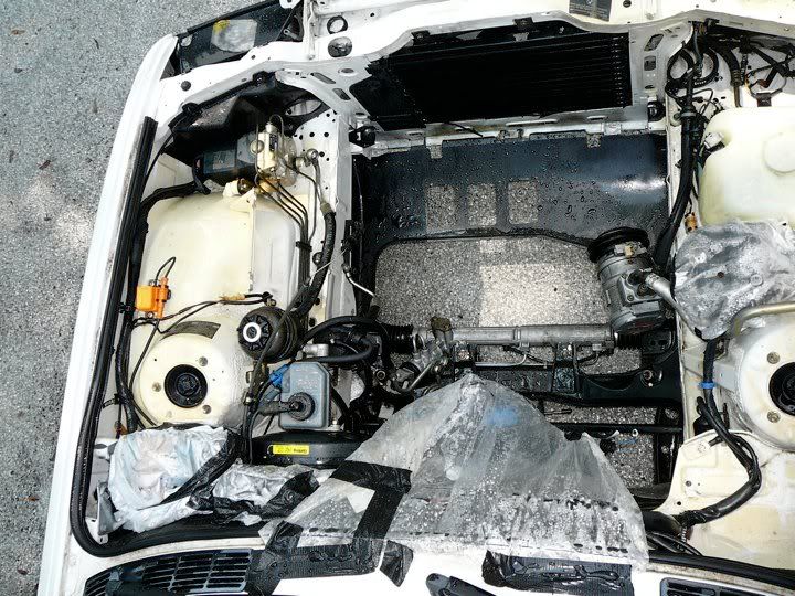

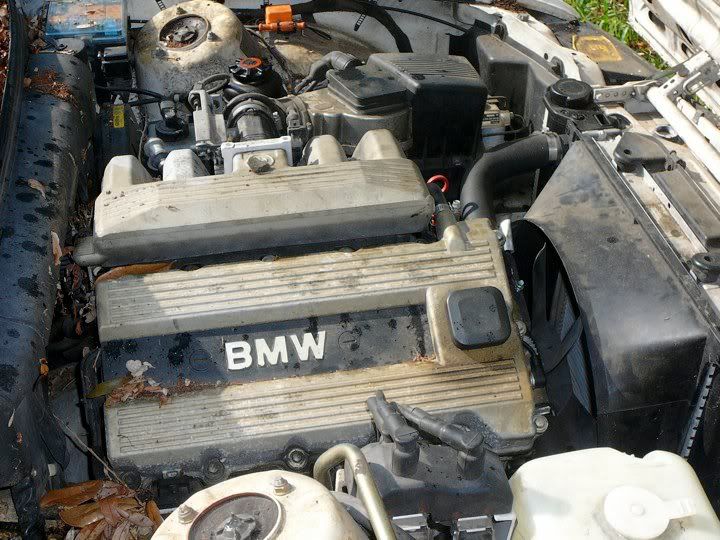

And what did the engine bay look like you ask?
there it is, in all of its glory...
and after a cleaning...
Now the fun begins....

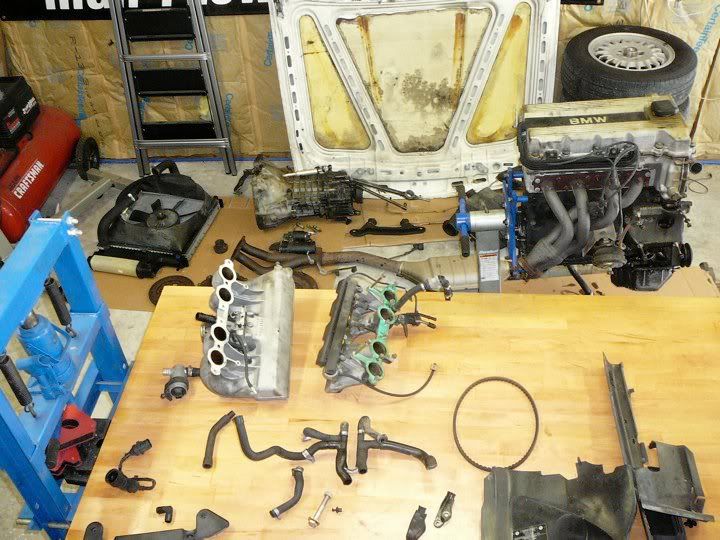

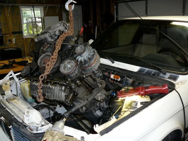

and after its out of the car?
WoW, Grease and slime?!?!?!?!
Not any more!!!

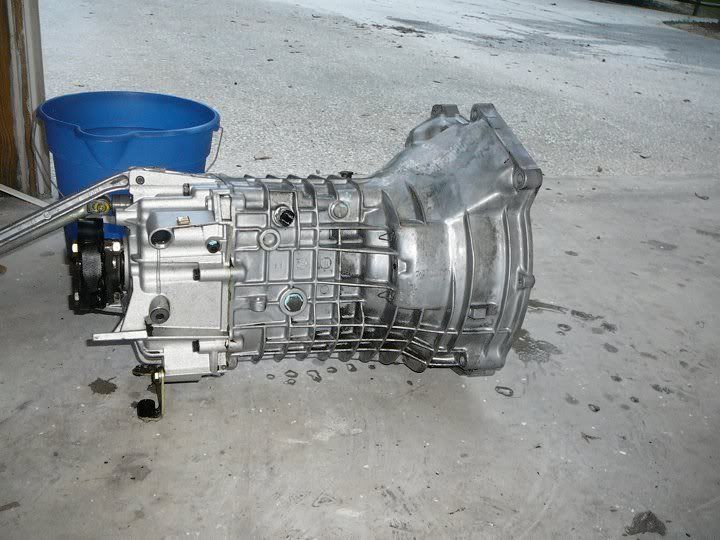

and the transmission???
yup it got cleaned also!
all the drive train in its temporary home..
and now the engine bay is pretty clean now that everything is accessible!!

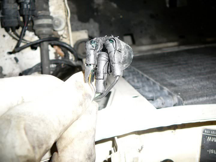

And, now that everything is out of the car, for 19 year old parts, there was only 1 casualty...

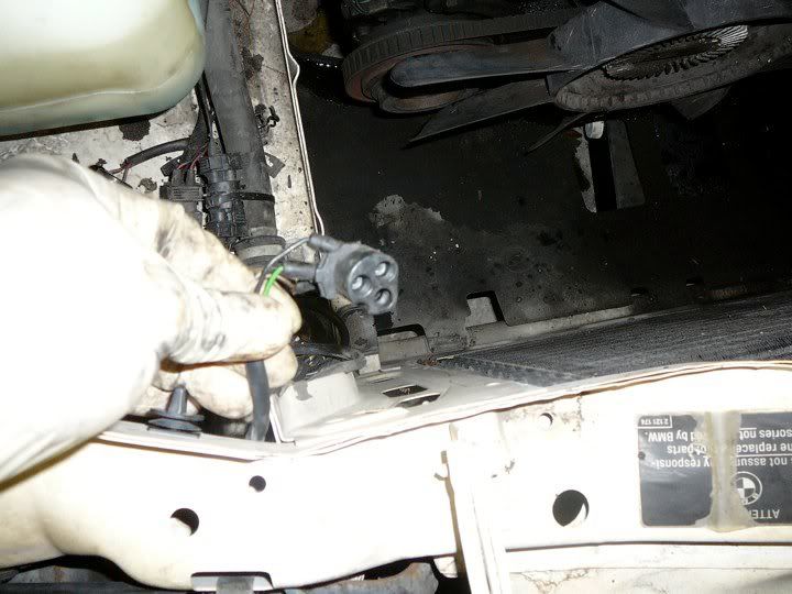

this is the aux fan temp switch that goes into the radiator on the passengers side.  I am currently trying to find a replacement for the connectors, and not having much luck... does anyone have any advice??? i would REALLY appreciate it....

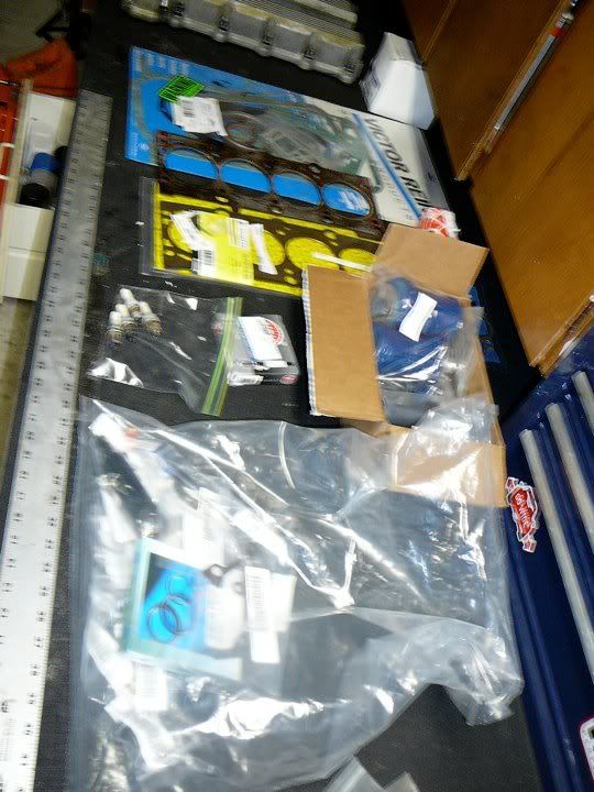

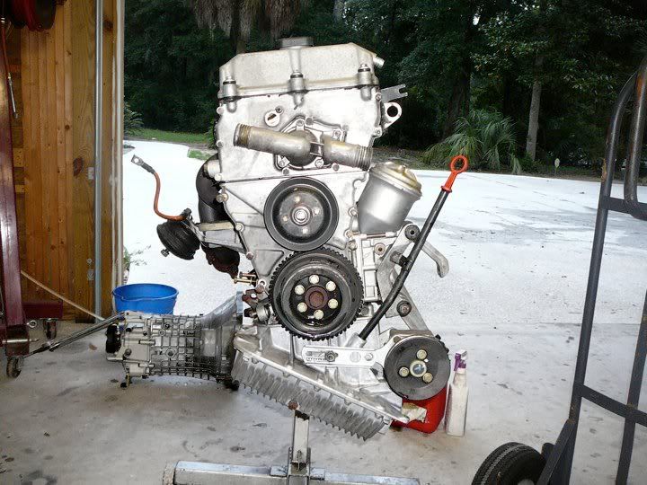

the motor is waiting for all the gaskets to arrive, EVERY gasket in the motor with the exception of the head gasket is being replaced, we ordered a new head gasket, but it seems like everything with the head gasket is fine, and don't really want to take the head off when everything seems ok, and it doesn't seem like doing a head gasket on this car would be that hard with the motor in the car incase it does need to be done at a later date, the thermostat and water pump will also be replaced while were at it.

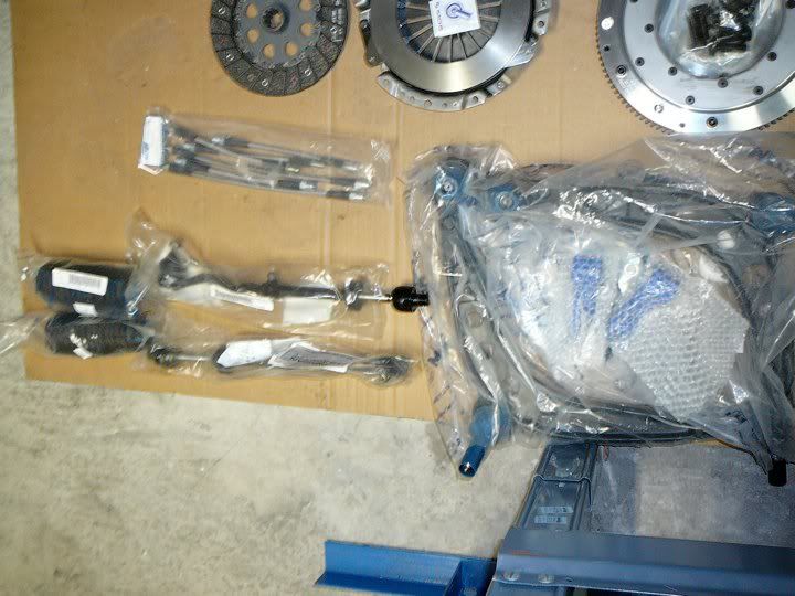

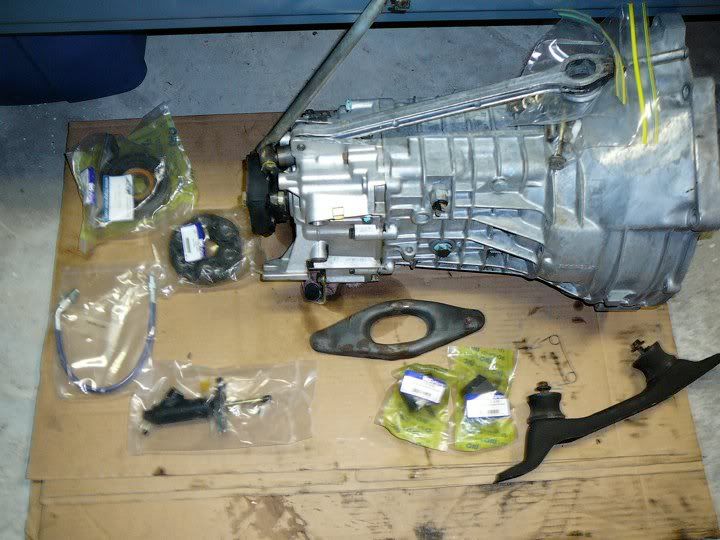

the clutch, will be a stock sachs and the flywheel I'm planning on is the JB racing flywheel from bimmerworld... 9lbs... stainless steel clutch line from UUC..

That's an awesome find.  The only one that's turned up around here has serious frame rust and torn seats.  I missed one for $650 a little while ago, also had some tears in the seats.
I found this for the connector & pigtails...Shogun is a legend for his 7-series stuff.
http://bimmerboard.com/forums/posts/811221
Quote
Part number: 61 13 1 378 410
old part number is  61 13 0 492 947
DIFFERENCE between old and new is:
old ones were for angled pins, the new one is for straight pins.
The angled pins do not fit into the new plug.
So besides the plug you also need new straight pins with cables.
I did the same. You anyway need new pins and cable.
Circular connector / D 2, 5 mm System
Round receptacle 2.5, watertight, there you can decide between:
61 13 0 007 441  0,5-1,0 MM
I used
61 13 0 007 442  1,0-2,5 MM

« Reply #4 on: August 22, 2010, 09:36:51 PM »
i just grabbed that plug from a you pull it and spliced it in.

ordered this
a pair of these
sachs clutch kit  from bav
also ordered new front end grills, and hood cowl grills. Also got tie rods.
called autosolutions, ordered a ultimate shift kit, but he has to manufacture one for me, and that will not be done until the 3rd.... so the drive train might be complete minus the shifter this weekend, depending on how the motor tear down, reassembly goes.

Any troubleshooting for why its been overheating?
Looks like most of the oil is coming from the valve cover and timing covers. My personal favorite that I've witnessed people getting rid of the car for is the oil filter housing o-ring. It's like a $1 part and leaks like a sieve cause it's under pressure.
As for the fan switch I just used one from an earlier model with blade connectors. I've wired in a high speed spal 13" fan to the high speed circuit. It turns on at lower temp, and removed both factory fans.

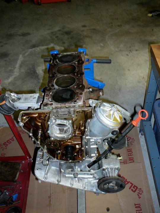

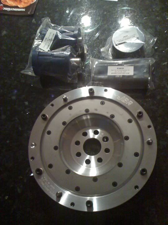

some of which were the poly bushings from AKG, and the lightweight flywheel from Bimmerworld!..

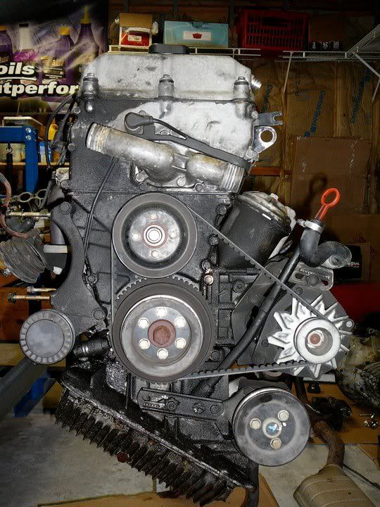

now the fun with the motor begins...

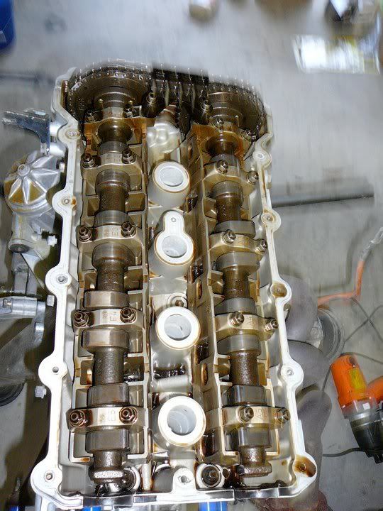

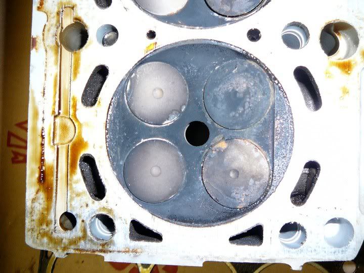

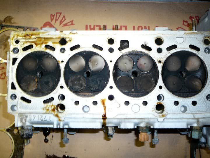

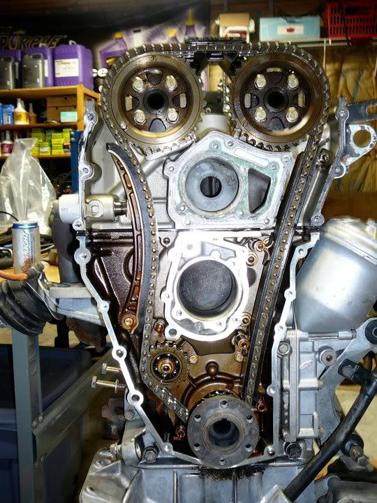

I ordered new chain guides, and come to find out, the ones in the motor are still in pretty good condition, but 19 year old plastic..... i think i would rather have new guides in there for the cost, and  the Very little extra work at this point.

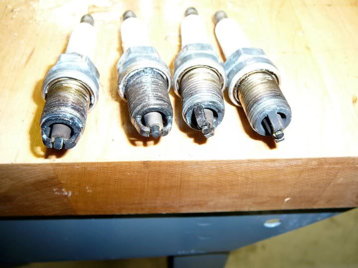

original spark plugs?
my money is on yes....

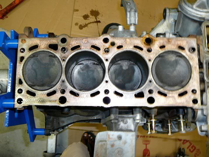

cams looked good...
pistons, no holes, and everything still has a nice fit. No scoring on the cylinder walls.
no bent valves...
so, we are not going to be replacing any valves, or pistons. Just gaskets.. we will be cleaning everything up though.
took about an hour to break down the motor, now all the back order stuff needs to arrive, so that we can start putting everything back together.

a mini update.
the motor as it sits right now
Transmission with parts

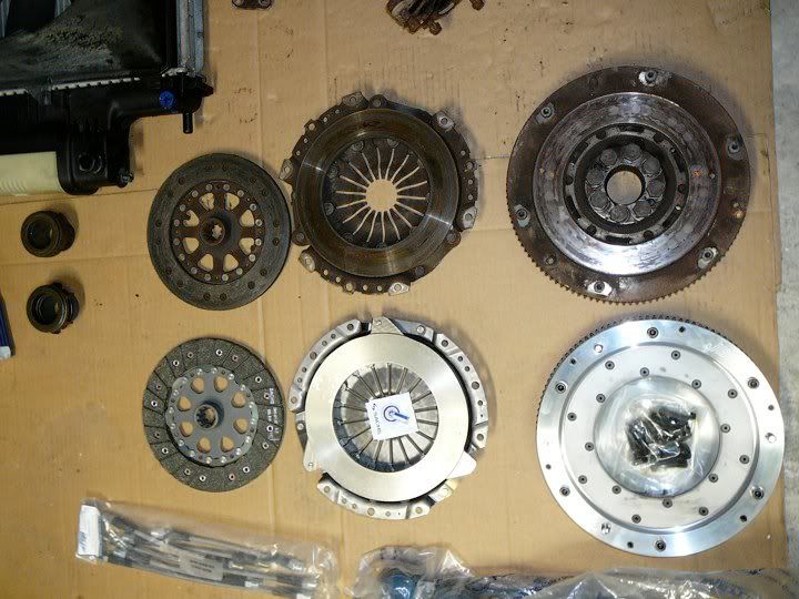

Old clutch and flywheel with the new.
Some suspension stuff
Some more suspension stuff and other random parts.

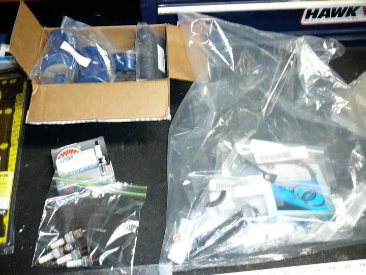

New motor gaskets~!
Table of a lot of new stuff for the car.!

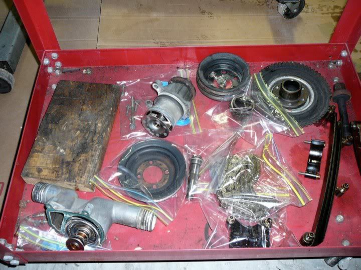

Stuff that came out of the motor

I recommend you to replace hydraulic lifters with new from VW. Imho marks on  cams show that they are not perfect.
P.S. do not forget about sump bolts.
