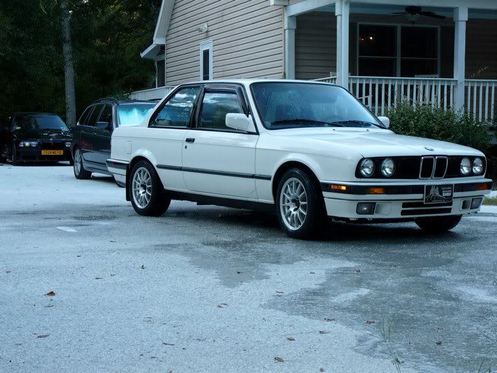

how come its idling so high? cold start?

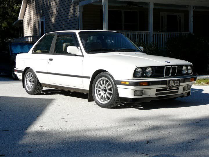

Awesome work!
Your car is a lot like mine (except I have black interior). You're also doing a lot of what I plan to do, just in a much smaller time frame, lol. Very motivating thread. Keep us posted! Car is looking great!

Finally get to drive it, nice! Looks great with those wheels.
Pivot pin was about gone in ours too. One of those less than a buck parts that gets forgotten on clutch jobs lol.
Just curious why didn't paint the block?

don't know, that was one of the first times the motor was started, the motor was ran for a little bit yesterday, and it did drop we didn't replace the idle control valve, we might do that?? but i would think the idle control valve would cause an erratic and not a dead solid value...
if anyone has any ideas, i would like to hear them.
we didn't have a media blaster, and cleaning the block would have taken to long.. the law of diminishing returns sets in pretty quick....

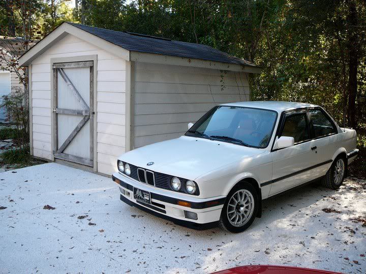

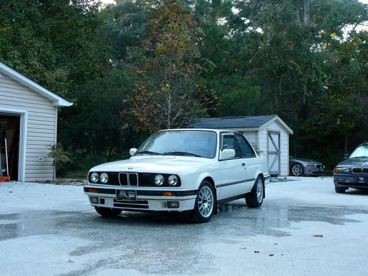

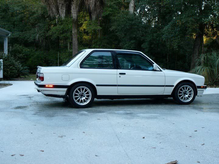

each rear spring got 2 15mm spring pad's in addition to the stock pads.

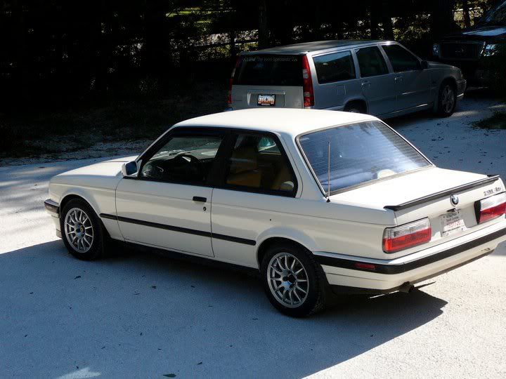

Claire, Dans wife took the car out on a shake down run today. She said the car is set up really good, suspension is just right... However she said i HAD to put a clutch stop in the car.. At which point i kindly told her that I put a clutch stop in the mail yesterday :D. She also said the car turned out much better than she though that it would.

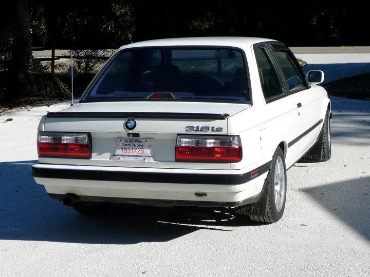

oh and the tail lights are 50$ fleebay specials, though i would try them out, i will most likely be going with OEM ones, or something of that sort.

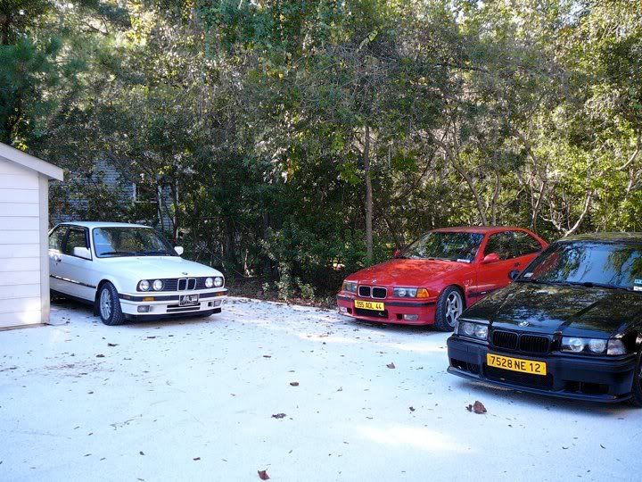

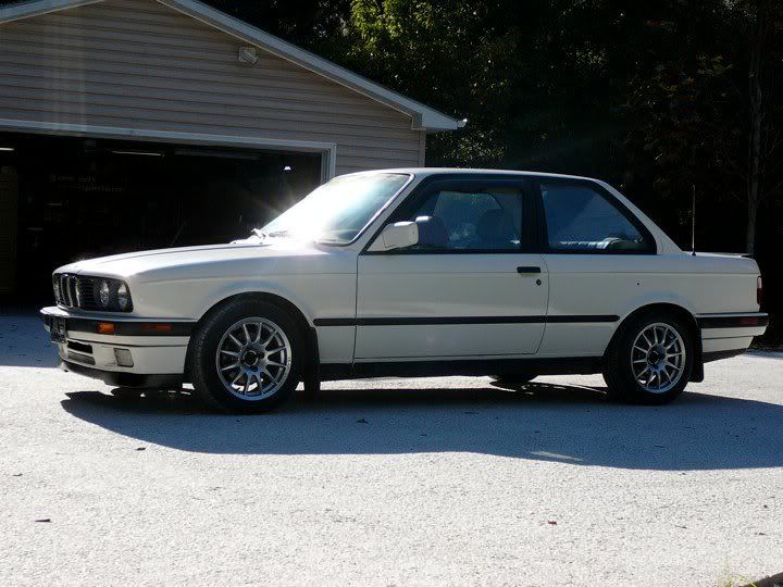

Here is the 318, next to the 2 race cars, S52 swapped 318ti's... the 318 was pretty Damn close to getting an S52, but in the end i think the M42 will be just fine...
