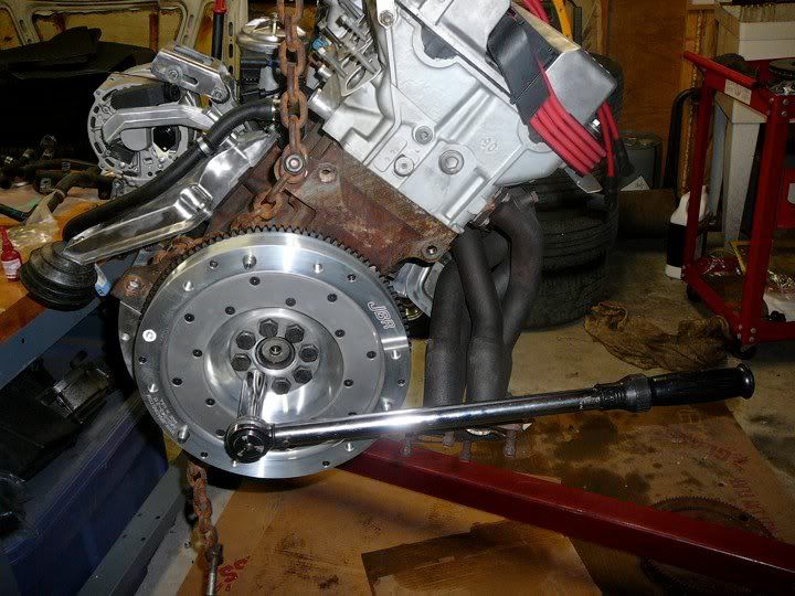

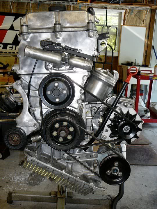

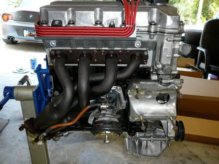

Danny got the motor put the rest of the way together...

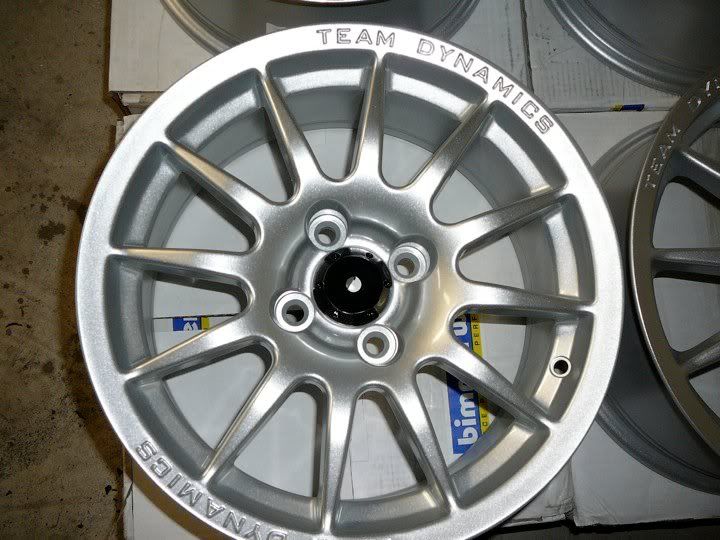

And the wheels came in today, cant wait to see how these look on the car but that will have to wait a few weeks for Danny to get the suspension work sorted.

pro race 2.1 rims?
I've them in white ;-)

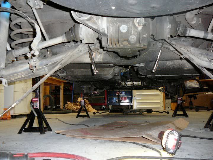

Dan started on the chassis today.
He also had some time to get the tires mounted:D
And this is the progress from this morning.

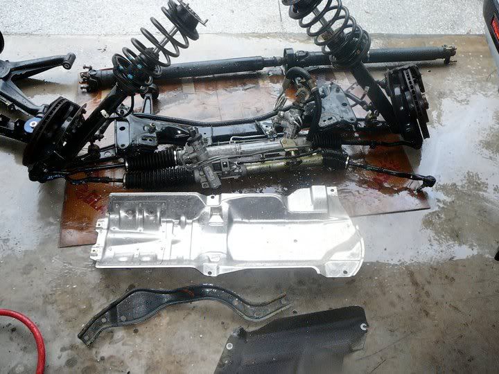

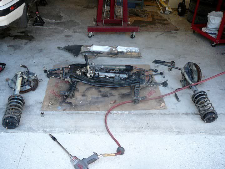

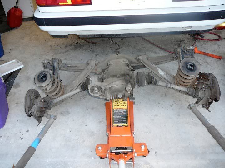

Rear subframe waiting to be torn apart and then put back together with all new parts....
Front subframe waiting for it's Z3 rack, new suspension and brakes.
How the shell is sitting now...:cool:

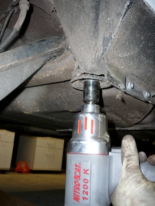

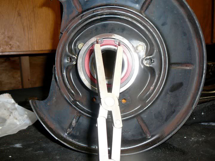

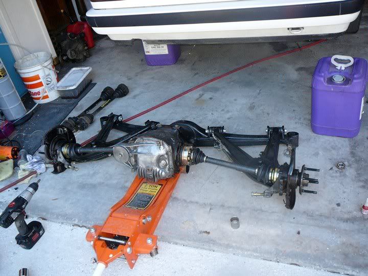

The subframe got some more attention today...

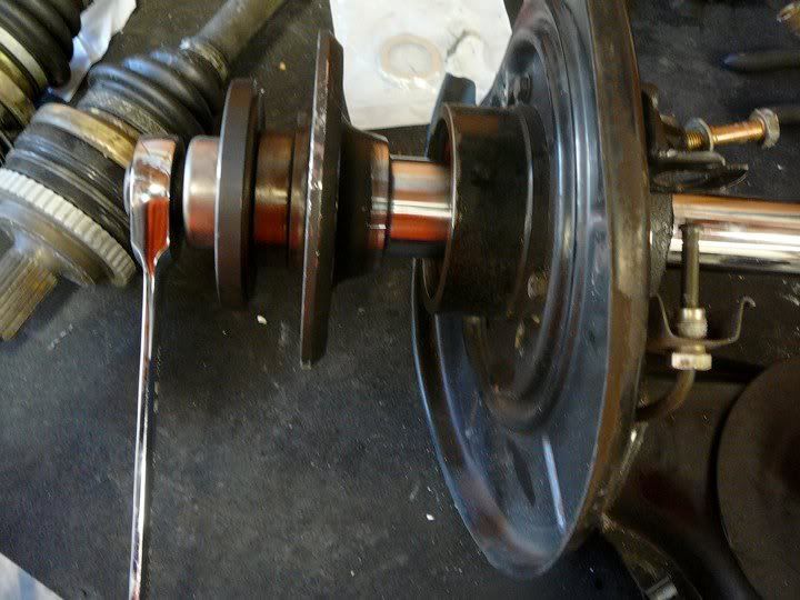

Did both rear wheel bearings.

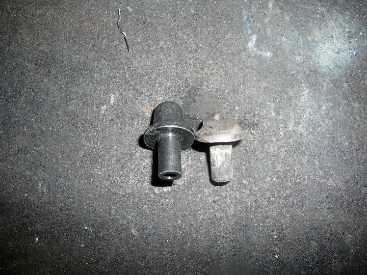

Got the bushings done, this is the way dan had to get the control arm bushing out.
and everything got a quick wash with the power washer.
« Last Edit: October 10, 2010, 08:12:37 PM by dakon »

Where did you get the rims and what size?

The subframe got some more love today.....
Now press the new bearings in, reassemble and reinstall........
« Last Edit: October 10, 2010, 08:11:56 PM by dakon »

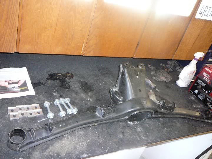

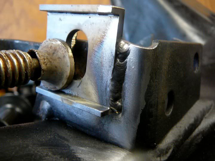

« Reply #37 on: October 03, 2010, 03:13:13 AM »

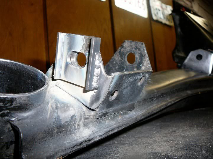

I'm a little confused on the camber/castor plates.  It looks like in the last pic that it is set for toe and not camber?  I could be way off base, but was just wondering.
Tell your boy he does nice welds too.

« Reply #39 on: October 03, 2010, 11:26:17 AM »
Quote from: longtallsally;97087
there are adjustments for both toe and camber, one on each side..
here is a DIY for the kit.
http://www.s14.net/forums/showthread.php?t=21310
i only posted 2 photo's because it seemed like a lot of the e30 guys know what it is and how to do it already... so a "how to" article was not in order..

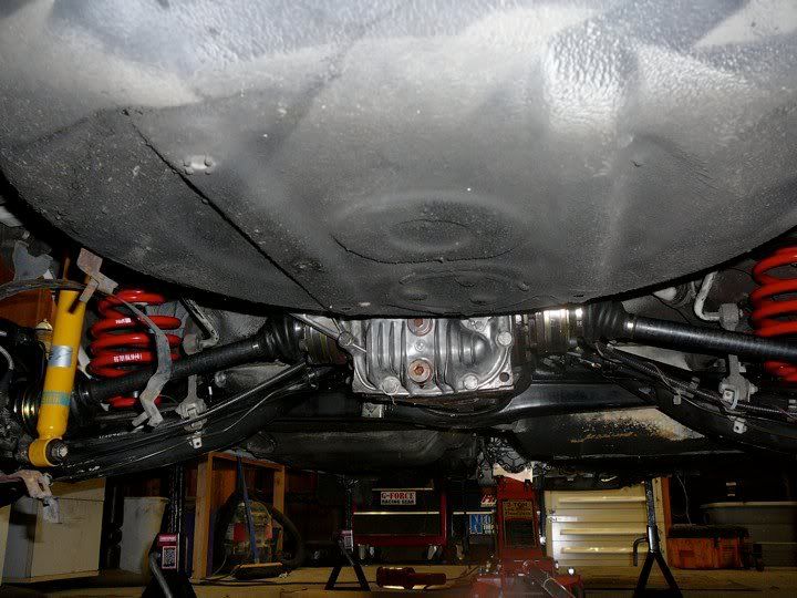

« Reply #41 on: October 08, 2010, 01:17:29 PM »

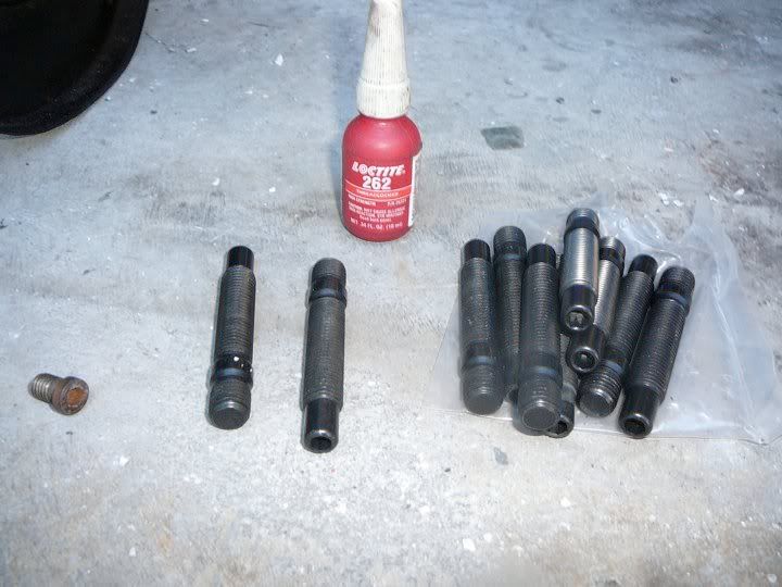

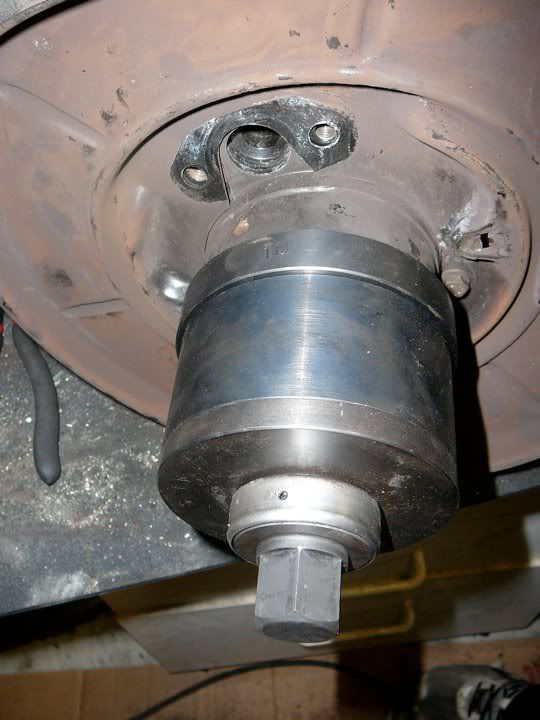

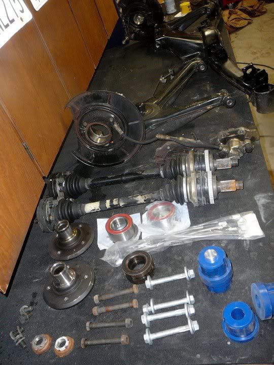

pressing the wheels bearings in... the wheel bearing tool for the E30, is totally worth its money....
wheel studs from bimmer world, i really wish these cars came with wheel studs from the factory!....

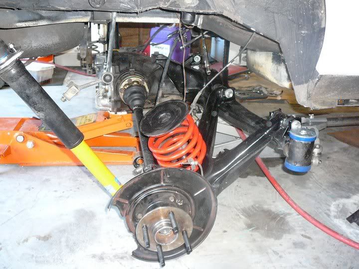

Subframe going together..

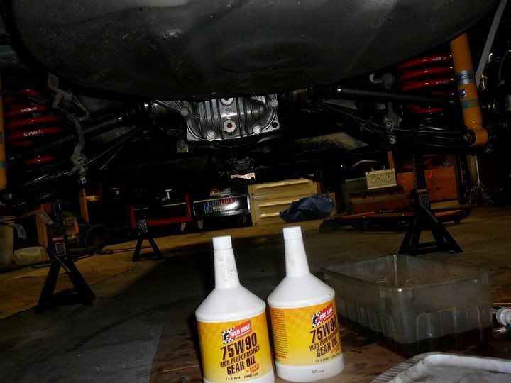

Dan decided the old half shafts weren't worth putting back in the car, so we got new ones. The subframe also received the 4.10lsd, H&R race springs and the bilsteins as well as all new polly bushings from AKG.
And now going in the car.....
« Last Edit: October 10, 2010, 08:11:12 PM by dakon »

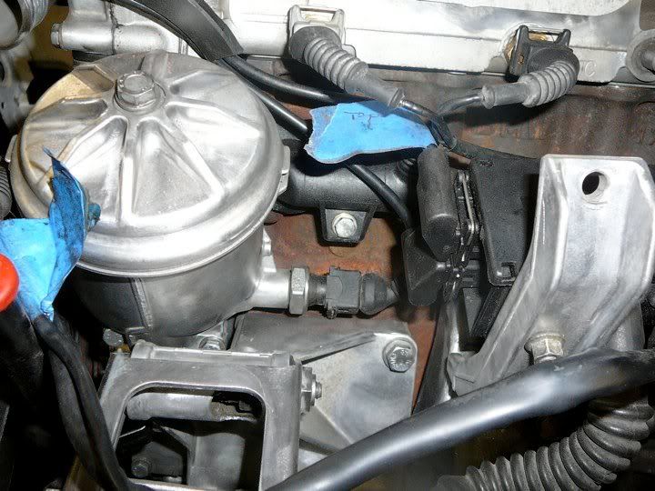

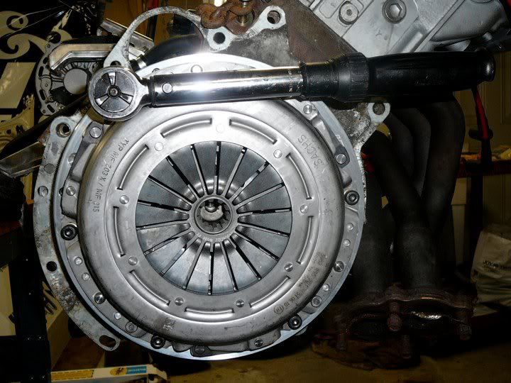

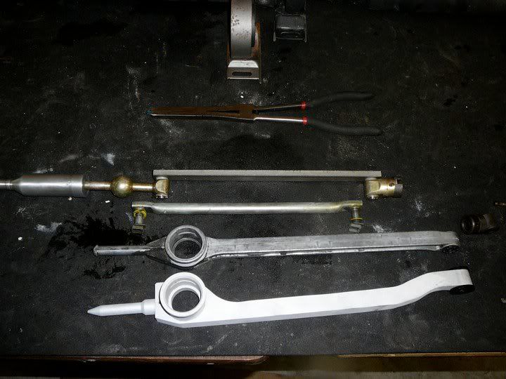

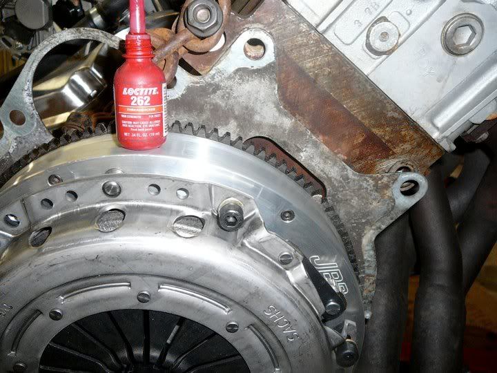

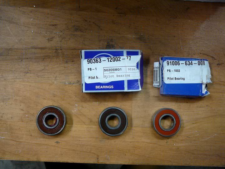

I ordered a full clutch kit from bav... They sent the wrong pilot bearing, so the motor had to chill on the cherry picker for a couple extra days......
the bearing bav sent is on the far right.....
the pivot pin was almost completely wore down.
now that the correct pilot bearing was in hand...

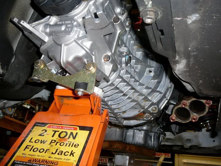

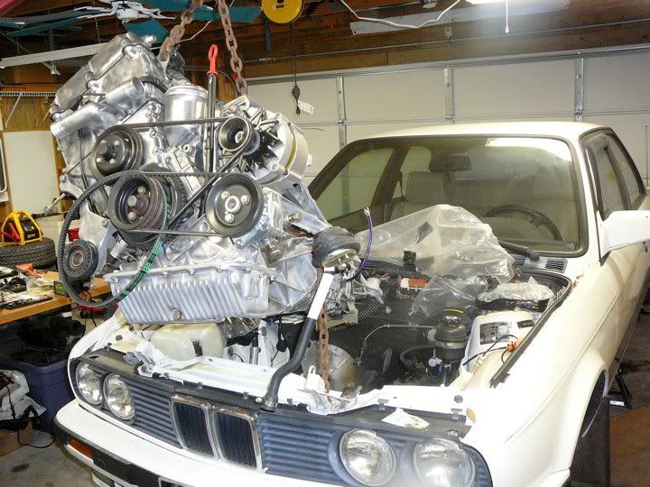

the shifter came from autosolutions.
Everything together
And now the motor getting reconnected to the car.

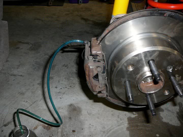

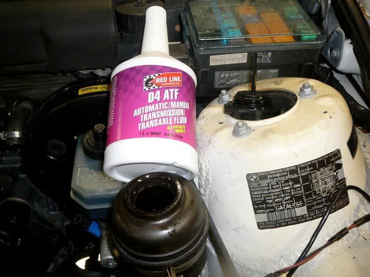

Now on to the fluids. no telling how old this Brake fluid is....
