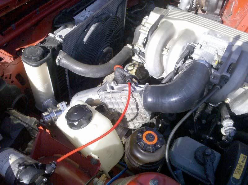

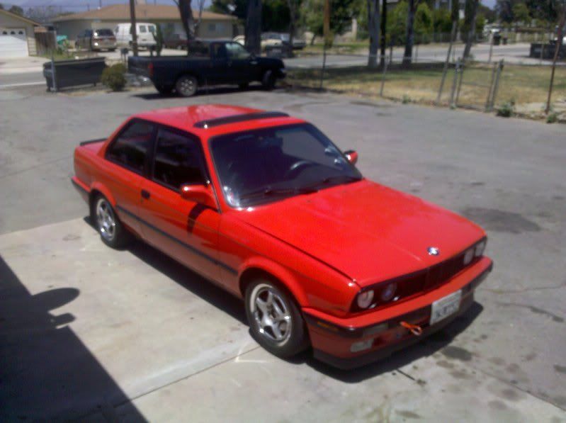

I just picked up my 91 e30 318is a few months ago traded it for a 97 supercharged miata. So in need of more power didnt want to do the whole m/s50 swap i saw all the turbo builds & how ez it was so i said why not.
parts:

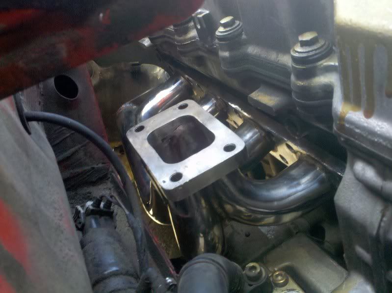

m50 turbo manifold $120
delta fin FMIC 28x7x2.5 2.5 inlets $65
JDM sports t3/t4 $80

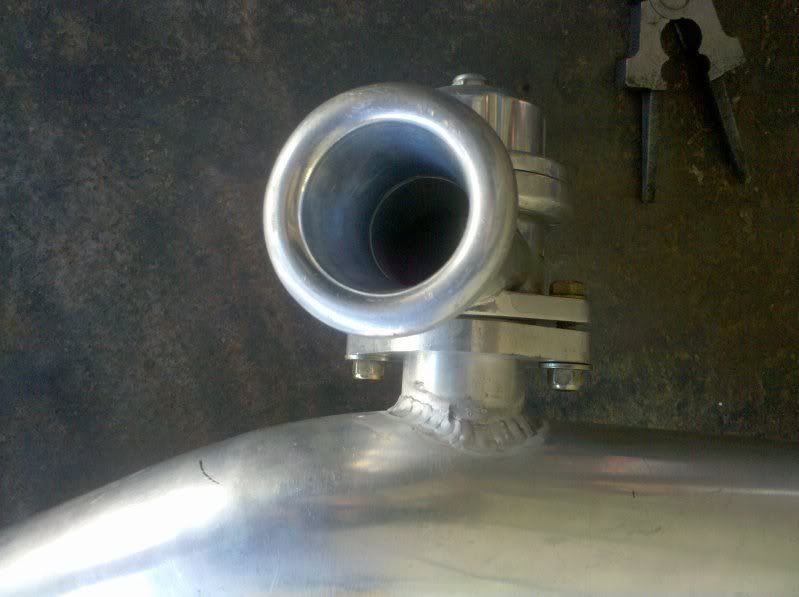

Turbonetics raptor bov $80
Prosport boost gauge $50
Autometer a/f gauge $ free
oil lines $50
3" turboback $120
30 lbs injectors from turbo volvo $ free
FMU $ free
Snow Performance water/meth. injection stg. 1 $150
t-bolts clamps, silicone hoses & misc. $150
total build under $1k

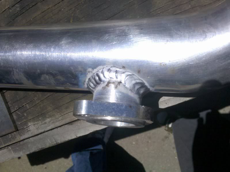

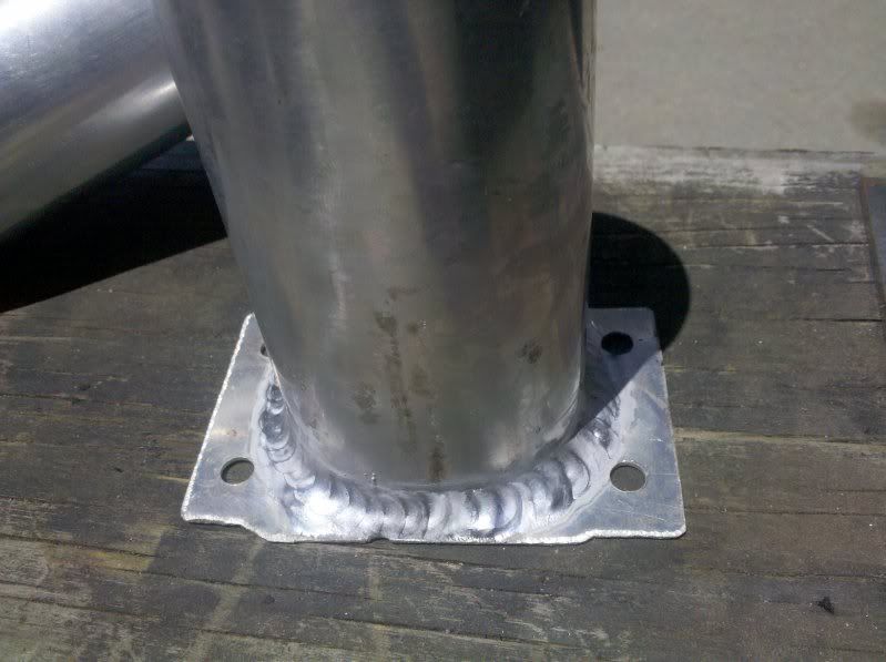

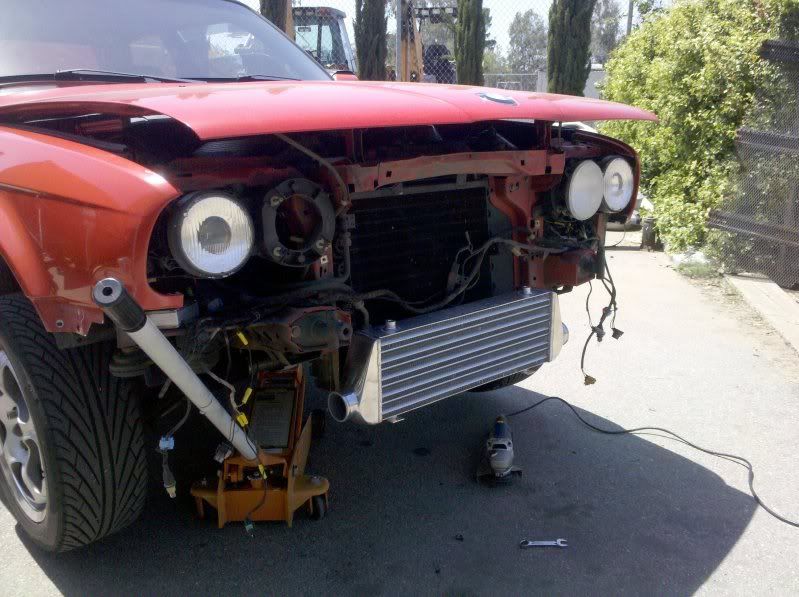

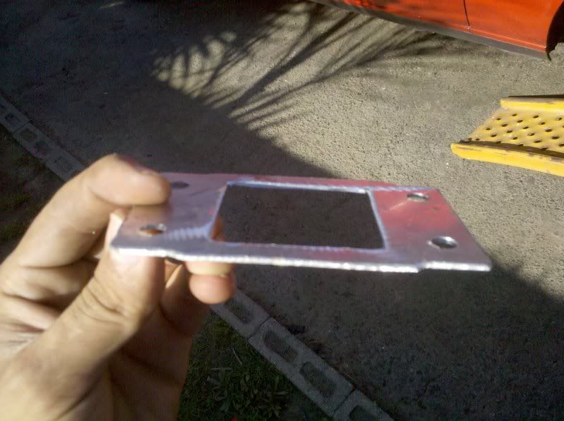

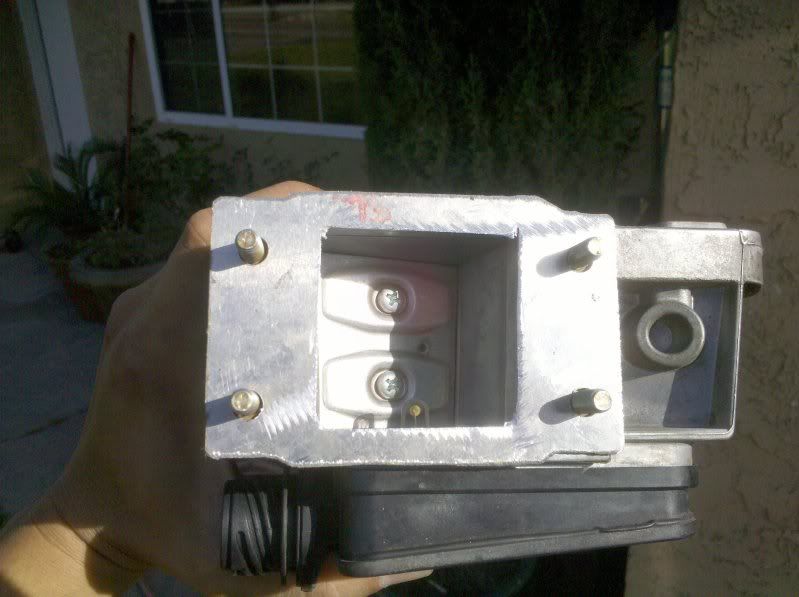

custom made adapter for the AFM made by Tony Excel fabrication

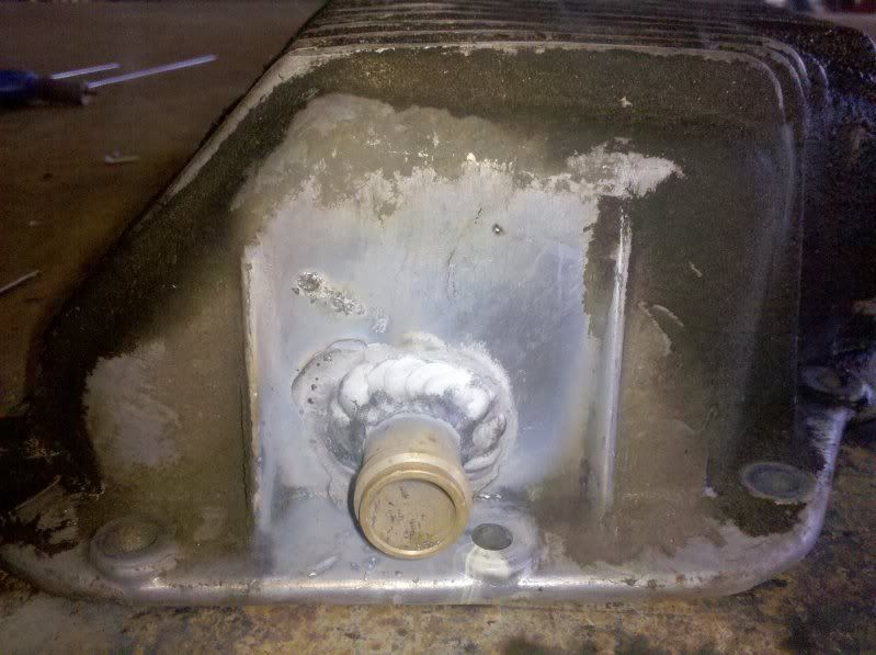

oil feed from oil filter cap

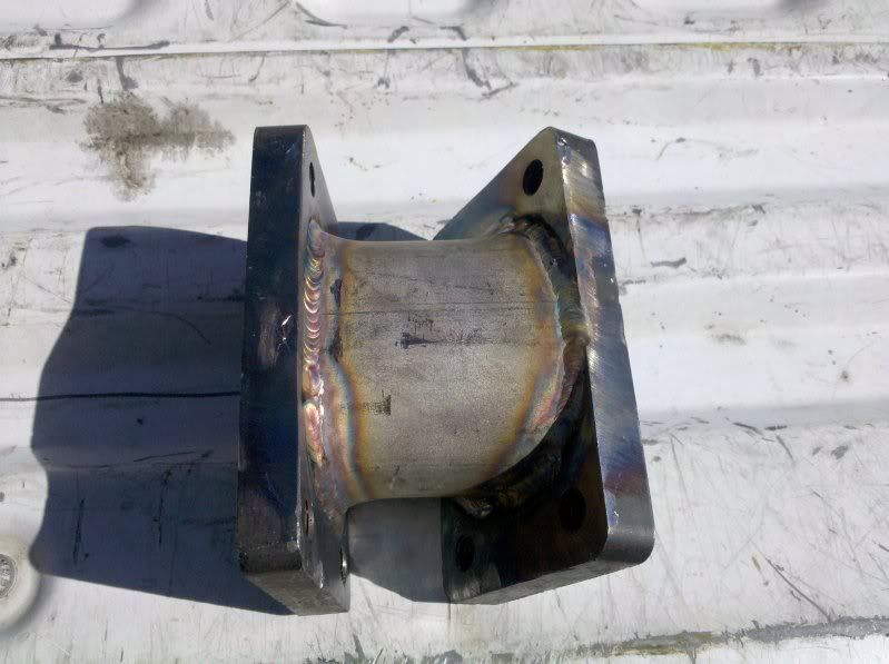

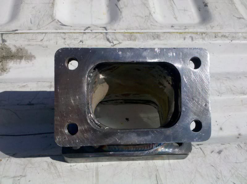

turbo to manifold 50* adapter stainless made by Beto @ b-werks
getting piping done
all done i've put about 2k miles no problems yet besides my clutch
so i did the m20 flywheel with sachs h.d. clutch
idles perfect runs strong i have it at 8 psi good numbers on the wide band 14.7 idle 12.3 under boost i bumped it up to 10 psi but leaning out so waiting for my Miller Performance W.A.R. chip
t3/t4, 9 psi., m20 flywheel & Sachs clutch, Snow water/methanol injection, Ireland springs, bilstein sports, ate rotors & hawk pads, AC Schnitzer kit, Recaro seat
