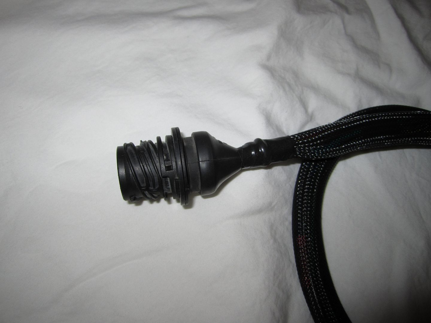

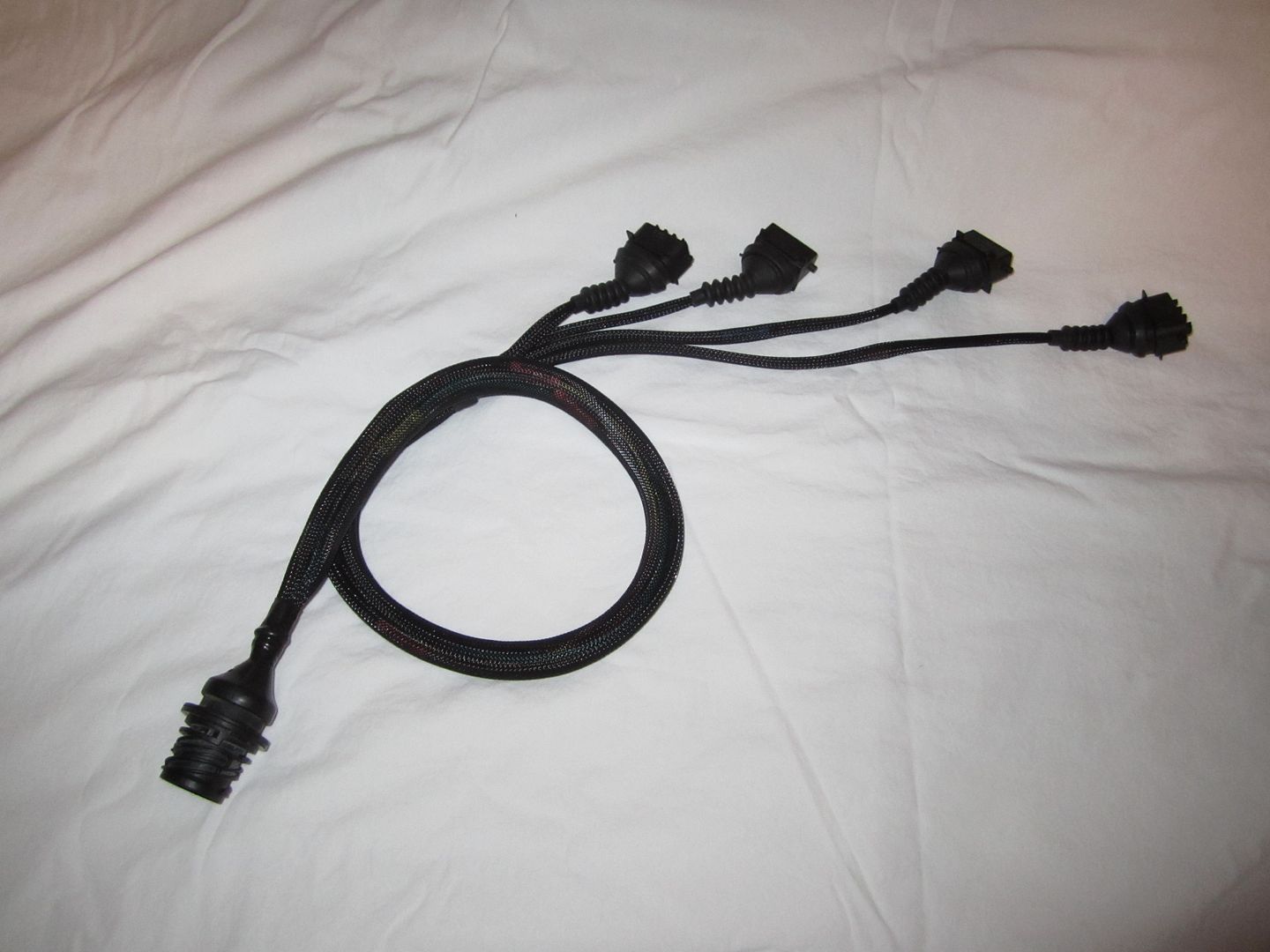

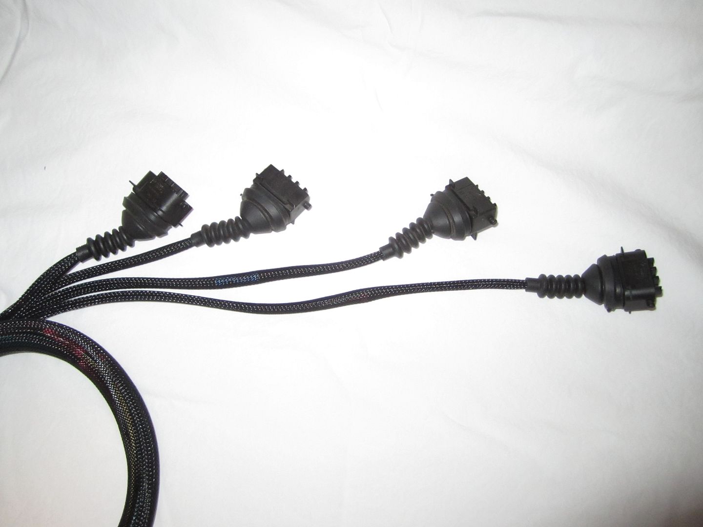

« Reply #218 on: September 02, 2010, 11:01:54 AM »
Quote from: rob_e30;95416
No details on the new kit yet, we just built and tested the first one.  It's pretty ugly so no pics :).
You basically unscrew the ECU from the existing coil pack, install the new harness, coils, and plate, plug the new harness into the coils, and start the car.
Here are some photos of the first pre-production unit.  The production units will look like this.
We are very close to launching this product on our website.
http://www.hqautosport.com

« Reply #219 on: September 03, 2010, 04:14:10 AM »
Very nice harness. :)
