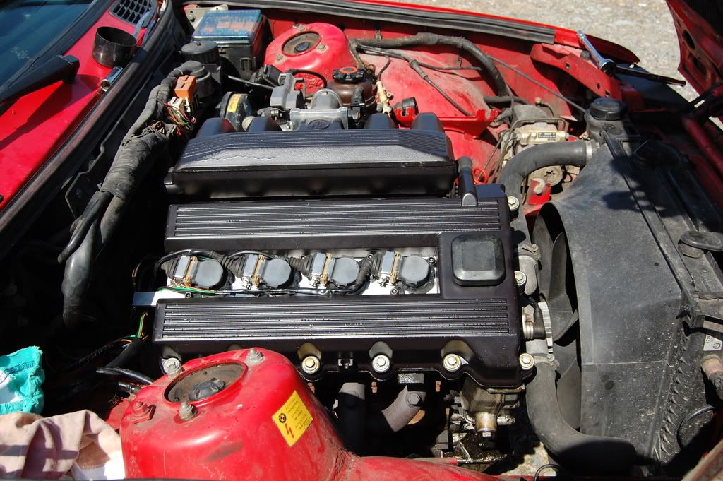

« Reply #207 on: June 21, 2010, 12:12:26 PM »
Here is my finished E36 M42 COP conversion:
Thank you all for your help.
A few remarks regarding the plate:
- for E36 car that little tail from the back needs to be cut in half (i did not used anyway so I could have just cut it all) because it is very close to the firewall
- I used M5 bolts for the coils (like the original coils were fixed) this allows a little clearence which can compensate for small imperfections in the cutting of the plate.
xsjado
  • Posts: 106
COP Brackets: Your Preferences?
« Reply #208 on: June 22, 2010, 11:12:40 AM »
how do you connect the COP to the existing wiring harness?pics please.
rob_e30
  • Posts: 623
« Reply #209 on: June 22, 2010, 05:51:57 PM »
It's plug and play for E30 M42's and early E36 M42's.  If you have 4 coil connectors in your harness then you are good to go.  If you have an E36 with the single round connector then you need to make up a new harness or splice into your existing.
