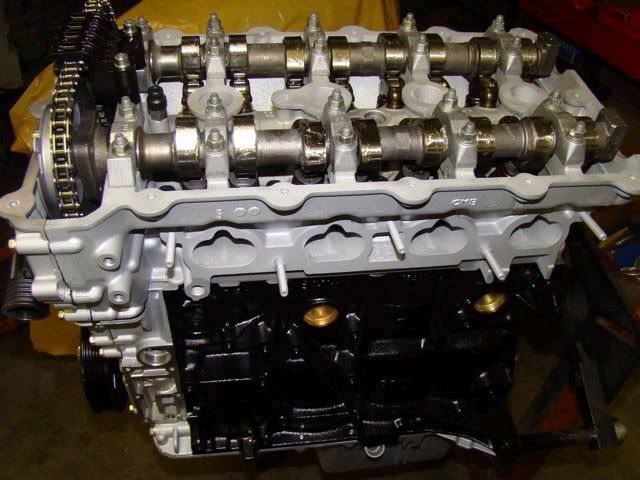

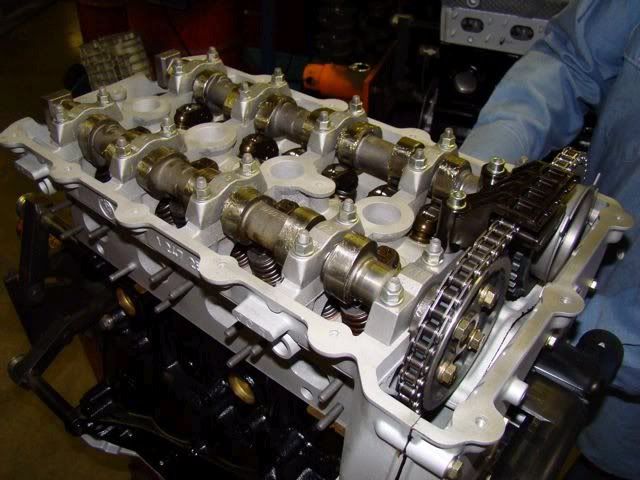

« Reply #44 on: February 20, 2009, 08:47:41 AM »
as promised - here are the pix of my upcoming MM motor with a single timing chain conversion... the guys from Metric have been kind enough to send me some pix from the build, to salivate over.
more pix of the entire thing here:
http://www.318ti.org/forum/showthread.php?t=25646
