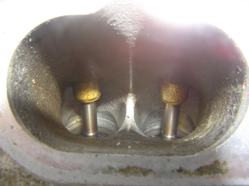

inlet ports - not too sure. i wonder whether the diameter of the inlet ports is a little too small, i need some advice on this really. i'll measure the port diameter tomorrow, and get the length, get the volume, try to get some pics of the shape etc, mb someone on here can comment? i dont have much experience in this area. i may even do a cutaway of an inlet port if you're lucky!!! anyone have one before i wreck a head!?
on comparison to the S14 the ports seem too small, and any advice on this would be appreciated. i will post up comparison dimensions when i get around to it. i'd love to see some other BMW inlet ports, if anyone has pictures of M50/S50 etc inlet ports, or any BMW inlets really, that would be great. the short side radius seems more than on an S14 too if you look down the port. may remove a little of this, not sure. comments? i'm also not sure what to do about the restriction that the valve stem seal causes, anyone know of a solution to this? the s14 has no such restriction. again, pics of m/s50s etc would be great. would be surprised if the US S50 was like this! anyone have an ETK screenshot of the S50 US valve gear?

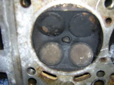

notice how if you follow a straight line from the entry of the port you hit the top of the valve and the valve stem seal on the m42, if you do the same on the S14 you hit the back of the middle of the valve. the s14 port is also a fair bit bigger. i think the m42 has potential though as the angle of entry of the S14 port is pretty steep. if i could get the m42 to have a bigger dia and less of a radius while having a slightly less steep entry angle, i think it would have potential.
here's the underside of my spare, manky head:
apologies for the state of the head, but its just a spare for testing. the throat angle of the inlets seems pretty shallow.
as usual, comments, advice appreciated. if anyone on here has a lot of experience with flowing heads i'd love some opinions. must admit i'm not so interested in hearing about stuff that absolutely must be done to my engine but i cant be told about though!

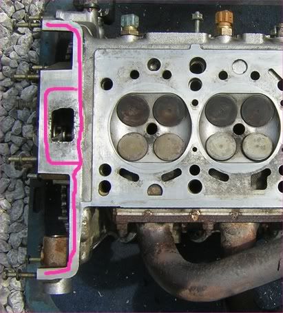

i will be running 11:1 CR, i have a 2.1 m42. you'll also have to be careful about fitment of the front timing cases if you go milling the block by quite some way, as the lower front timing case will sit higher than the block.

yeah, but having done some decking to mine, the rubber gasket gets a bit pinched/squashed, and i wouldn't like to go as far as you suggest because leakage becomes a very real risk. furthermore i had to skim the upper front timing case too because the bolt holes won't line up otherwise, the rubber will not compress that much and the timing case will sit higher than the cyl head. the correct way to do it is to not deck the block very much, and skim the head and the front upper timing case at the same time, this way everything fits as it should. trust me, having done some engine work and decking etc, what you propose is not a very good idea really - well not the best way to do to it anyway.

haha, well i wont say i told you so, but remember i have done this so know what im talking about. if you go ahead and do that, the cylinder head will squash and pinch the inner profile gasket, as the lower timing case will be proud of the block, and given the problems that our cars had with this gasket from the factory, this really is not a good idea. you'll then be exerting more force than you should against the cylinder head. that's before you consider that you'll have to skim the upper timing cover else it won't line up to the cylinder head. by all accounts a pretty dumb way to go, when you could jsut skim the head or buy custom pistons etc.
i imagine it would work, as my block does which has been decked (but not that far), but is just not a nice way to do it especially if going that far.

oh ok, if you skim this bit by the 0.9mm:
and skim the front timing cover for the cylinder head by 0.9mm, you'll be ok. just make sure its safe to skim that part of the cylinder head by 0.9mm
« Last Edit: June 05, 2006, 07:18:34 AM by tim_s »

so anyone have any info on removing the obstruction in the inlet port that the guide presents? that's currently probably my biggest concern as this must affect flow quite a bit. i take it febi's has something done about this with different guides etc?
