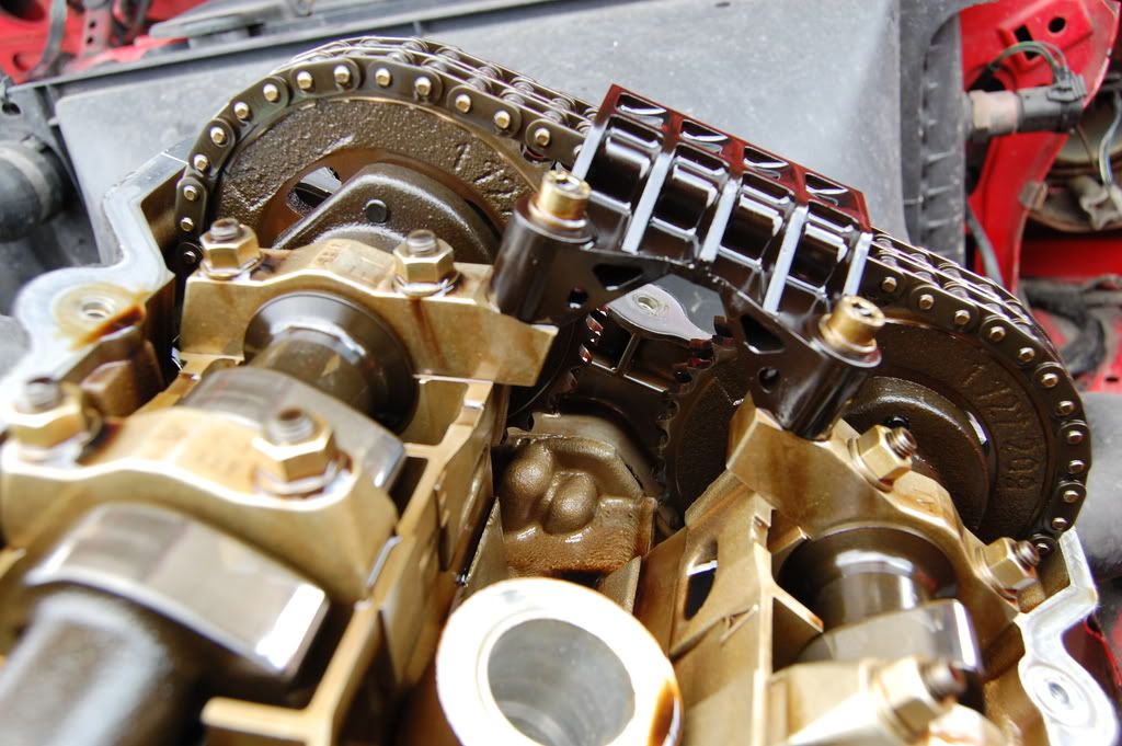

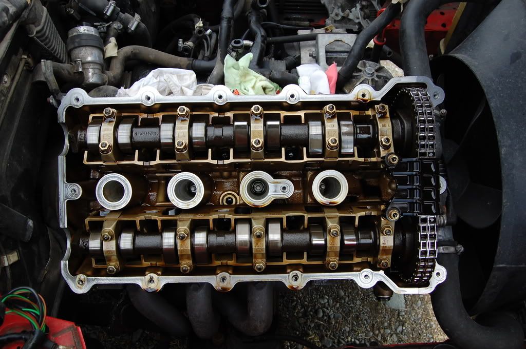

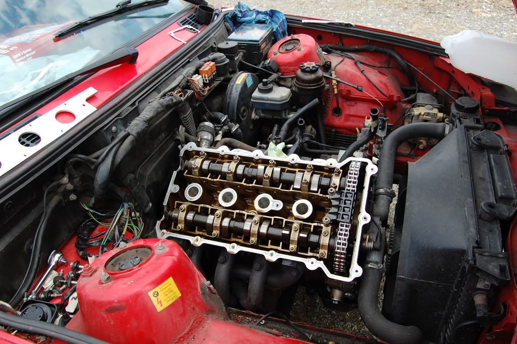

No valves to adjust on this motor! Is it ticking loudly?

Yeah like a diesel ..lol
Im thinking its the guides on the timing??

You can start with the timing chain tensioner, and some heavier oil...like 15w40.
If it STILL sounds like a diesel you will probably have to open her up to inspect guides and cam sprockets.

all the timing parts showed up today.
She is very happy that we will be getting the car fixed.
lets just hope it all works out for the best.. :o
