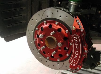

do anyone know tarox and have experience
Tarox is a italian company, they sell a lot, they are good brakes, but a  very little inferiors to the same type of brembo..., but as you power will be not huge(not 500hp:D), go with them if you have a good deal!

the main problem is, that in switzerland you need for nearly every part you change on the car a special certification and tarox has this certifications, so it is the only brake i can change without problems, i need only the ABS. the kit costs about 3300.-$ only the front!!! and bevor i spend a cent on this brakesystem, i want to here if people have self made experience with it

you need TUV certificate, right? If so check MOV'IT brakes, they are Tuv approved, a lot of people use them even in USA, for the e30 they made 332x32mm front, and they will cost less than tarox

TÜV is useless in switzerland!!!!!! they dont accept this certification!!you have to make a special SWISS-CERTIFICATION. i know it is stupid, but thats the way it is here  TAROX is the only one who has this special specification

Do you need special certification if you are replacing parts with parts that came from another bmw model?
If not, you can try fit the e36 m3 brakes onto your car and use the 4-pot Brembo calipers from the 840ci. They are a direct bolt on for the e36 m3 but might not be for the e30.
I will be converting my 318is to this setup very soon.
TAROX brakes are extremely well built but they also have an extremely high price tag.
