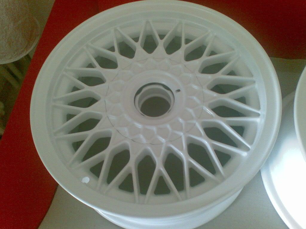

« Reply #7 on: January 01, 2008, 12:25:01 PM »
my new rims for my daily driven 318is e30
