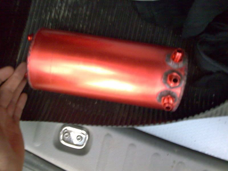

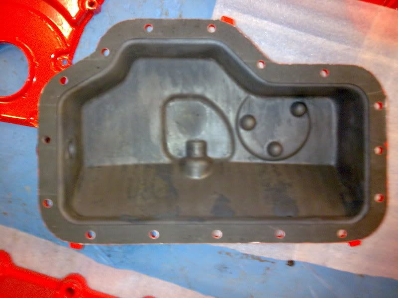

« Reply #68 on: January 22, 2008, 02:29:08 PM »
I'm not sure if cleaning is the problem. I've linked some pics of how it looks. A little bit strange though that the gasket surface didn't turn out better than it did...
It's not my parts so I don't know if they where cleaned properly or not.

« Reply #69 on: January 23, 2008, 12:49:11 PM »
Certain types of aluminum anodize differently, which is probably why the welds look different on the canister. Some types just do not take anodizing well.
I doubt they used high end aluminum for the pan.
