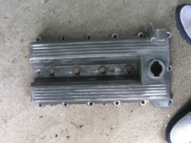

long as my enigine is all in pieces i was gonna paint some of it and im starting with the valve cover and i want sum type of color theme im most def. painting it black but im not sure what to paint the lines on it i dont want to do the traditional grey so i was gonna go with either Red (my dad said it will look like a saab) or like an m3 blue. any input ? what do u guys think

I am in the process of redoing my VC and intakes...VC installed--intake (upper and lower in the works). Was thinking of powder coating them, but I am to damn cheap...lol
Steps I took.
1. Clean the piss out of the parts. I used "Aircraft Remover" to strip the parts.
2. Primed with "Adhesion Promoter"
3. Painted with Dupli-color Textured Metallic
4. Sanded "stripes and logo" to bare metal
5. Clear coated them
The VC is a little dirty right now....Don't punish me....lol

nice your intake manifold looks a hell of a lot cleaner than mine does. so what did you use beside the aircraft remover cause ive been going at my stuff with a wire brush on a air tool works good but not so much in the crevices

Quote from: 91318isfoundation;27747
Just used the AR and a pressure washer. No scrubbing/sanding required. Just don't get that AR stuff on your skin....Will burn like a MoFo....lol
