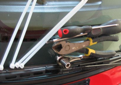

This is an easy job requiring very little in the way of tools.
Here is what you will need:
Time: 30-45 minutes for the resistor, 1 to 2 hours for the blower (you could take more, or less)
resistor and/or blower
small flathead
medium phillips
7mm 1/4in socket and ratchet
wire cutters
4 zip ties
wire ties (zip ties)

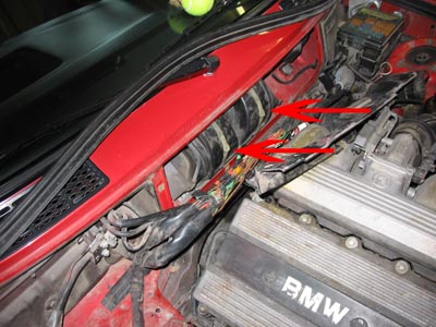

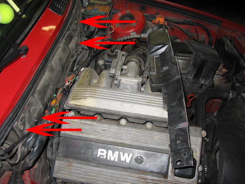

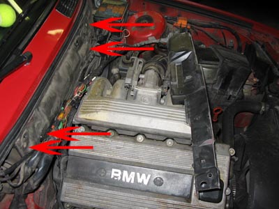

Begin by removing the wiring harness covers, They usually pop off with a tug.

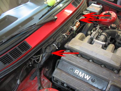

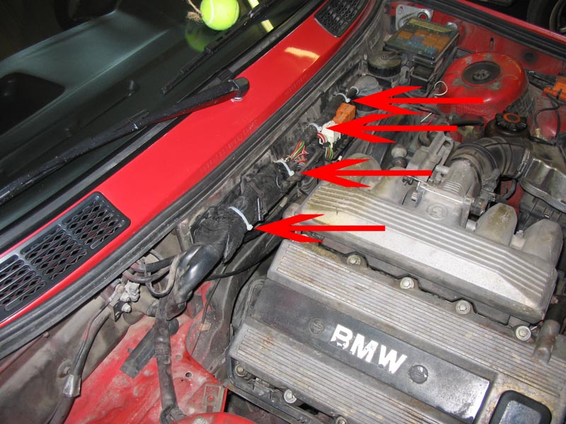

Now snip off the zip ties. Yours may be black, green, or whatever. There are most likely 4 of them.
Now remove the 3 (Phillips) screws holding the wire harness shelf in place.
There is one on the passenger side, 2 on the driver side. They hold on one of the diagnostic ports. (yes I re-used the same picture, so sue me)

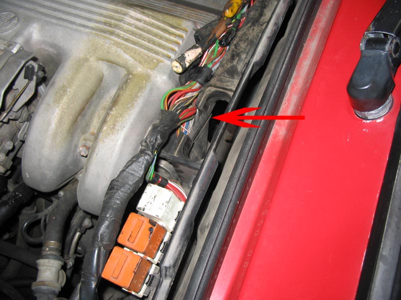

Now the tricky part, be careful here!
The harness comes up through the center though a tube, that needs to come out. What I do (working from the drivers side) is push the tube up so you are working with a thinner area, then towards the passenger side and squeeze the driver side out. This makes it easier to get the passenger side out where most of the wires will be.

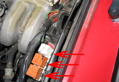

Now pop the relays out. Use a thin (flathead) screwdriver from behind to release the tab.

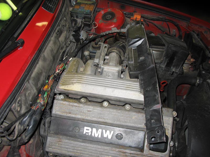

You should end up with this.
Gently(!) move the tray out of the way, I lay it across the engine (yes, I have done this before).

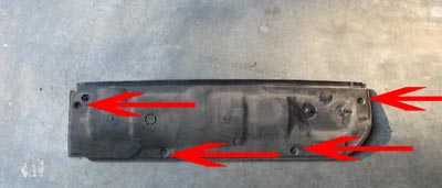

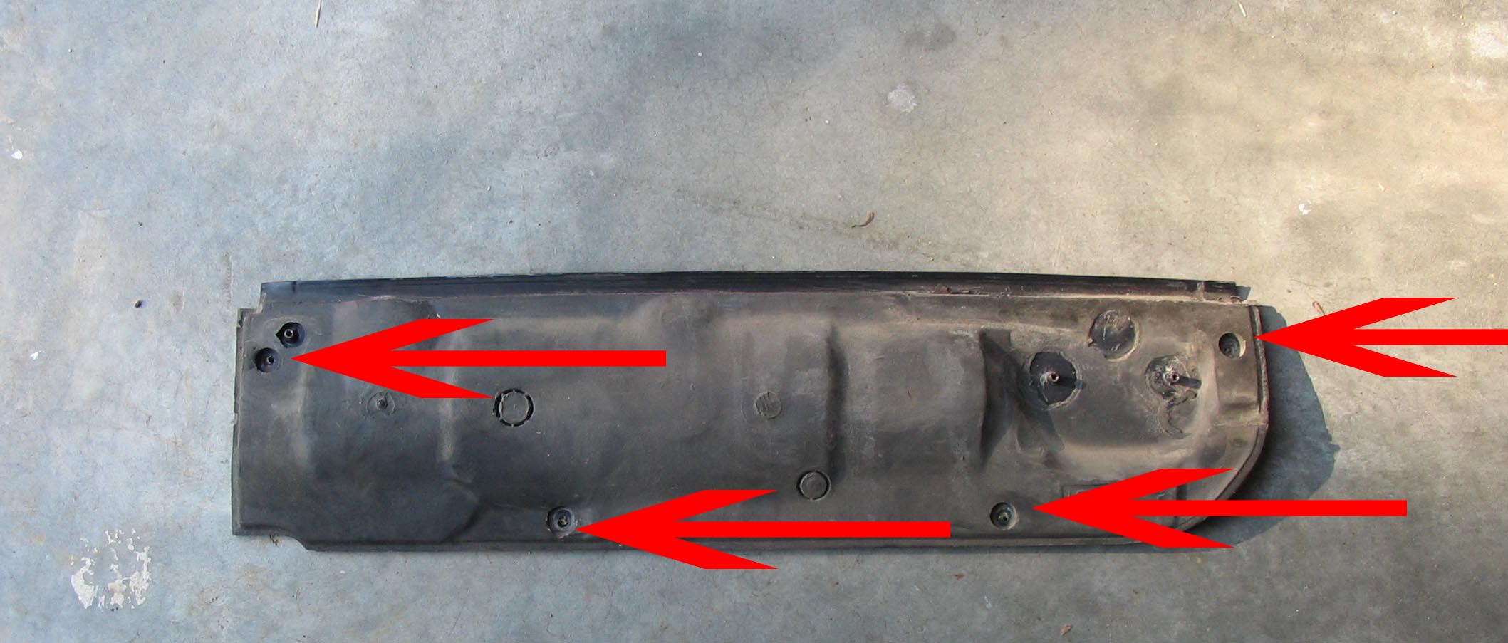

Now remove the panel behind it. There are 7mm screws holding it in place and you need to lift the hood seal out of the way.
I stick mine up behind teh wipers but tape will also work.
Here is the panel removed to show the screw holes better.

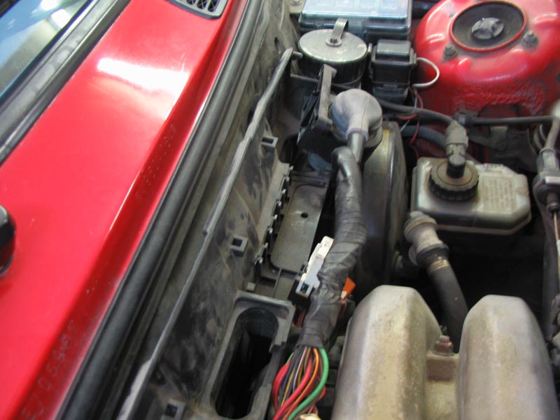

Puling the panel off you should be greeted with something like this, only dirtier.

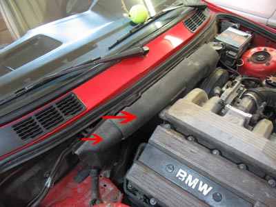

Unhook the 2 plastic straps. Pull down and out on the tab.
Be careful as the straps may be brittle, try to bend them as little as you can.
Now remove the plastic cover.

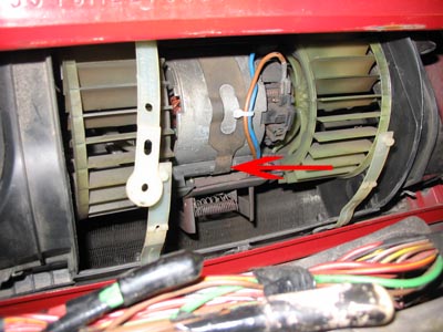

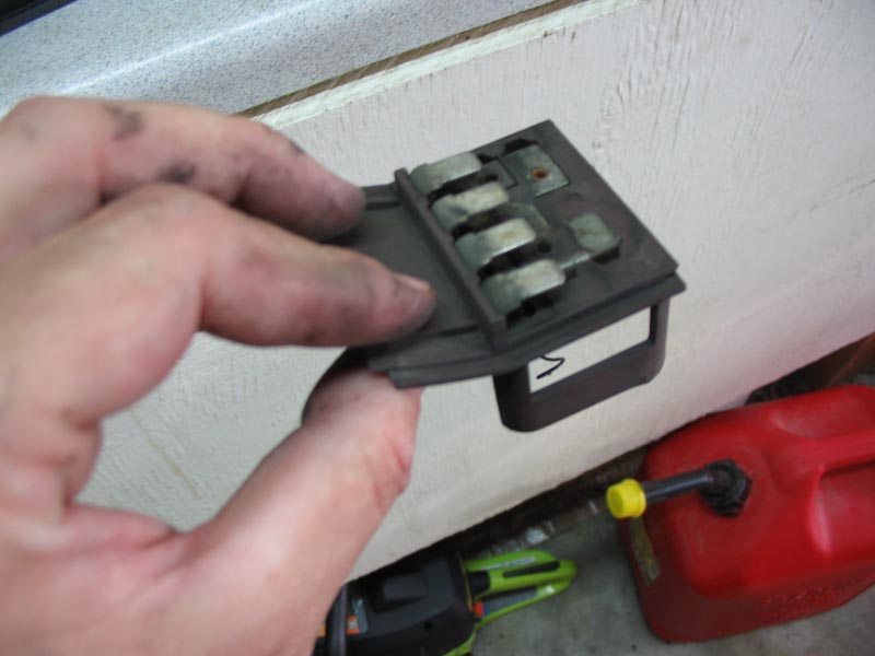

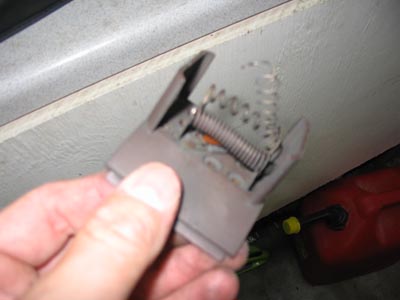

The arrow points at the resistor, simply pull it towards the front of the car. Watch yourself, as it may be quite stuck.
Things that are stuck and quickly become unstuck tend to mean pain for the mechanic. Some will also tell you that if you do not bleed each time you work on your car you did something wrong. Watch your hands.
This is what you are after.
The spring was bent up to show you what was broke on mine.
Before closing up, test it with with the switch. After you put the blower cover on, test it again. Make sure the straps are clear first.

If you are replacing the blower as well, remove this strap. It un-clips at the bottom. I recommend a second person to help on this, as it can be a pain, even more of a pain is putting it back in. You will also need to cut the zip tie, disconnect the wires, and slide it out through the drivers side. Sorry no pics for this part but it is pretty straightforward but a hassle, and no pics will really help.
The bottom of the slot in the middle is good for pressing a flathead screwdriver against and smacking with your hand to remove it.
Going back in, I have a buddy use the screwdriver method again, and have I push it into place as he pushes down instead of hitting it.
Keep in mind, the blower has a certain orientation, if it does not go in right, it will rub and burn out, or catch fire. You will know when it pops into place, but getting it into place along with the clip is a pain in the you-know-what.
Spin it by hand to see if it is rubbing, if not try it with with the switch. After you put the blower cover on, test it again. Make sure the straps are clear first.
