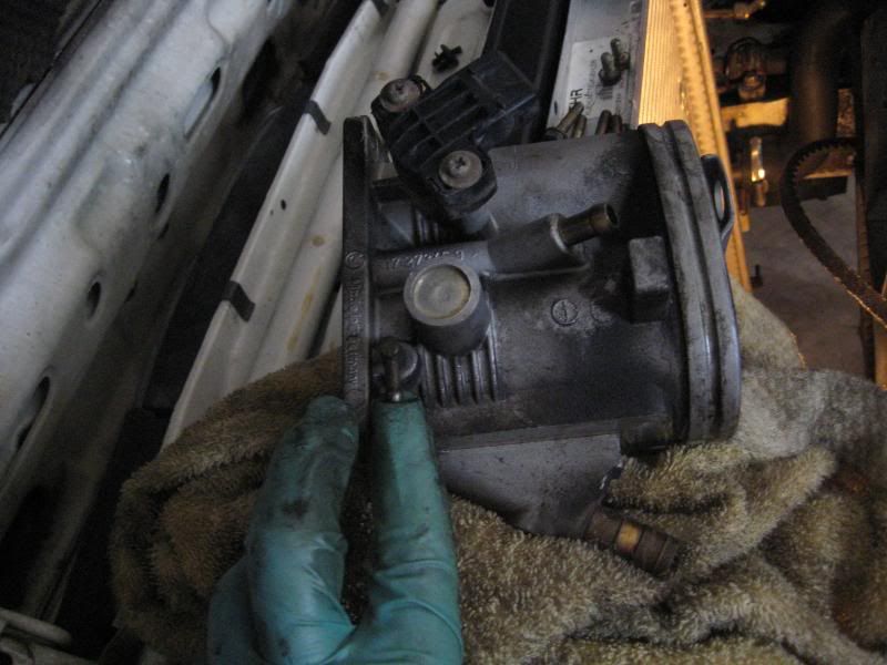

hey guys putting my stuff back together any1 tell me where this vac hose goes that comes off of the fpr?
i can't remember where exactly it goes

« Reply #243 on: March 11, 2010, 06:35:48 AM »
Should be a fitting on the side of the throttle body that it connects to.

Quote from: BlueBMW;89272
have a diagram or pic?

« Reply #245 on: March 11, 2010, 02:40:43 PM »
this one I believe.  From my writeup a while back haha
if you need other references
http://m42club.com/forums/showthread.php?t=6334
« Last Edit: March 11, 2010, 02:46:41 PM by ///m42 sport »
Chalino
  • Posts: 229
The mess under the intake
« Reply #246 on: March 11, 2010, 03:15:05 PM »
That's the fpr line and it hooks up to the doenward-pointing nipple on the image above. Make sure you hook it up on the TB side before you bolt it up to the manifold; otherwise it will be a bitch to get to.

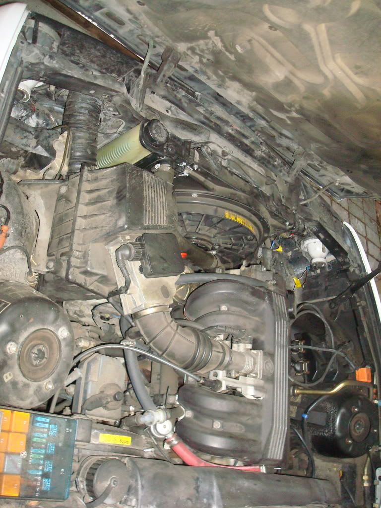

Just did got it all done, had a nightmare time with the icv collapsing the hoses on me, and I am contemplating using metal tubing (conduit?) for the run to the icv from the intake boot. Anyone know of any reason I couldn't use electrical conduit? It is galvanized, will that cause any issues? The stiffest hose I could find still collapses significantly on me, although it's not completely closed, I would prefer it be completely unobstructed.
Betty - Sold
Sabine - 2004 325xi
  • -Receive: 5
  • Posts: 1109
« Reply #254 on: June 28, 2010, 02:36:12 PM »
Ask for 'reinforced' vacuum or oil line hose at the parts counter. See the red hose on mine.
http://img.photobucket.com/albums/v242/tjts2/BMW%20for%20sale/DSC04462.jpg?t=1277753321
