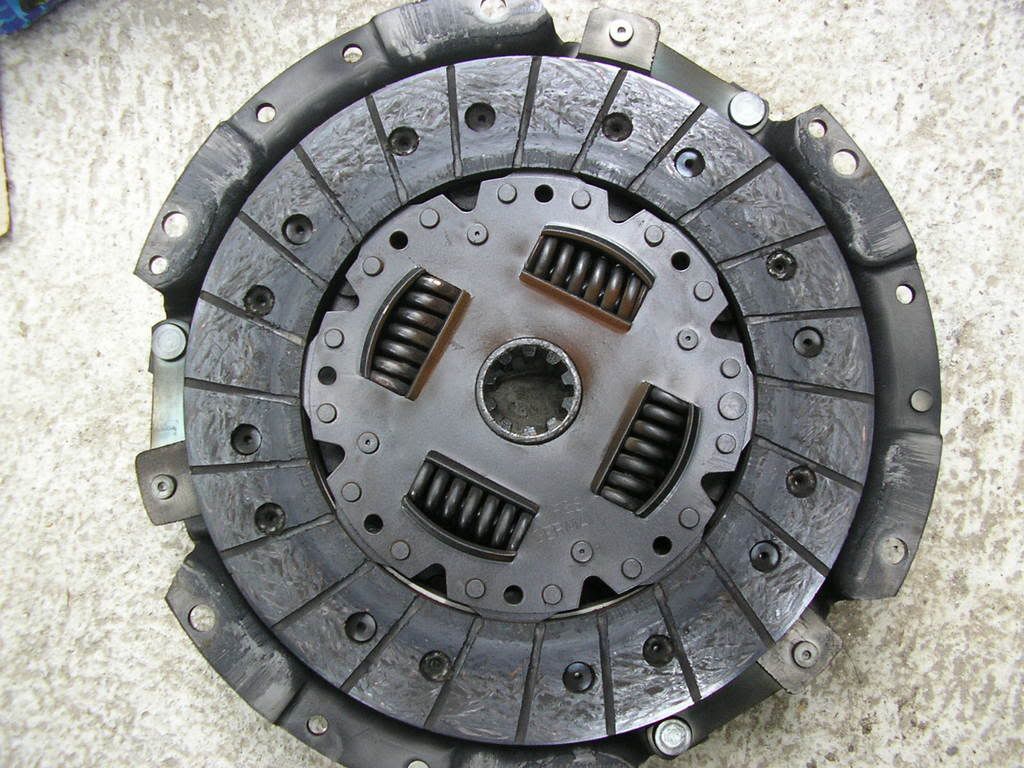

My m20 flywheel (with 0.5mm preload) installed and runing with: m20 flywheel bolts, M42 starter motor, m20  325 free wheel pinion which was shortened to M42 free wheel pinion dimensions, 325 sachs clutch, 325 TOB. Everything works fine ;)
5.4kg flywheel + 7kg clutch = 12.4kg
http://romkasponka.blogspot.com/2007/10/sankabele.html
p.s. It is with E36 gerabox.
