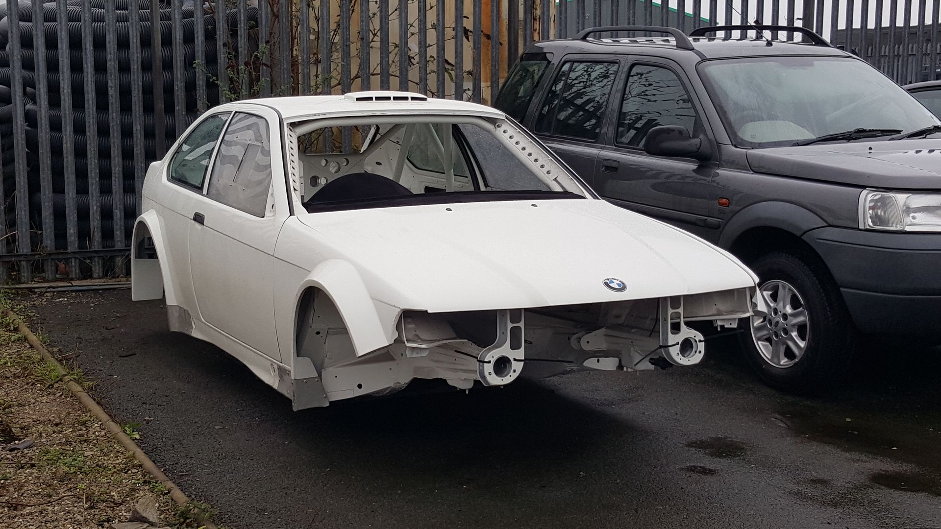

I havent much to update on this thread. nothing much has happened recently other than getting my car ready for the engine. so its now baisiclly ready for the engine to go straight in other than re routing the fuel lines as I used to have braidied lines running inside but they made the car smell of petrol. so now gone for copper lines, andalso I will need to re route the coolant pipes, which I cant do until the engine is in really.
The only update on the engine is that its first inline to be put together in january. I didnt want to go to much into it with my builder as I do not want harras him haha. but maybe it should be back with me by end of january or feb? we shall see.
In the meantime ive aquired this:
Now what do I fit in this?
https://www.youtube.com/watch?v=QVino9WOZmI

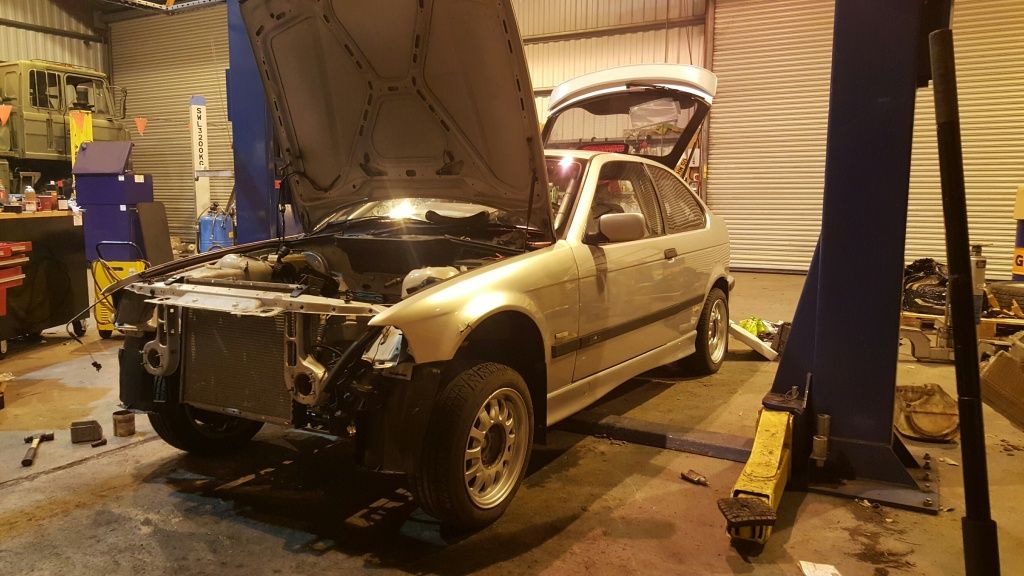

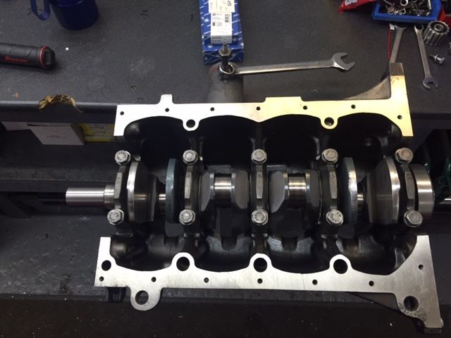

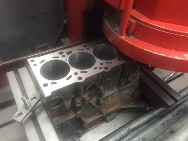

not much to update, just a few pics ive been sent across, over past few weeks, builder says engine should be done end of this week.
Got a few things done on the car over the weekend, such as finished the mounts for the bigger radiator, made a new mount for a vw expansion tank, So now the car is more or less ready for the engine to be put back in  8)
Also been in touch with a company called thinkauto, who say they have m42 and m44 take off adapters that replace the screw on caps for the oil filter, they say they should be on sale early this year. so once they are available ill fit an oil cooler to the engine. and im about to order the bits I need for a COP conversion once im done uploading these pics
And to finnish, some new wheels ive chucked on the car  ::)
Darky
  • -Receive: 23
  • Posts: 630
Re: m44/m42 spec rally engine
« Reply #80 on: January 19, 2016, 01:56:40 AM »
Nice Sion
You boring it yourself?
very nice, i was interested in that compact, looks like a nice shell. i might be getting some m42 2500cc cranks and rods if you want to keep it 4 pot and stage rally it :)
2500 cc crank?
Hartge made a 2350 cc but massive out of square.
Cheers Rohan

  • Posts: 144
  • Freshly Registered!
« Reply #81 on: January 19, 2016, 05:29:29 PM »
No, these are just pictures ive been sent from the engine builder.

Still love pictures of that crank!

Darky i do love pictures of this crank as well. Haha.
Thank you wazzu for your input. Much appreciated.
