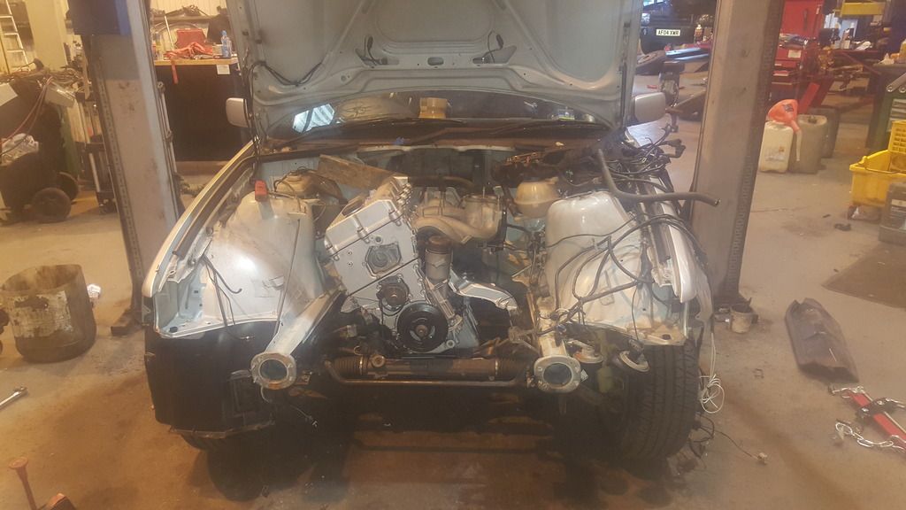

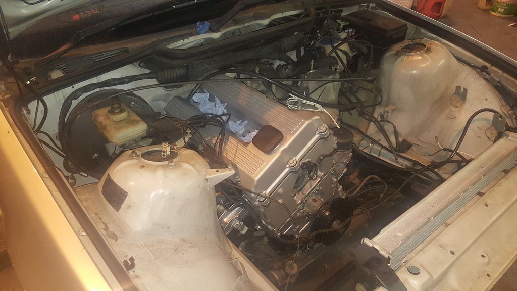

so this weekend this happened
obviously it is not done. but got engine in. all water hoses sorted which I was worried about as I had relocated the expansion tank. sorted most things under the manifold out.  Fitted the clutch and flywheel as well.
Have an issue though. I bought injectors for it around 4 months ago unknowingly for m42. It didnt cross my mind the diameter of the holes in the manifold was smaller. I know vac do adapters but im in the uk.
So ive sent a few emails around to people who do supercharger kits for the m44 here in the uk as I see they do adapters as part of the kit.  I did also think maybe (i need to measure first) if I can take apart the m44 injector and cut the bottom off I may be able to get the m42 injector to sit inside? was just an idea.
and im sorting everything for the oil cooler out tomorrow. so that will be my job for tomorrow night!
ive been in touch with the the guy who will be mapping the ecu and there is a waiting list of 3 weeks. so im contemplating booking it in to get mapped in next 3/4weeks. as it will be run in on the rolling road as well.

Can you machine the injector cup in the manifold to the larger diameter? Not sure if there is enough meat to do that or not. Other option is to wed in an aluminum injector bung of the proper diameter.
I havent worked on an M44 so I am just going off what you are saying is the problem :)
The M42 injector is more standard so being able to fit them easily opens up a lot of options for you.
You are remapping the stock ECU if I remember correctly. Are the locations for fuel and ignition maps known for the OBD2 system? I have a standalone so I have not looked into it and am just curious.

The holes in the manifold are to big so I just need and adapter to sit inside you see. I have had a reply off a injector specialist who has adapters and is looking into the stock that he has incase he has the appropriate size. Otherwise i may get somebody to weld them up or possibly we have a lathe at work we may be able to knock something up (we rarely use it)
With regards to mapping, here in the uk there is a guy who is well known for mapping bmw ecu's. A guy I know had his mapped there. Same ecu. 2ltr block stock head and cams they managed 180bhp on standard ecu, manifold and injectors.  And making the most of the disa valve in the m44 to get good torque.

She turned over today. But didn't fire.  :(
We think that it is down to a crank sensor. I was supplied with a three wire sensor like is on the m44 anyway. But i think its a hall affect one rather than an inductive one.
I do however have another sensor to test with tomorrow. I just have to lengthen it a bit. Ill then see if i get a signal on the scope
sh123
  • Posts: 144
  • Freshly Registered!
Re: m44/m42 spec rally engine
« Reply #114 on: March 27, 2016, 06:24:51 PM »
And today it was running!!
Was incorrect sensor.
Booked in for mapping in two weeks time.
