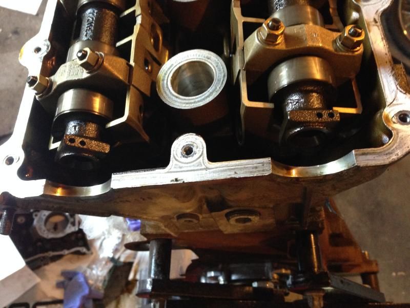

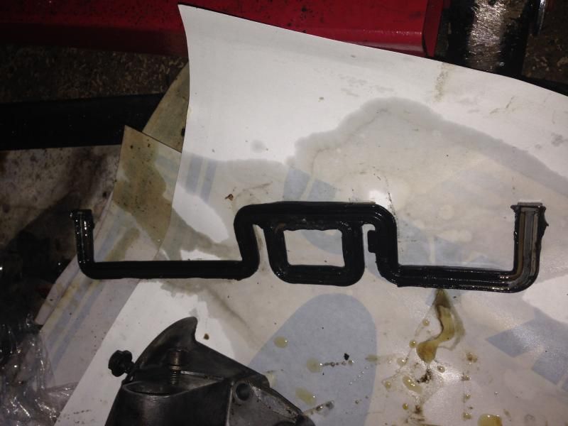

well waited 2 1/2 weeks for the crank tool. Got setup to battle with the bolt and it was over before I knew it lol.  Didnt even use a breaker bars
what ya'll think of the profile gasket sticking out here?  is that normal?

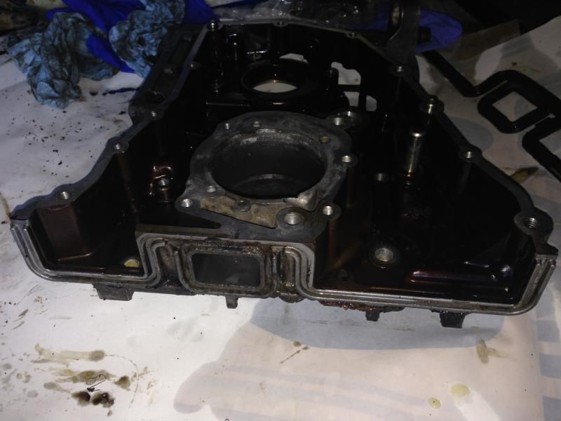

also coming back to this issue again. I thought it was a timing cover issue but now realize its a timing case issue  :'(.  think that huge gash is repairable with jb weld, then a gasket sealer  to seal waterpump?
SkidMark
  • ex pro bmw wrench.. 15 yrs bavarian auto haus
  • Posts: 93
  • OO==[I]==OO
Re: rebuilding m42
« Reply #17 on: September 27, 2014, 10:37:57 AM »
I might try looking for another timing cover... you could probably have it repaired, tig weld the gash, file smooth, drill and remove the broken bolt.. Im not sure about the jb weld? It would really suck after all the work you are doing to put it back together and have the jb weld fail.. A used timing cover might be a better option and cheaper.. As for the profile gasket, I dont like the looks of it. If it were me I would replace it. It may have bulged out after you removed the cover?? Another hate to have a leak situation....  Skid

thanks skidmark, I thought about it  a little and decided to swap out the timing cover.  Profile gasket didnt look too bad but that waterpump surround didnt look like it would hold.

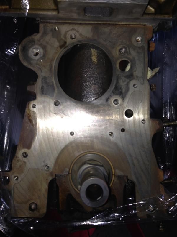

I'm glad I took off the timing case.  Profile gasket looked in descent shape but could use a change
cleaned up the head surface.  Not much pitting
cleaned the block

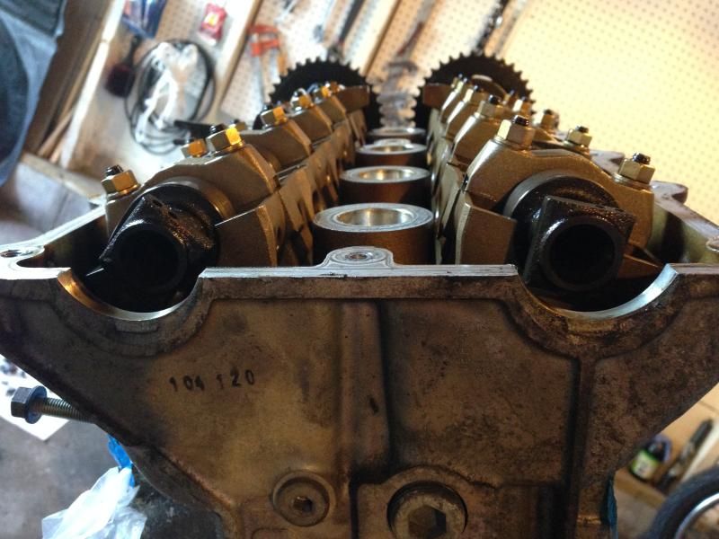

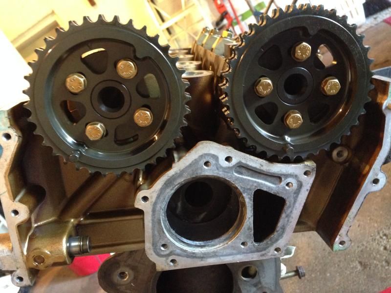

then looked like I screwed up the timing.  I'm pretty sure the left cam moved a little after trying to take off the timing case.  How do I make sure the cams are lined up with crank?  :(
Also when I put the chain back in place, how do I know how many links should be between the gears?

« Reply #19 on: September 29, 2014, 05:18:48 PM »
This was from another thread, hope it helps.
Timing is pretty simple. if you follow a couple of rules: 1) front cam lobes pointing up and slightly towards each other and flats at rear lined up so a ruler can be placed flat across them kind of like this
2) There is an arrow on the oil filter housing
That needs to point to the tooth with this mark on the harmonic balancer
There should be 15 tiing chain pins between the timing gear marks.
If you do that you should be good to go.

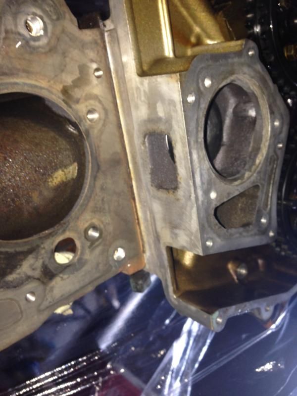

Noticed that this might be a issue.  Its hard to tell from this pic but the oil pump is still angled against the slot on the crankcase and about a millimeter off from sliding in. The profile gasket it pushing down slightly against the timing case.  Havent found a good way to apply pressure up on the bottom of the case...I was thinking tommorrow ill wrap the engine with a racheted tietown.  Hopefully that will give enough pressure to push up on the timing case and allow the oil pump to slide onto the crankcase...Anyone have other ideas?

this is something I came up with and trying out tonight.  Im thinking using the racheted rope will pull up enough on the gasket enough for me to clear that milliter gap at the oil pump/crankshaft slot.  I'm also setting the profile gasket inplace already so I wont have to mess with wedging it into place.  Wish me luck lol :D

after 2 hours trying to get the timing case on, I'm almost there.  Learned a few things
I thought initially I would try to line up the top of the case first then pull the bottom up with the block.  That way I wouldnt have to mess with the profile gasket any and it would only be a matter of lining up the oil pump....
Found out it wasnt so simple.
wondered by the case wasnt budging and looked in the back and realized the crankcase wasnt clearing the hole on the timing case  >:(
I guess its back to this method...using the feeler gauges to guide the profile gasket it.  will see if I can slap it on tomm night.

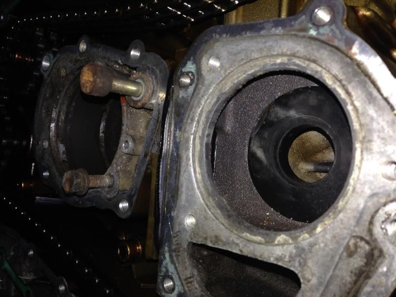

My only issue at this point is the mating surface for the oilpan is a hairline off on one side. I couldnt get the timing case to sit flat against the block.  I tried to push up on the timing case but it wouldnt budge.
Think it would be ok for the timing case to be sticking about half a millimeter lower than the block on one side?

couldnt get this any more level with the block  :(
