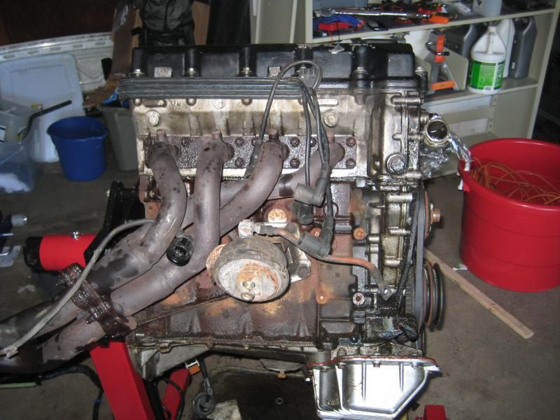

Just picked up this spare m42 and trying to decide what I want to do with it.  the M42 in my car no possibly has a broken ring and is going through oil like crazy.  My thoughts are to clean up the spare m42, and if the sprockets are in good shape, replace the seals, and swap into my car.
My other thought was to do a stock rebuild since this is going to be my daily.  Only thing is I've never worked on engines before so I'm pretty hesitant to do anything major with the engine.
In the meantime, I'lll post up some pics of the cleanup progress.  Also I figure there are not enough pics of m42s online haha

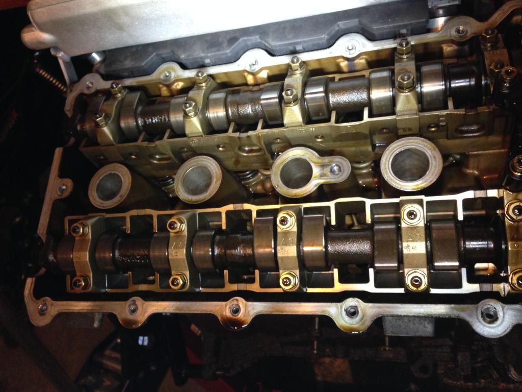

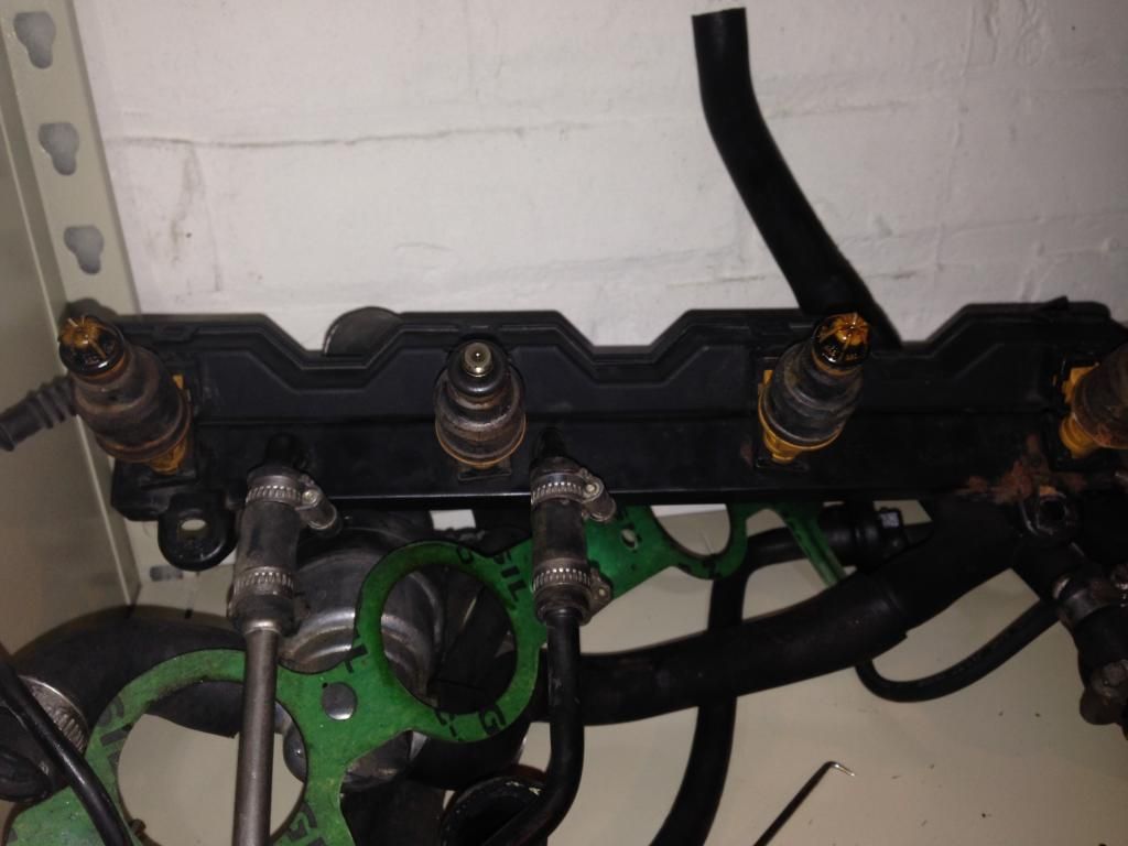

spent some more time tonight taking the engine apart
Looks Good!
plugs are worn haha

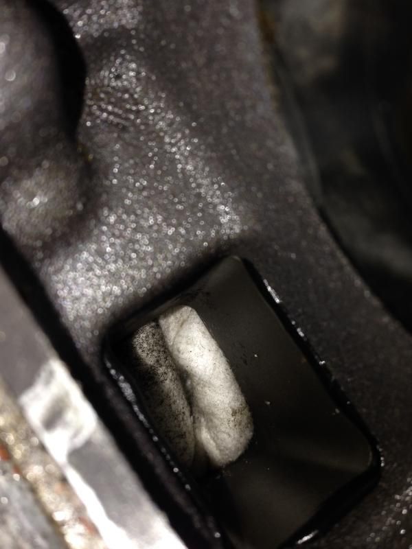

Not sure what happened here with the injector tip.  I searched everywhere thinking the tip flew off somewhere or inside the port but I didnt find it.  I'm thinking the PO installed the injector without the tip since when I pulled the injector out, the rubber washer was still in the hole.
Havent done a compression test yet though.

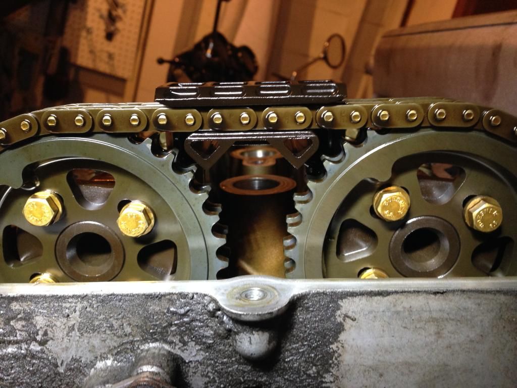

Cam sprockets look great! :)

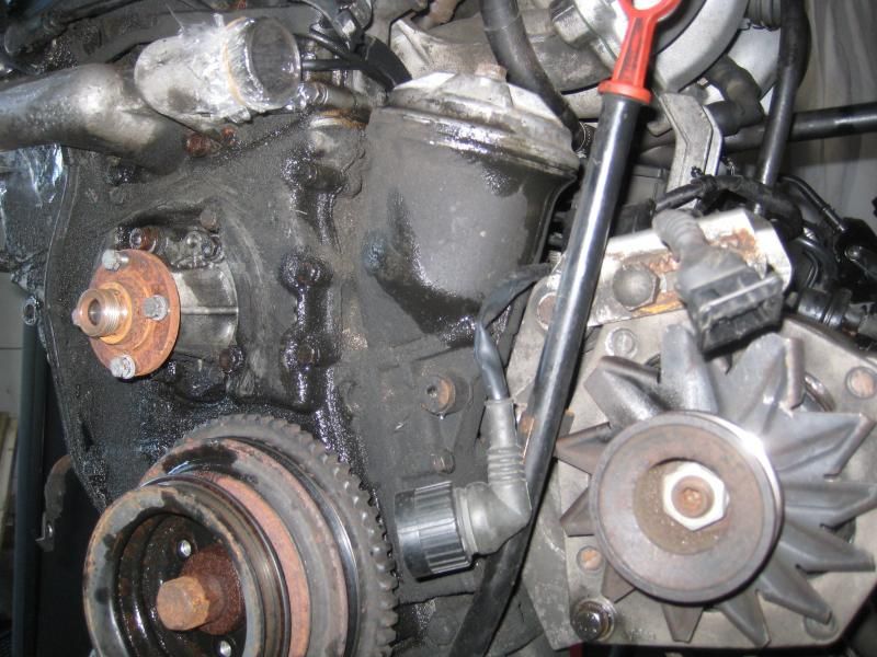

removed the waterpump today.  thought it was weird there was no paper gasket...once removed noticed the a pretty good chip on the rim surrounding the waterpump where the PO just tried to fill in with silicone gasket maker.
Now the question is how can I unbolt the crankcase to replace the timing cover with the engine on the stand? there is no flywheel I can use to stop the crankcase.   I only have hand tools btw

Spent some time cleanging my engine up.  I was all excited last Monday to get the crank holder tool.  Waited a week to get it so I can finally get the lower timing case off.  Turns out Pelican shipped me the wrong tool.  >:( I called them right away and then waited for 5 days, no response on what to do from them so I called them Friday.  Sent the tool back and another one should be on its way.  Hoping the same mistake doesnt happen twice.
after removing my thermostat, I got to see the profile gasket which looked like it was in decent shape.   :)  Guess I'll wont mess with it for now.
also what do you guys suggest is best way to clean then paint the engine block?  Seems like the more I wire brush and scrub the more rust comes off.
