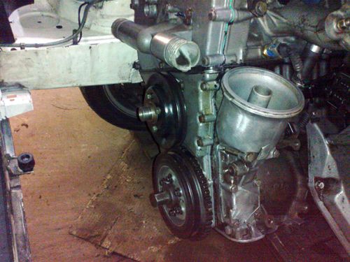

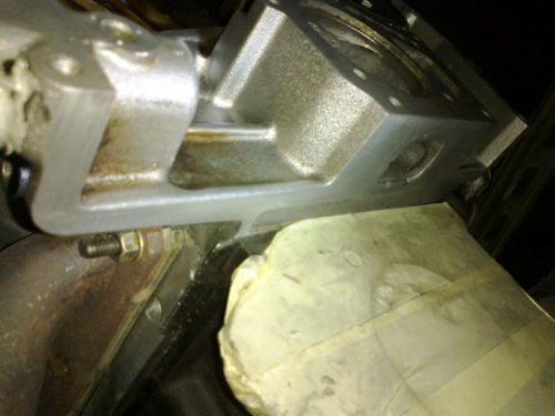

So I got some news. It is not the O-ring its the chain case itself.
F*cking hell this is the only seal I didn't replace because there
was already a new one installed.
now I've got to tear down the engine again. I am going to try to
replace the gasket without removing the head.
Jay
  • Posts: 26
  • E30 318is
Re: Jay's E30 316i Euro M42 Swap
« Reply #17 on: April 19, 2014, 12:05:24 PM »

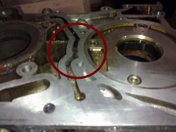

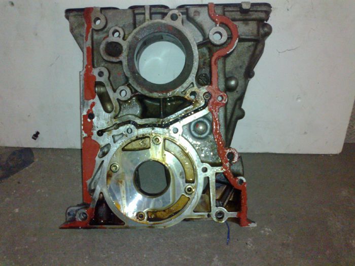

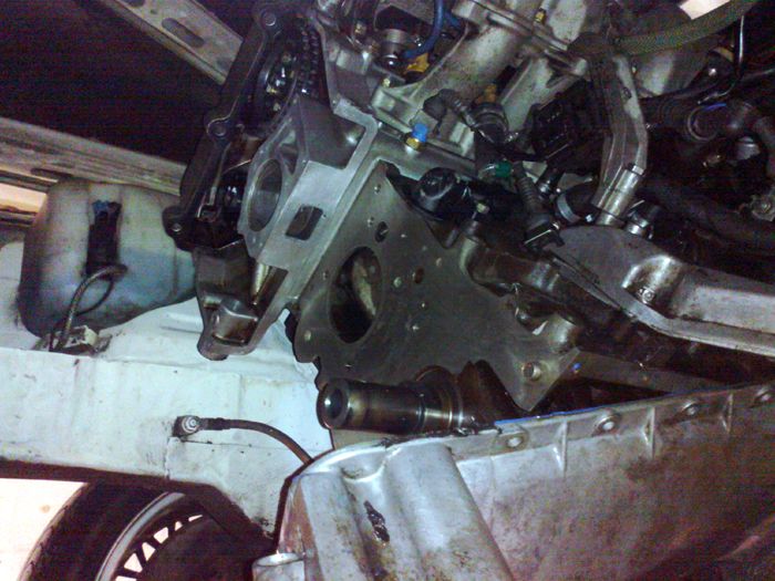

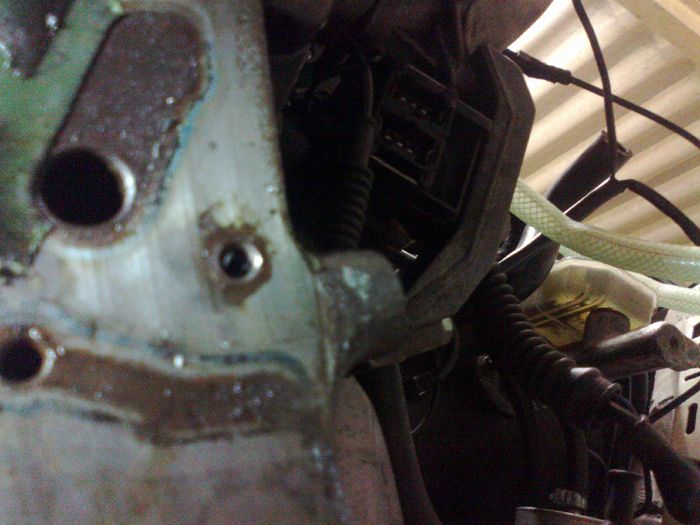

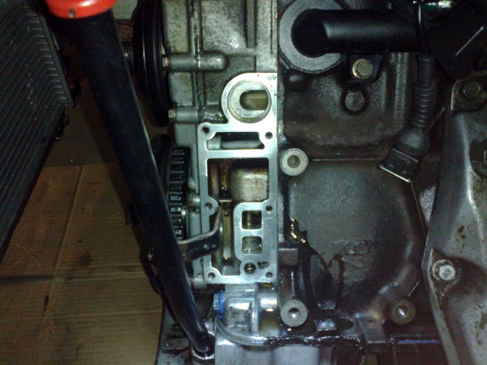

This
Was because of this
Thank god we have autofocus to make everything clear  :D
I guess there was a wrong gasket installed because when you look at the chain case
the oil line is more to the inside.
Wow some one sealed it up perfect for me.
Oil line was clogged.
The worst part of this issue is the endless cleaning. I was so happy that the upper oil pan
could not be removed this made everything much easier, and it is going to be a bitch to fit it
right again. Now I have to wait until the local BMW stealer gets the new parts  :P

I finely received the parts I needed. And so its time for the rebuild 2.0.
The rear timing case is a tight fit if U don't remove the head, but after sanding
the edges to a round shape the bastard finally fitted. Its still a struggle to put
the timing case in the right spot it clears the crankshaft nicely but then the profile
gasket gets ''stuck'' on the head, so in order to compress the gasket hammers were involved.
Then the case had to be moved up so I put a support strut beneath the case and lowered the car
down.
Today I've put the chain ect back in. the oil pan is next and then just some small parts to go.
I hope to have it running next week.

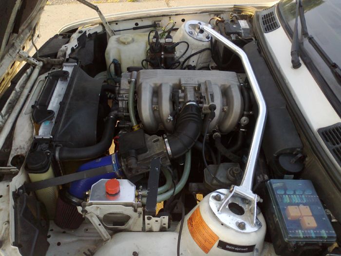

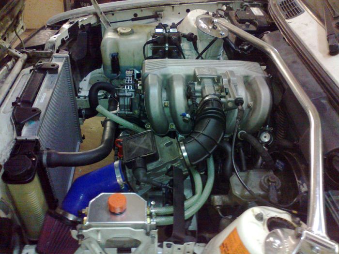

Everything is back in place, I just have to put a helicoil in the head and then the cover can go on.
Also found a strut brace somewhere in the garage so that's going to be installed.
an overview pic
Slowered318
  • -Receive: 9
  • Posts: 222
    • My '91 318is
« Reply #20 on: May 26, 2014, 08:29:15 PM »
Good work, it looks pretty toite. I hope you get it up and running without too many issues.
I have the same strut brace.. I don't think it does too much except look impressive.
Darky
  • -Receive: 23
  • Posts: 630
« Reply #21 on: May 27, 2014, 02:37:51 AM »
What's the aluminium tank for? Catch can.
Jay
  • Posts: 26
  • E30 318is
« Reply #22 on: May 28, 2014, 09:38:28 AM »
The aluminium strut brace doesn't just look cheap it also feels that way.
But since I have it laying around I might as well give it a try.
The tank is indeed a oil catch can.
« Reply #25 on: September 18, 2014, 01:46:35 PM »
Hi, why did you remove the airbox ? Whitout partition you will take all the hot air.
The original airbox has the benefits of flow ram air.
« Last Edit: September 18, 2014, 01:49:51 PM by Mimikrakra »

« Reply #26 on: October 18, 2014, 07:09:27 AM »
I would have installed the original airbox if I had one :P
And finding one was more complicated then an K&N filter

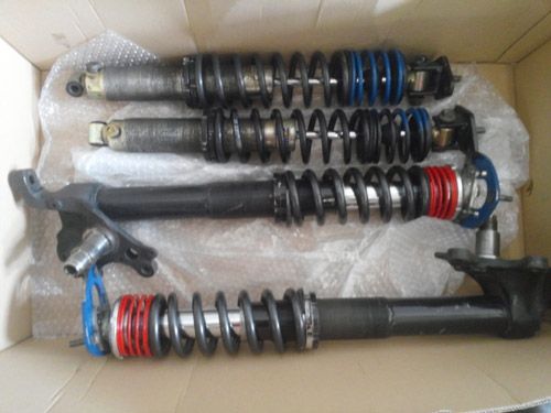

So the M42 runs perfect then I fitted a GAZ suspension set and it was time to do some laps of the nurburgring
in front of my buddy's 190  ;D
Great weekend but there are also lessons to learn. Don't fit M50 injectors, the computer cant keep up and you end up getting a poor
mpg and it stinks like petrol. And I have to get new tires because stock road tires bounce around. Time for semi slicks and a set of spacers.
I think half an inch would be perfect.

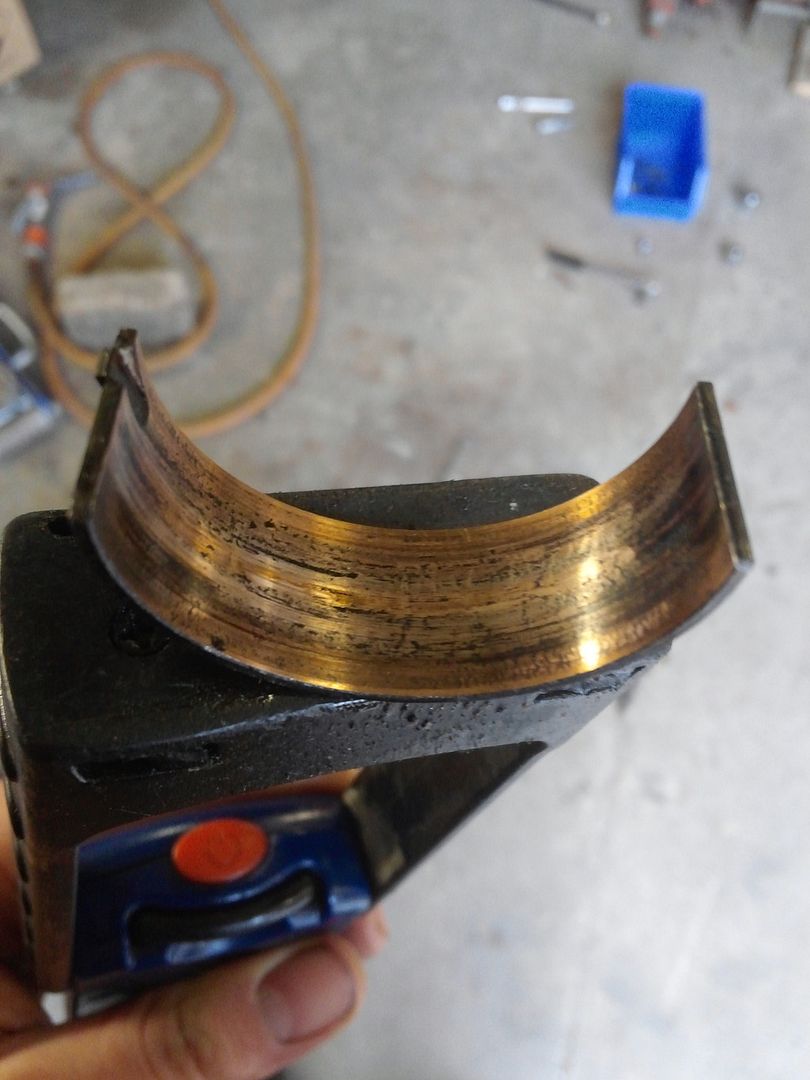

« Reply #29 on: May 13, 2016, 11:34:53 AM »
Since last year lots of things have changed, but the problems still continue.
last year I drove home from the Nürburgring witch is a long drive and since there
was no speed limit it was full speed ahead. At about 120 Mph / 200 kmh the engine stalled
I thought it was history but it started again. Later at home I found out that the camshaft sensor couldn't keep up.
so I swapped it and it worked. But then the engine made a rattle noise at 3000 RPM so I had to open it again.
since everything is new I had no idea where to look. Dropped the oil pan and found non metallic parts.
the crankshaft bearings where shot.
2000 miles old bearings, because of oil starvation from my camshaft sensor  >:(
