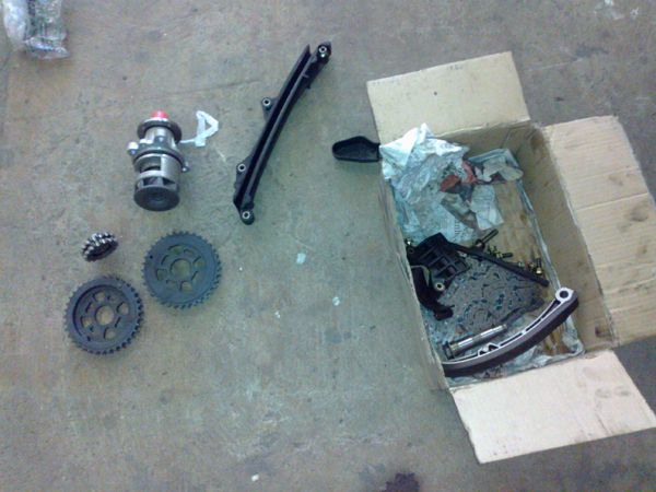

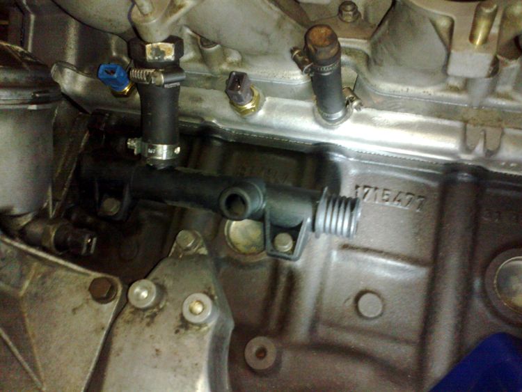

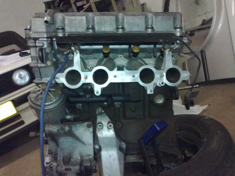

Luckily my buddy had an M42 that was planned for rebuild, but he never had the time for it. So it became my
engine.
This is how it arrived.

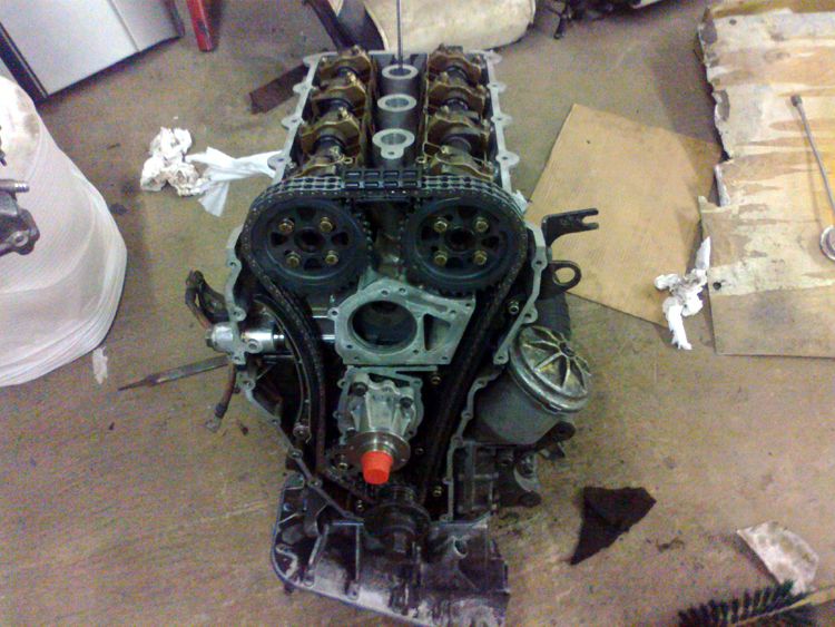

New chain, tensioners, sprockets, water pump ect. And boxes full of parts it was crazy sorting everything out.

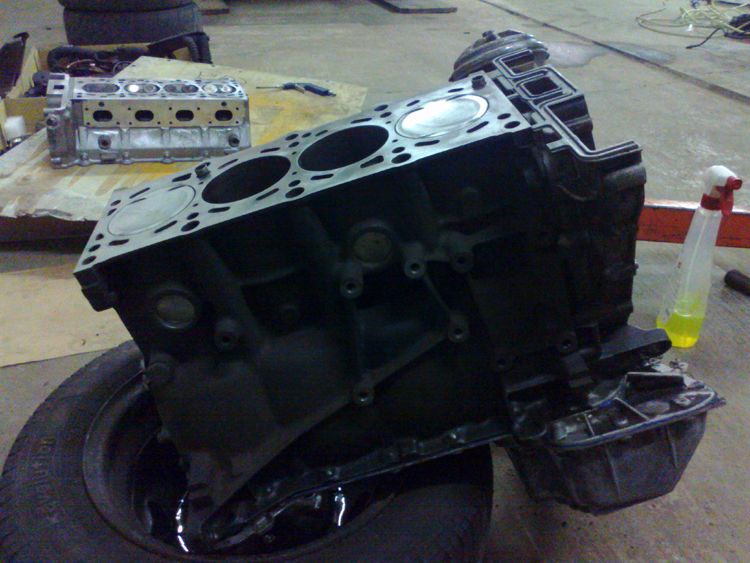

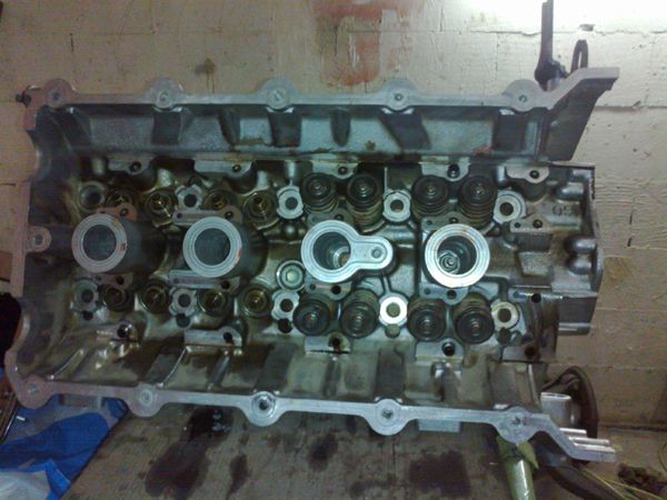

Started with the head. The engine had a timing issue, there were about 10 valves that were bent.
Brand new ones have been installed and I resurfaced the valve guides.
Installed the oil pan and cleaned the engine.

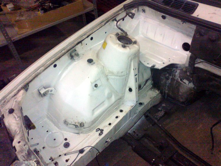

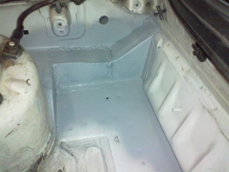

Thanks to this forum I removed the heater plate.
It is a really hard work to clean this years of dust and oil had to be removed.

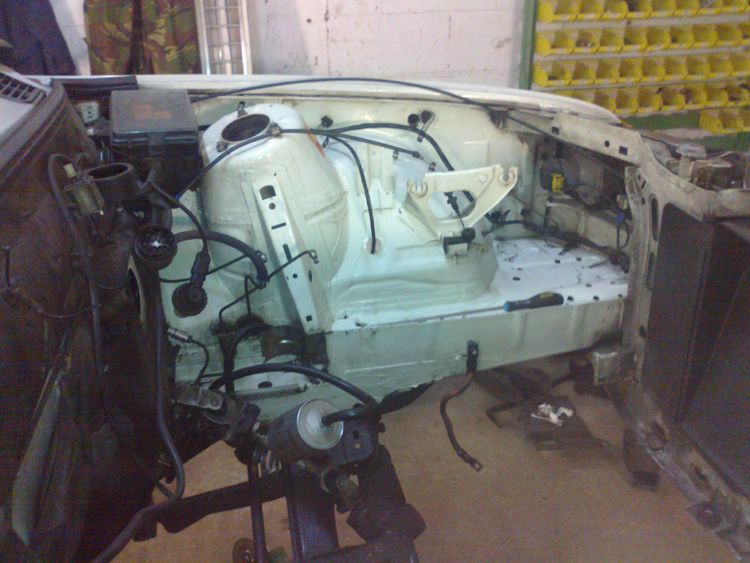

Time to remove the old M10. Runs great, was abused many times on the Nurburgring and never broke down.
My battery ventilation is gone now.

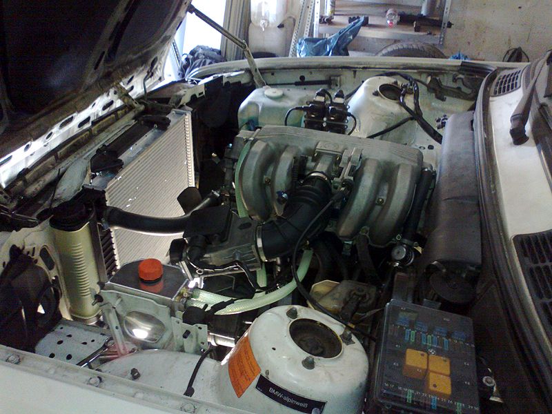

This is how it currently sits in the garage. I installed a big M50 radiator and a oil vapour separator.
After 10 attempts to get the coils in the right order the M42 fired for the first time and guess what?
It runs like crap. But that's why I registered.

What are your plans for the Air Intake/Filter with your oil separator living on the spot where it used to be?
Jay
  • Posts: 26
  • E30 318is
Re: Jay's E30 316i Euro M42 Swap
« Reply #3 on: March 14, 2014, 10:22:55 AM »
I just had to make a bigger bracket for the AFM. And I mounted a peace of tube with a 45 degree angle so the
K&N filter would fit nicely in the corner.

it's fixed finally. the vapour separator had a calculated vent in de cap, so I had a vacuum leak and the
AFM was faulty. runs great now but oil spilled from the filter housing so that's up next.
And the table is a great idea.

The oil catchtank, is that a QSP product?
the hoses that came with it looks like shit, add some pron with braided lines ;-)  totally overkill but it looks good :D
Jay
  • Posts: 26
  • E30 318is
« Reply #8 on: March 28, 2014, 11:06:29 AM »
That's what the al say here. But I kind of like the ''garden hoses'' because you can see what is happening,
and it looks ridicules.
