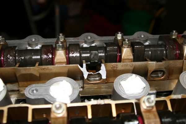

Well I suppose the good news is when I heard the snap it wasn't the cam.
I was installing the cam per Wayne's instructions.  I didn't notice that as the cam was being pulled down so was my Magilla Gorilla giant Crescent wrench head I was using to hold the sweet spot.  Why didn't I use my small one? :-(
Anyone have a cam tray they want to get rid of or any suggestions?  Leave it? JB Weld?
It's the exhaust side.

Re: Another M42 engine build
« Reply #50 on: November 18, 2013, 11:59:12 AM »
I would probably just leave it actually. The tray isn't doing a whole lot in that area.
Why aren't you holding the cams by the square section in the back?

« Reply #51 on: November 18, 2013, 01:39:51 PM »
Yep, you're right.  After I got it turned to the "sweet spot" I should have held it at the back.

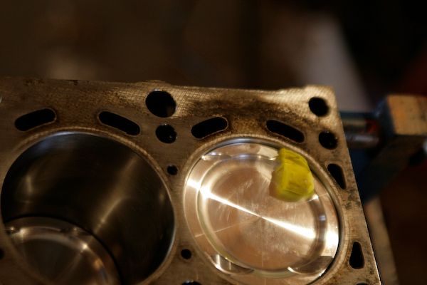

« Reply #53 on: November 19, 2013, 10:35:32 AM »
I guess this is why you check.  My assumption is if you can see the piston through the clay there's not enough clearance.  A quick word on clay, which probably everyone besides me already knows, get the stuff called plastisina. I did this twice because the first "modeling" clay I used was some kids stuff which had a bit of memory to it so it wouldn't hold the indentation well enough.  Plastisina is the ticket.

« Reply #55 on: November 19, 2013, 05:48:05 PM »
No valves are not oversize.  My understanding is Korman left the pockets stock on the exhaust side.  Their thought was you need the material there for heat transfer and you can run into trouble if you pocket the exhaust side.    Since I was so tight on exhaust I checked intake and had like 170 thousandths clearance!  Now, the piston valve reliefs are bigger but so are the valves.  When I started tearing things down  I went to turn the crank back 90 degrees to get the pistons to all drop but stopped before doing so.  I think I did the same thing on the exhaust side but didn't catch it and rotated the crank CCW 90 while still attached to the chain & cams.  I don't recall for sure.
I'm going to retest it tomorrow, I am betting rotating the crank and cam backwards messed up the clearances.

« Reply #59 on: November 20, 2013, 04:00:34 PM »
Here's the latest -
140 thousandths which is plenty.  I'm going to run down the procedure as it should be (probably other and maybe better ways but this is how I did it) and then I'll highlight my mistake for anyone that stumbles across this thread in the future.  If anything needs to be added or corrected please feel free to do so.
1)  With head off find top dead center make a reference mark on your crank.  Pistons in cylinders #1 & #4 will be up, #2 & #3 down.
2)  Put your clay over valve relief you're checking.  Make sure your piston top is clean.  You want the clay to stick.  Lightly oil your valve face so it doesn't stick. Valve spring of corresponding valve relief should have a light weight checker spring or lifter should be a solid lifter otherwise hydraulic lifter will be compressed and you'll get an incorrect reading.
3)  Rotate crank CCW 90 degrees and your pistons will drop so all four are at their lowest point this will prevent any inadvertent valve interference when mounting the head.
4) Throw on your old head gasket and mount your head.
5) Set your cams at top dead center.  Front lobes should be facing each other and pointed slightly up, flats in rear should be vertical and parallel  on Schrick.  Not sure about Cat-Cams and OEM is square as I recall.
6) Lock your cams in place using your preferred method.
7) Now you can safely turn your crank 90 degrees CW to your reference mark.
8) Install your timing chain, timing sprockets with arrows up, 15 rivets between arrows.
9) Turn your crank CW a few rotations
10) Remove your timing chain.
11) Rotate your crank CCW 90 degrees.
12) Remove your head.
13) Check your clay.
The first time I did this, when I thought I had clearance issues, I reversed steps 10 & 11.  That's a no -no.
