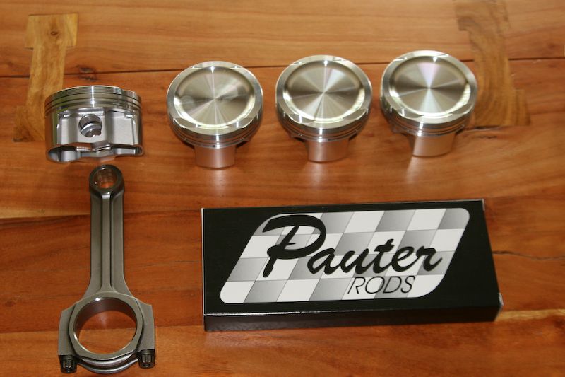

I am envious of your parts order! The Pauter rods are very nice! The pistons sound great too. Nothing wrong with leaving some more meat on the cylinder walls. Going too big a bore can cause problems with thin spots.

Crank order looks like it went through so I went ahead and got the pistons ordered.  I ordered pistons and rods from Steve at top end racing, nice guy .  Went with JE 85.0mm with 28.15 CH shooting for CR of 10.8/1.  I went 85mm bore to preserve future upgrade/maintenece options, I know the restraint was amazing :).  I went ahead and ordered new rods too, wazzu70's words seemed wise so upgraded those to Pauter 140mm.

I think the Pauter rods are awesome!! I spoke with Steve years ago about the pistons as well and we came up with 28.15mm for 140mm rods as well and he was ok with that.

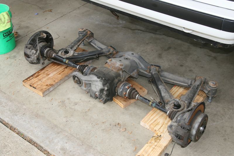

Sub frame is out.  Now the question is do I stick with the 4.10lsd or drop in the 4.27lsd?  I picked up the 4.27 a while back after we put in a luke box, sub and amp.  That stuff is heavy, but sounds so good.

« Reply #25 on: May 03, 2013, 10:38:57 AM »
For an atmo 1.8L I would say 4.27 without a doubt.
For your stroker build I would keep 4.10 since you will have more torque down low and its a street car. The higher gearing will be nice.
Swapping a differential is very easy. If you don't like the 4.10 you can step down to 4.27 or up to 3.73.

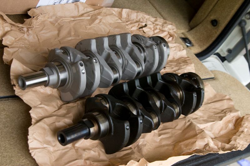

Picked up the M47 crank today.

Time for some updates.  Most of the month of May has been spent waiting for parts.  UPS brought these today  :)  I can get the pistons to the machine shop and they can get the block squared away.
The head is at Korman getting reworked. 8)  I know Warsteiner says just get in there and start porting but I know I would screw it up. :-[  I decided to go with Schrick 256/256 cams maybe low on the performance/$ value scale but one of the build goals is to keep it very streetable so mild it is.
A question, the decision to go with the Schricks came after the pistons were ordered.  Stock cams have a lift of 9.70mm, lift at TDC is .90mm intake and .65mm exhaust.  The shricks have 10.4mm lift and lift at TDC is 1.2mm intake and 1.2mm exhaust (if I'm reading their specs correctly).  Is there a way to calculate/measure if I need to have the valve reliefs increased in the piston tops before assembly or is the only way to do it by a test fitting?  Wish I would have had my ducks in a row before I ordered the pistons.  As always, your advice is appreciated.

Contact TEP and see if the valve reliefs are deeper than stock. Usually on aftermarket pistons they are.
I also believe the Schricks work with a factory motor, so you should be good either way. There is no replacement for actually measuring the clearance with some putty though!
Parts look beautiful.
