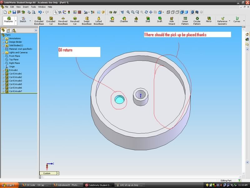

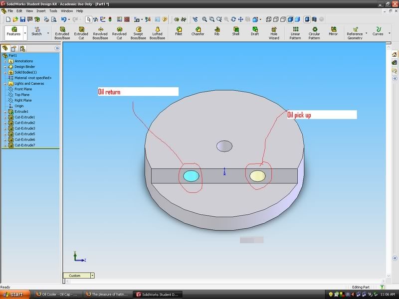

Thank you. What is the distance center to center of the main pick up and return? I see that the return line travels to the center of the cap, where does the pick up pick oil up?Thanks
here are the drawings, not sure where to put the pick up hole in the cap.
vatos_p
  • Posts: 132
Reply To Your Drawing
« Reply #8 on: June 06, 2007, 03:01:11 PM »
I Think You Can Understand Now...
I Did Not Think This My Self...i Copyied The Idea By Factory One And Victory... And Combined Them Together With A Very Talented Lathe Expert And I Got My Result...

« Reply #10 on: June 06, 2007, 11:26:43 PM »
I see oil is picked up from the center of the oil filter housing!!
