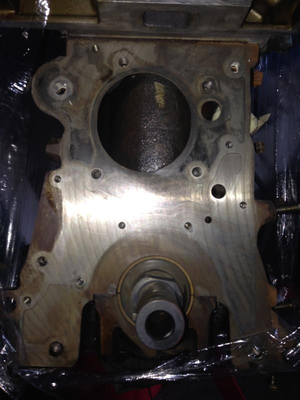

Heres where I'm at right now.  Just removed the lower timing case.
profile gasket was still pliable and intact...I had to replace the timing case for another reason.
mating surface of the profile gasket looks like its in good shape
cleaned up the block
I think I'll try the feeler gauges and see how it goes.  Will post updates as I go.
