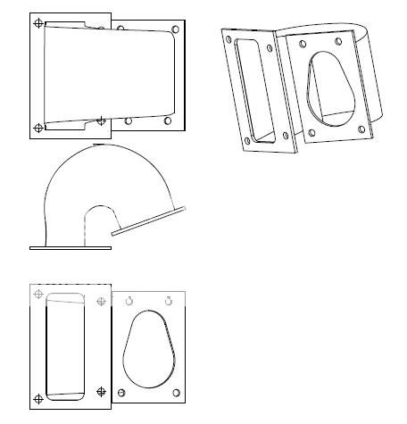

Since I wanted to keep it as simple as possible, I opted for the DASC sytle design
here's the build in pics...

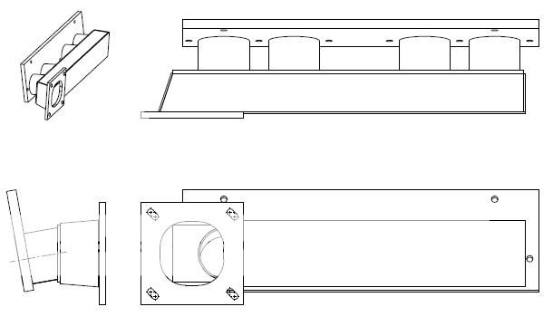

3D manifold
3D intake elbow

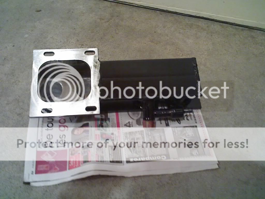

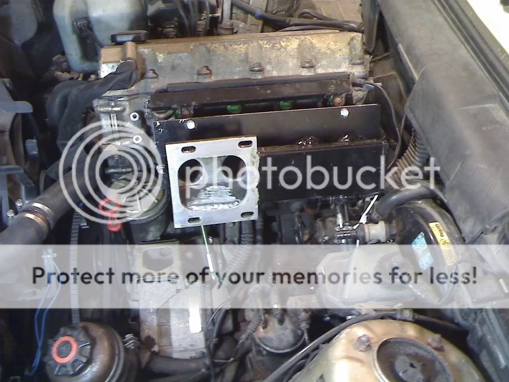

fabbed manifold

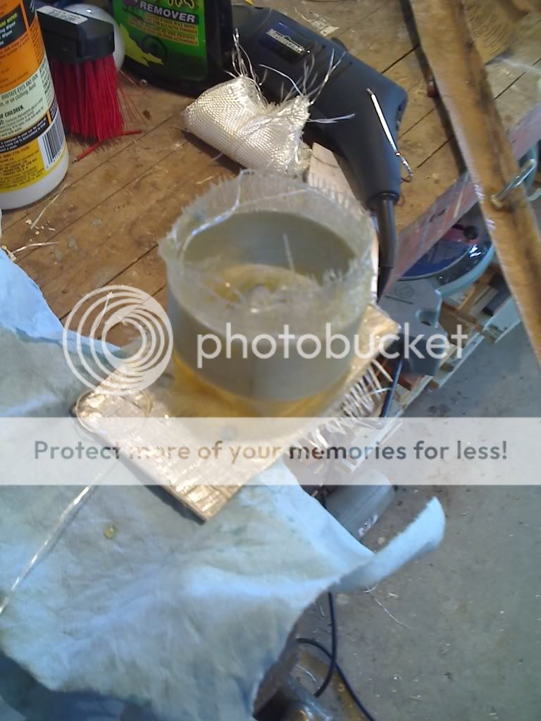

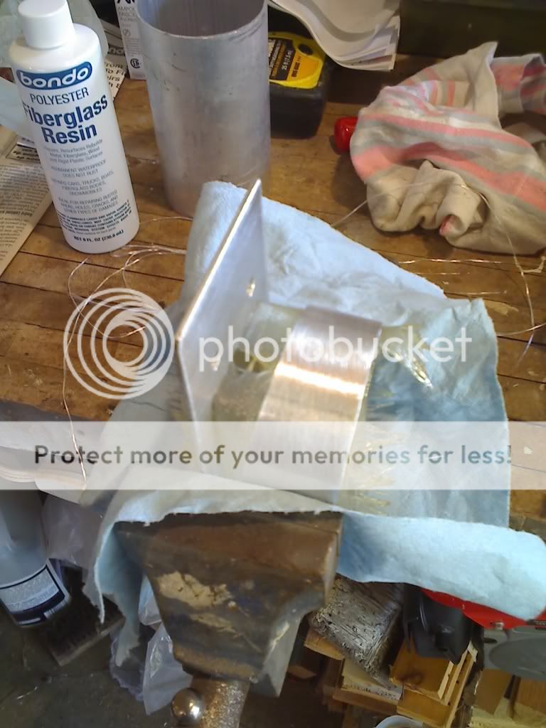

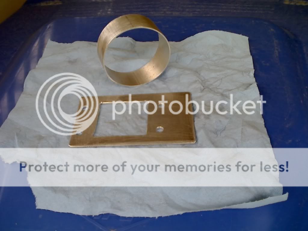

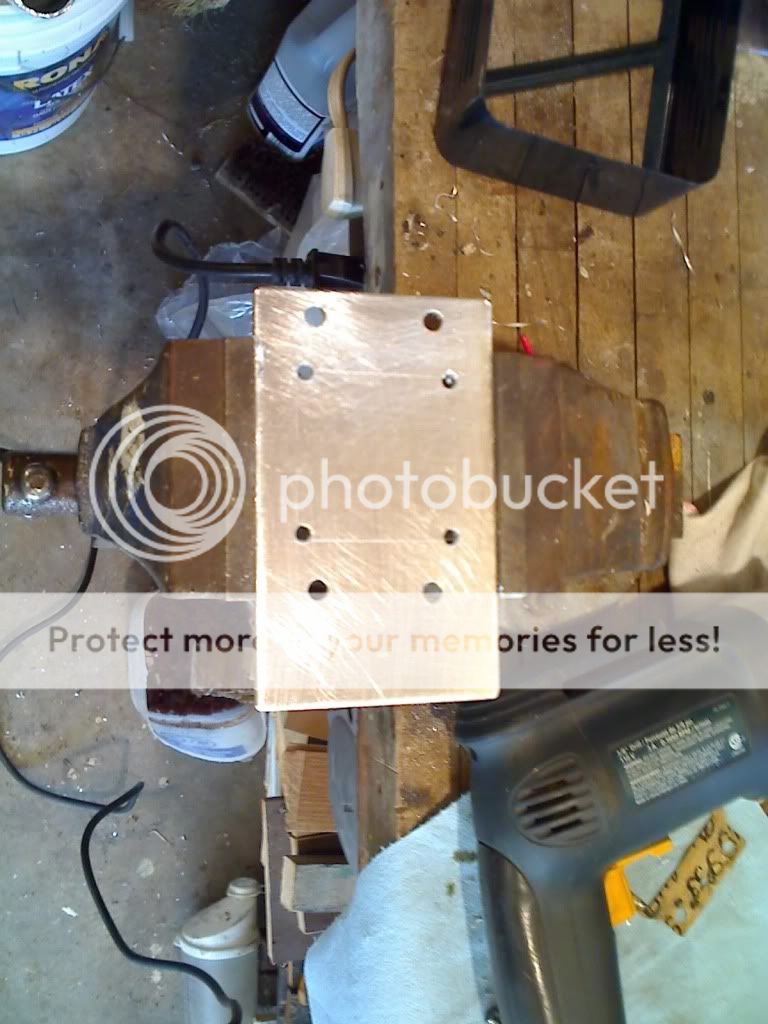

I didn't want to pay 150$ for a K&N filter with the bracket adapter and wait for the part to arrive in I don't know how long, so I made my own 3" filter bracket for the AFM...
3" aluminum pipe and 1/8" AL plate
Find hole locations and then cut
Fibreglass the peices together through the interior and then once it's dry apply 2 layers on the outside
Then trim and paint!  no picture of part alone...

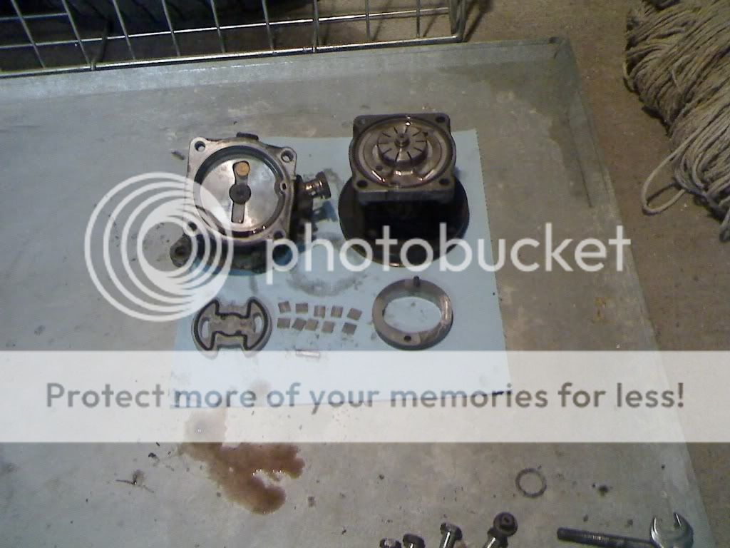

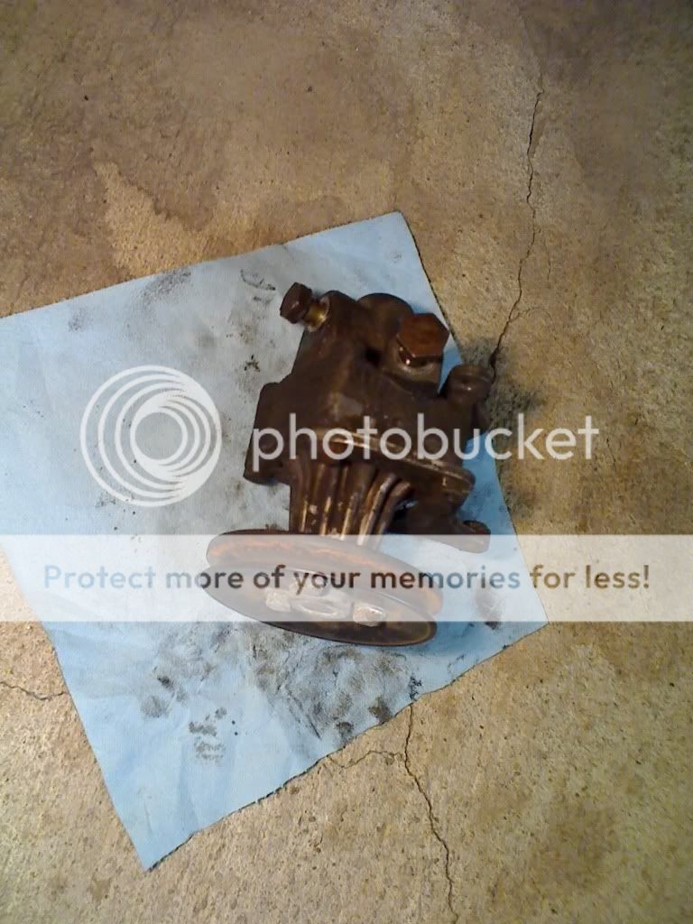

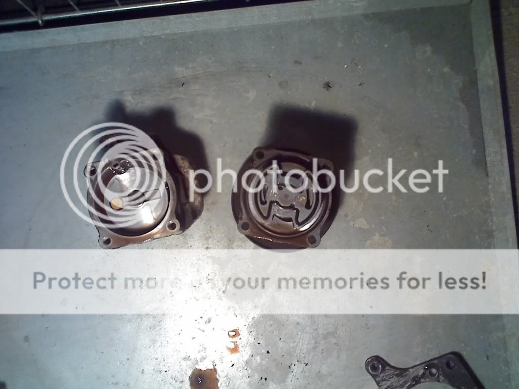

To keep it simple, I used the power steering pump as the tensioner, but before I dissabled the pump as not to move extra fluid around.
P/S pump apart

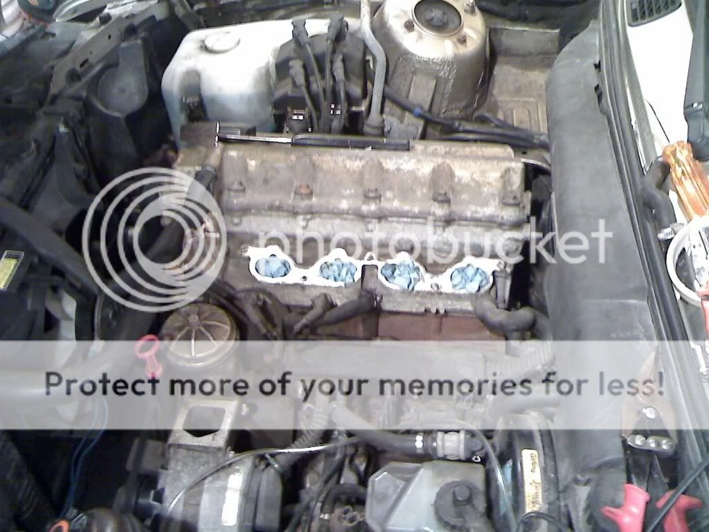

Onto the building part!
a common sight to most of you...

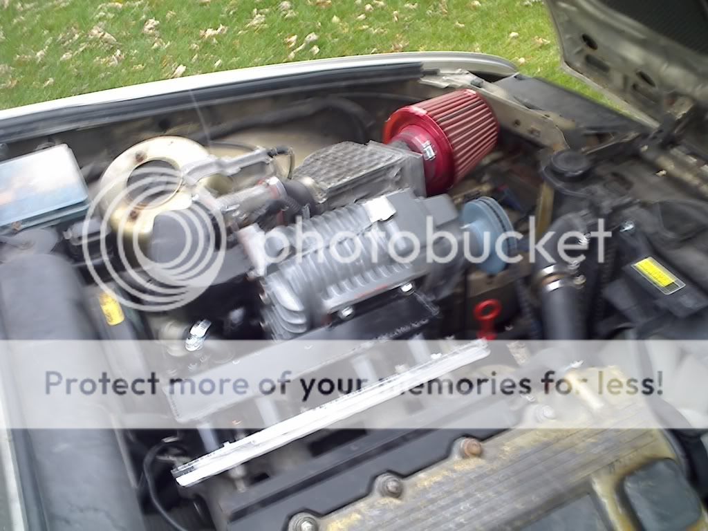

Manifold on!
Blower on!

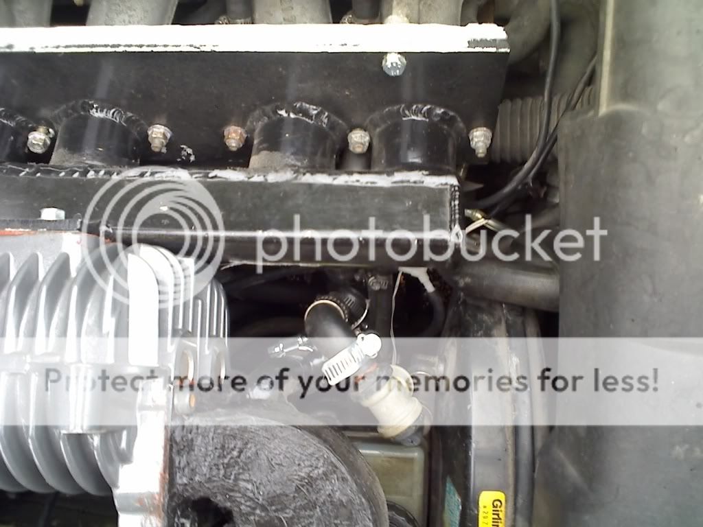

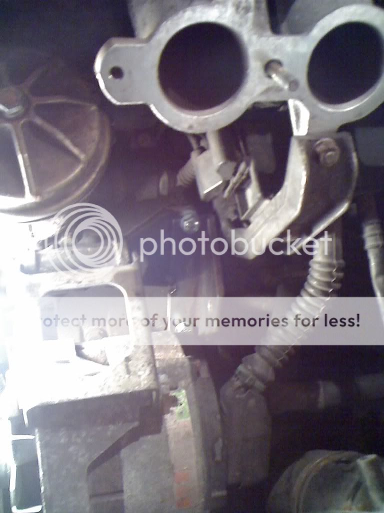

In order to keep it clean looking, and also for space reasons, I tucked all the piping under the manifold and elbow, in the large hole right beside the starter
Rest of the intake on!
