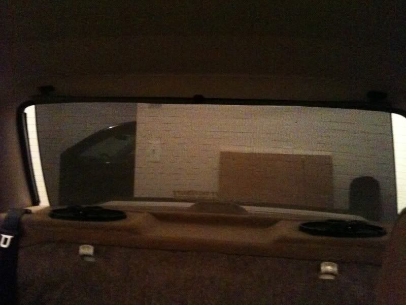

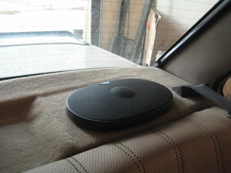

some pics of my 6x9 pods.
I cut out the speaker surround with MDF, then put some washers until it was level with the rear panel.  Bolted down.  Then had it covered. You can do the same thing for $40 or less.  Just spend some time on it and be creative.  Doesnt require a professional.
