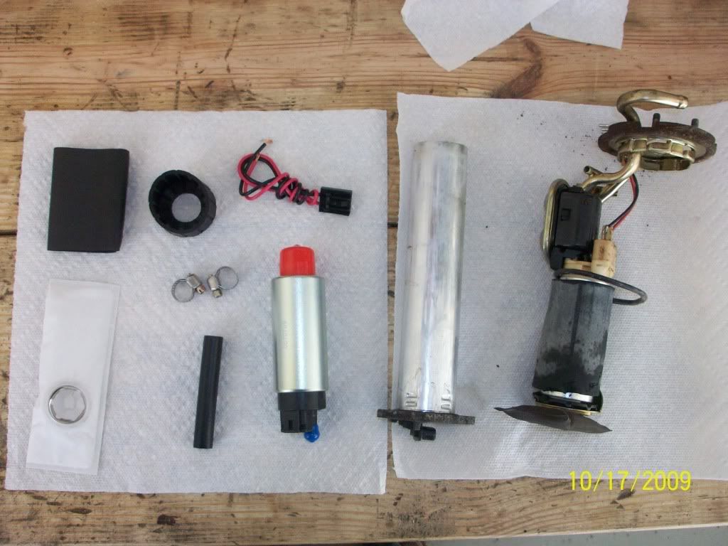

1991 318is Fuel Pump Replacement. This DIY is based on the in tank fuel pump.
Tools Required for job:
Phillips Screwdriver
Flat Head Screwdriver
8mm Socket and driver
Dremel or die grinder
Soldering gun and wire
Nitrile or Latex gloves
Replacement fuel pump is the TRE 340. http://www.treperformance.com/FuelPumps/TRE255FuelPumps.html#340
Step 1:

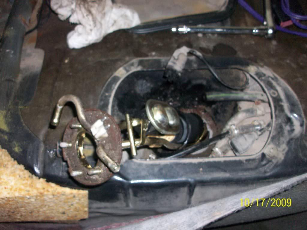

Locate your fuel pump. Remove your rear seat. Under the seat/insulation you will find a panel with four phillips screws. Remove these screws to reveal your fuel pump assembly.
Step 2:
Remove the four  nuts on the VDO fuel guage sender and pull the fuel sender out.
Step 3:

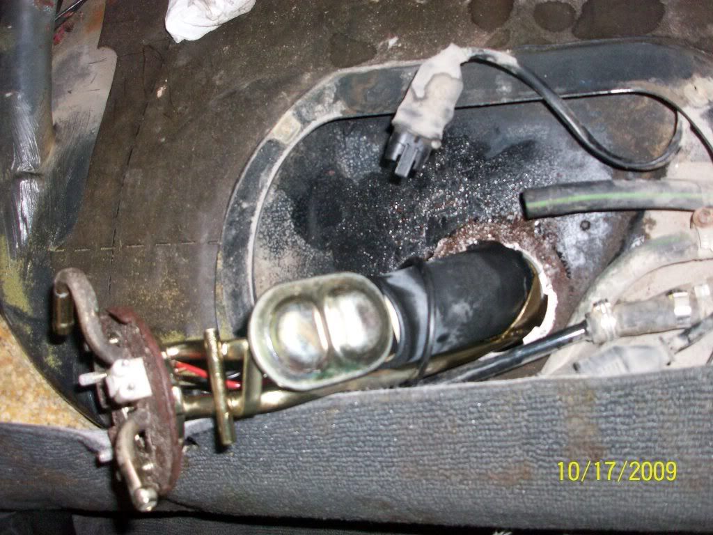

Turn the fuel pump assembly then pull out. This may require some "tweaking" to pull out.

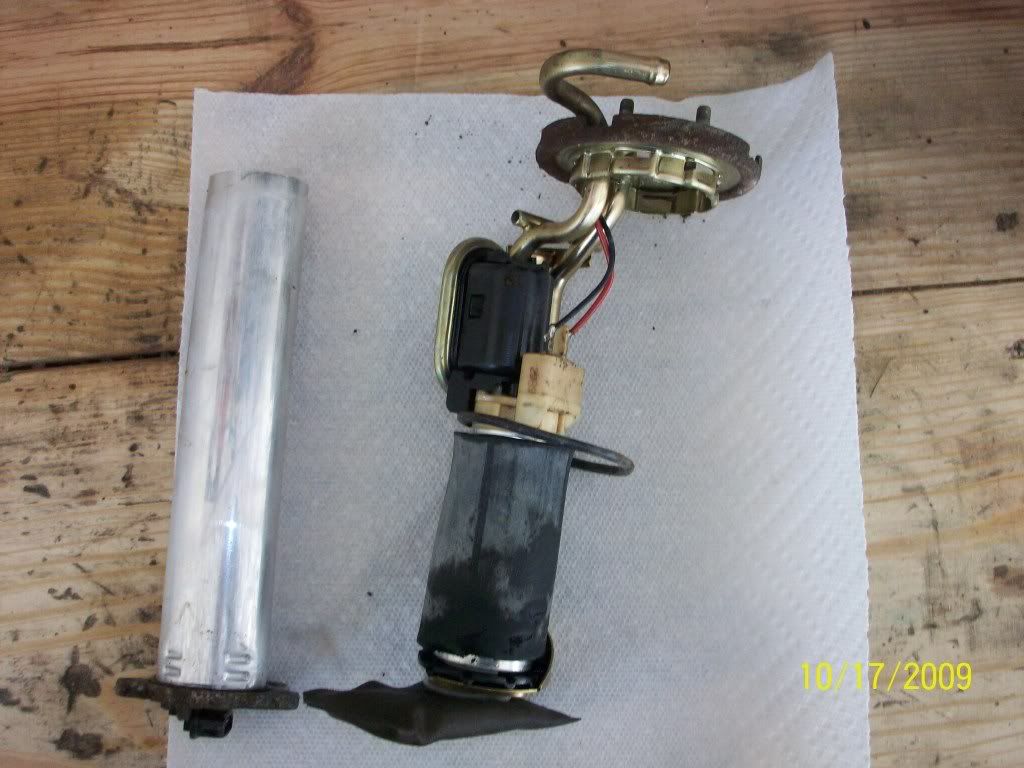

Step 4:

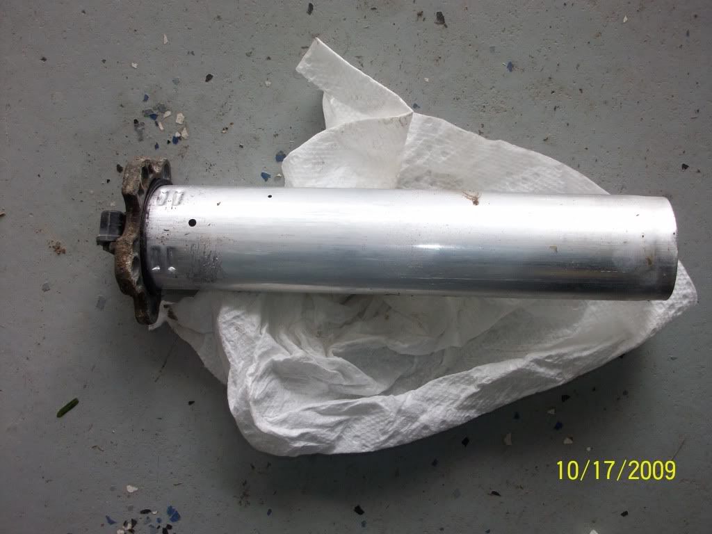

Remove the old fuel pump.

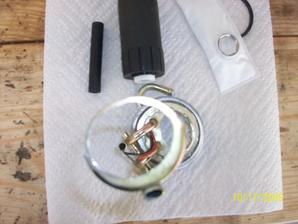

Step 5:
Use your dremel or die grinder and grind the lower section of the fuel pump housing to fit the fuel pump for the new TRE 340.
Step 6:
Fit the new TRE 340 fuel pump into the housing, cut the supplied fuel hose to fit the space between the pump and housing. Zip tie the pump to the housing. Do not forget to attach the filter to the pump!

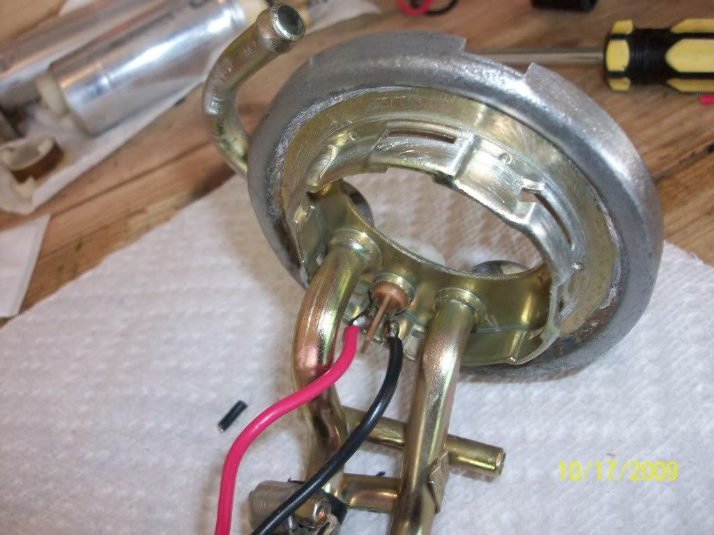

Step 7:
Solder the new fuel pump wire to the existing fuel pump housing plug.
Step 8:
Reassemble the fuel pump into the tank.

jrw21, your writeup inspired, originally I posted this one without comments, only pictures, but other e30 people finally convinced me to add some captions.
But cheers! I hope this provides useful to others, i know yours did to me
NOTE: Submersible fuel line should be used if you question the supplied fuel line (submersible line truely is much tougher and more difficult to cut than the line that is provided with the pump.)
Quote
Fuel Pump DIY for $80 - Install in Pictures
Car: 1991 318i 4-door - my current "Lazarus" e30 project, M42. All later e30s with the single in-tank fuel pump would follow the same procedure. Don't cross wires or leave exposed wires within arching distances. I take no responsibility for your actions, this is mere documentation of the process that I performed on one of my own cars. I have used a Walbro HP255LPH before external and internal and have been very pleased with them, for this one however, i decided to try out the TRE340 unit, slightly less expensive than the Walbro, both are obviously superior to the OEM unit when you compare flow charts. I love the Walbros and am looking forward to seeing how well this TRE performs in comparison.
What is needed:
8mm wrench or socket
Set of screwdrivers
Wire cutters
Wire Strippers
Soldering iron/gun, Solder & basic skills
Dremel or mini grinder & basic skills
$80
Quote
~ 2 inches of submersible fuel line - check with your local marine motorsports shop, according to a couple other members, if you have to resort to getting it from an autoparts store such as NAPA, they sell it in 1-foot lengths for ~$20 a pop.
2 hours, probably less.
The rear seat of most e30s simply "pops" up, grab and lift, install is reverse.
Using a screw driver for leverage as shown, rotate the pump assembly counter-clockwise.
Pay attention to the manner in which you must move the pump to remove from the tank, this will speed the process of re-install.
Make note of positive and negative terminal positions, do not cross your wires while soldering.
LeanE30
  • Posts: 12
DIY Fuel Pump Replacement
« Reply #9 on: February 06, 2010, 05:28:19 PM »
Part#2
Quote
Do not use the supplied fuel line. the supplied line is not designed to be submersed in fuel and is for external applications, such as on early high-arch e30s with the external main and in-tank supply.
The following picture displays the area from the base of the pump which must be removed so that the pump may seat low enough for the pick-up sock filter to attach.
...Bet you were thinking that my grinding job looked butchered huh? ;)
Any Questions?
