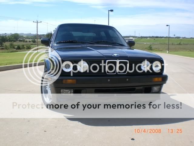

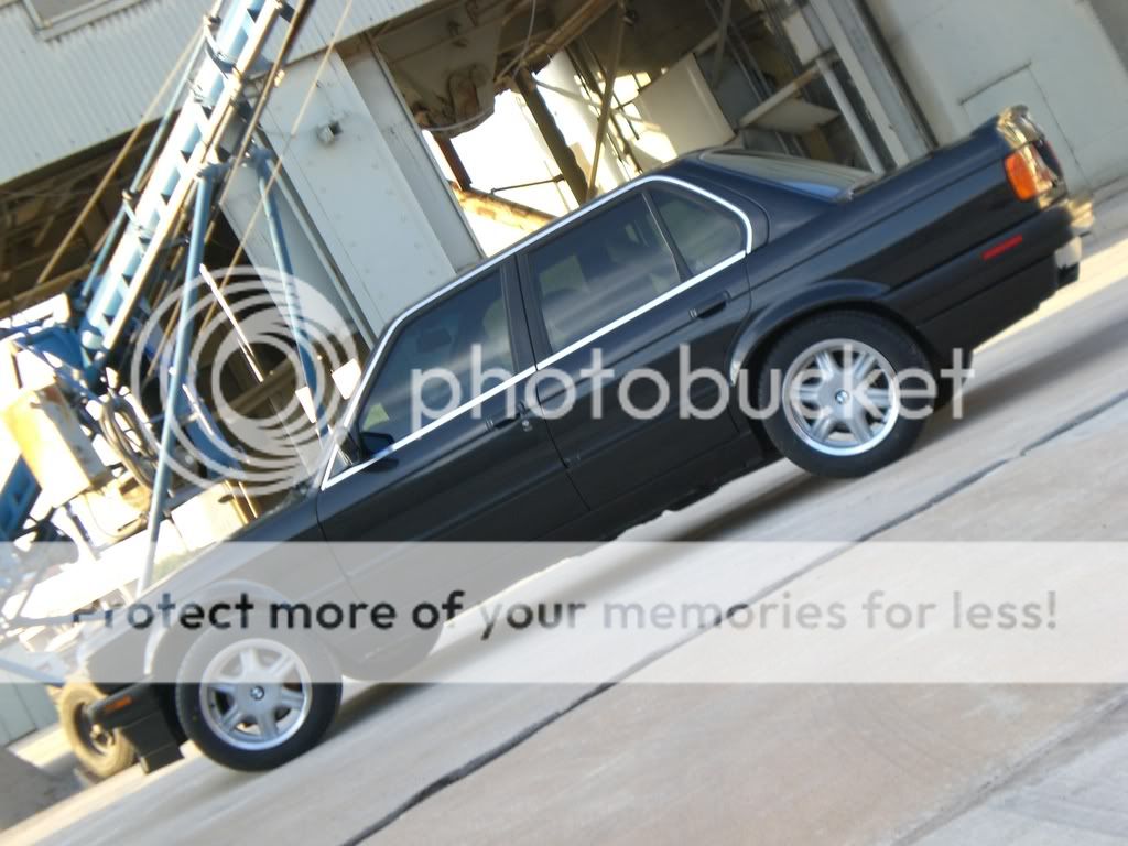

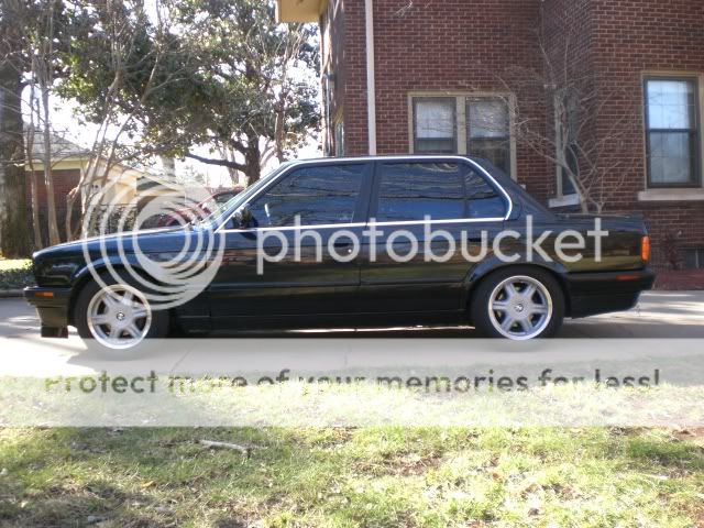

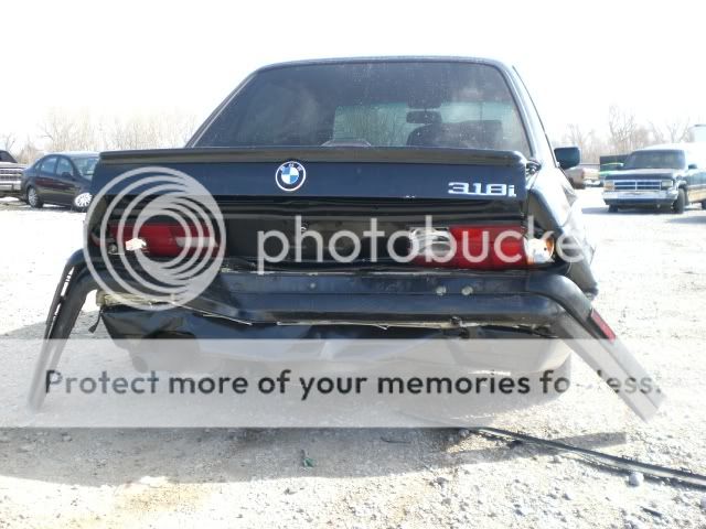

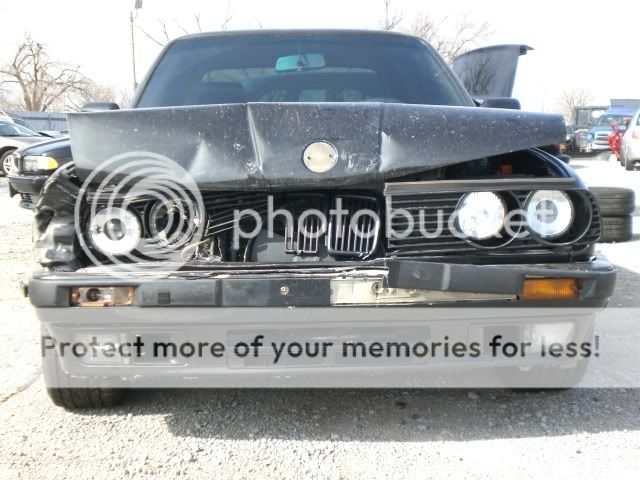

1st off, thanks for having this forum.  It has been invaluable for me as I tried to restore my e30 (91 318i).  Probably my 4th BMW but my favorite.  A couple of weeks ago someone rear ended me (too busy talking on the cell phone) and totaled my car :mad: .  Did I mention that she had NO insurance? :mad: I walked away (so did my kids) :).  I tell you what, even for a '91, that little e30 can take a heck of a punch!!!!!
I pulled the armrest (sold), IS lip, glove box lock, speakers and wheels.  I am not a mechanic so I cant do too much but I would like to know what other things are easy take off's that may be of value (before I turn the car over to the yard for "storge expenses").
Thanks.
BTW before and after for your viewing pleasure/pain.

The front valance still looks ok (remove bumper by undoing 2 star hex bolts in the middlish), boot looks ok. Foglights.
Doors, glass (knife), interior (carpets inc. All you need to remove seats is a 17mm socket and bar), steering wheel (22mm socket), stereo? Engine, driveline (prop, gearbox, diff, driveshafts all easy IMO, but then I've got the tools!).
Front shocks (balljoint breaker, 3mm socket/spanner 17mm socket, 19mm socket), rear shocks (13mm and 19mm), rear springs. Calipers? Can be useful...
And lastly, fuel tank!
Yeah, everything is relatively easy mate!
