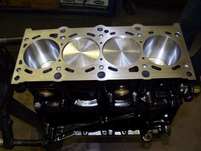

So there's enough material in between cylinders to bore it out to 86mm huh?  It's likely pushing it though.  I'd love to see pics of the block.

The M42 has the same bore pitch as the M/S50 engines.  Some of those guys go bigger but I would not go too big on the cylinder diameter for FI.  High compression NA I think goes to 87.5mm.

« Reply #11 on: March 14, 2009, 12:32:01 PM »
Quote from: szed03;68218
here ya go... its metric's M44 2.0L I just bought.

szed03
  • Posts: 88
Custom M42 Pistons for my Engine
« Reply #12 on: March 14, 2009, 09:27:28 PM »
Awesome!  Thank you mucho rob and marko! :D  Time for me to get a spare M44...and space to store it. :p  LOL

Quote from: marko;68290
more here...
http://www.318ti.org/forum/showthread.php?t=25646
Sorrry if this is otherwise obvious, but what diameter are those pistons?

« Reply #14 on: March 16, 2009, 07:39:47 AM »
not even obvious to me & I own the damn thing.. LOL :)
they are 87mm...
