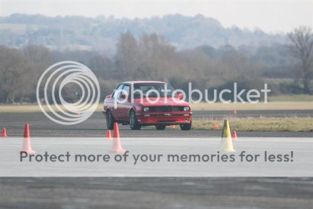

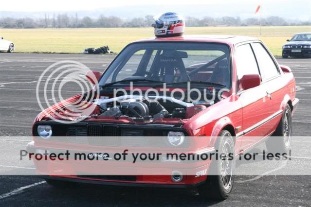

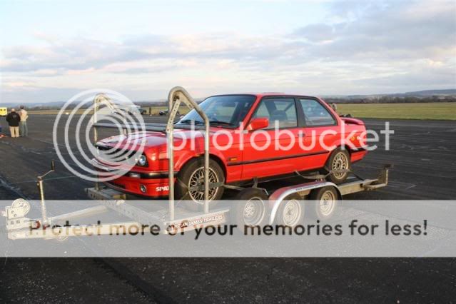

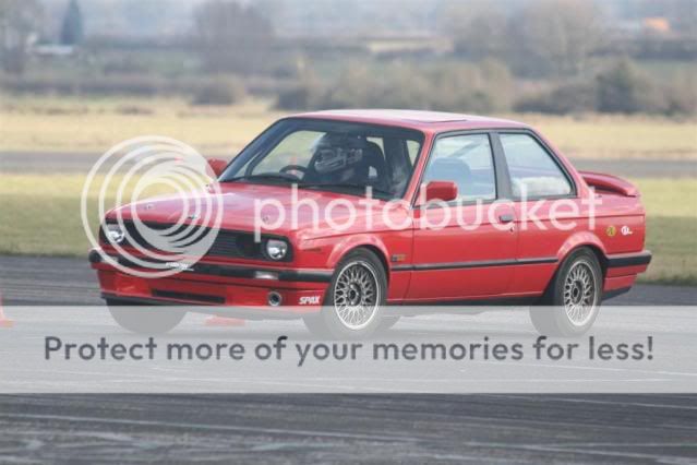

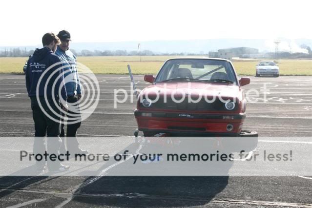

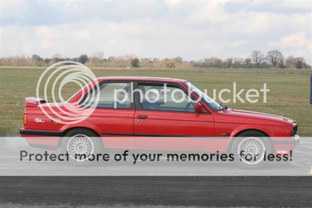

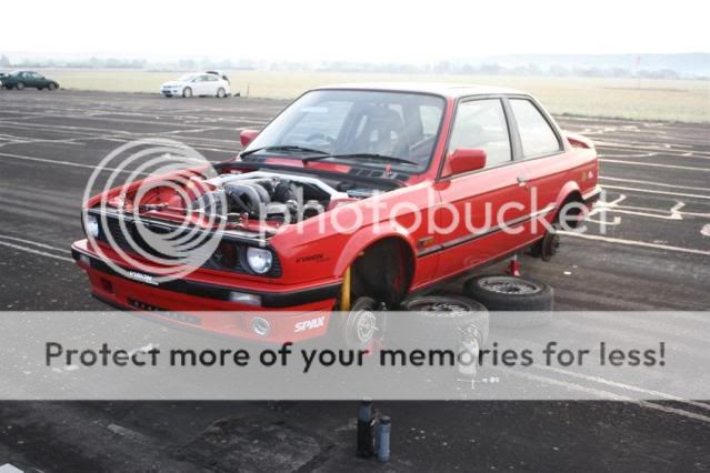

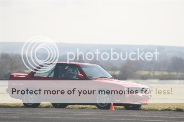

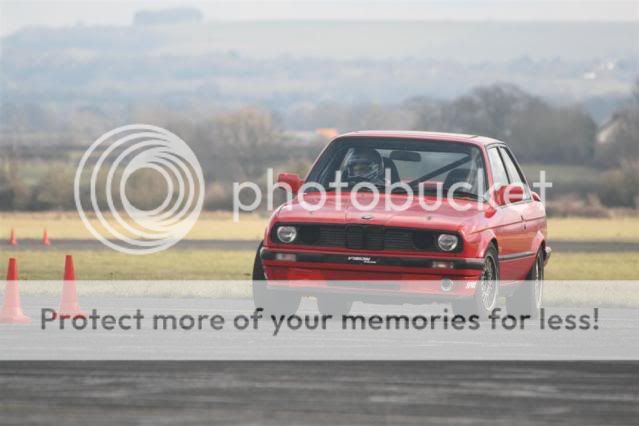

Well first mile stone reached with the project :) I  finaly drove the thing and completed a track day!  :D (only took me 4 years  :mad: ) I sorted out the smokey Joe zaust with a dose of K-seal worked a treat.
The car did really well, I did about 75miles on 20L of fuel. Got the brakes bled up first thing and then spent abit of time just bedding them in. Was a little worried about how loud my exhaust was going to be but was only 88db.
The only problem I had all day was a slight issue with a leaky steering rack seal and a small drip from the engine some where but nothing like a day ruiner!
Any way, piccys  8)
