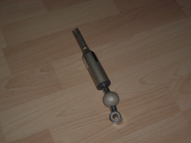

I just installed a Z4 2.5L shifter. In a side by side comparison with the stock 318is shifter, the Z4 shifter doesn't look that much shorter. The top portion is probably less than an inch shorter, while the lower portion was slightly shorter. After installation, the Z4 shifter, again, looked slight shorter but the throws were definitely shorter but slightly more notchy than the original.
I was hoping for a much shorter length as depicted in the pictures. Anyone share the same thoughts?

Took delivery yesterday of this little baby :D
When I fit it I will get pics up of the 2 side by side
