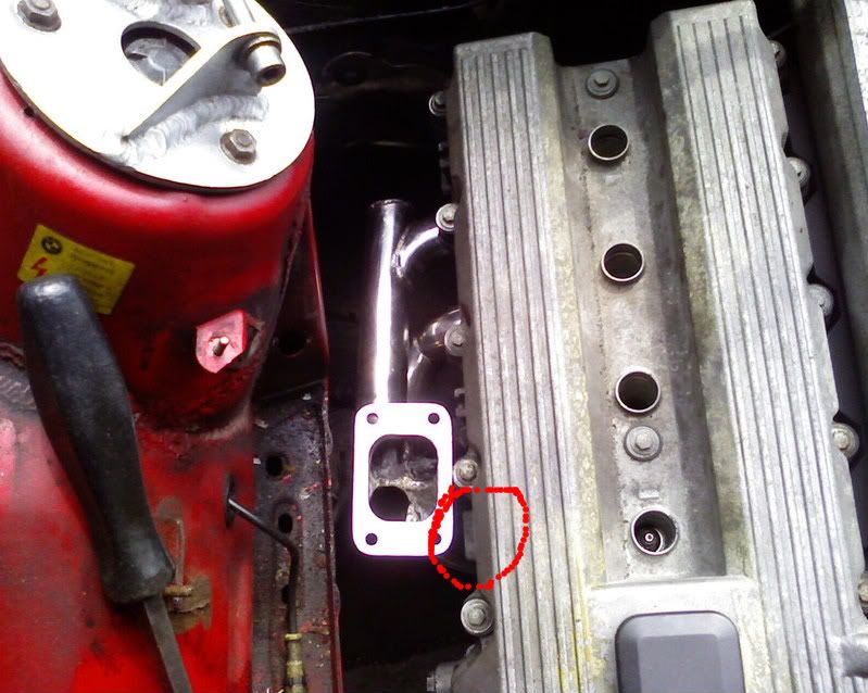

« Reply #41 on: November 24, 2008, 03:56:11 PM »
Keep us posted with your progress and any issues you run into. Im interested in doing something similar. Do you have any pics of where the turbo was hitting?
Danny707
  • Posts: 434
Ultimate budget build.
« Reply #42 on: November 24, 2008, 04:04:39 PM »
Right there.

« Reply #44 on: November 24, 2008, 11:01:39 PM »
Quote from: Danny707;61614
Right there.
loooking good!~
